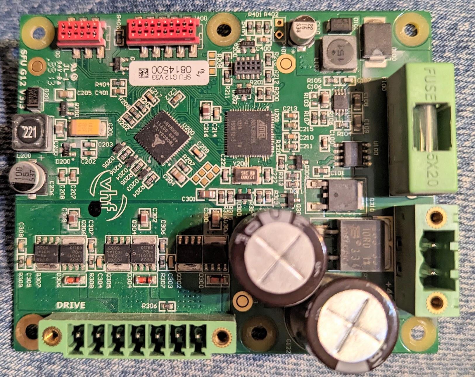

That seems to be the spindle drive, 3 phase, wired in "star" formation.
Take a lot of pictures, upload those here on the forum, a consistent album of wiring would be very useful.
Motor seems a normal 3 phase one, what else goes back to the board from the motor?

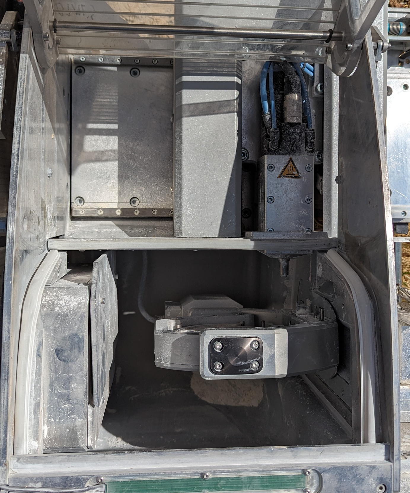

From what i gathered through all the dust, it was a min 5 axis dental machine, has the "plate holder", use materials like titanium, zirconium, and some other stuff that are disk shaped, have NFC or RFID embedded and the machine keeps track of what has already been used, very costly, spindles are usually 50 to 60 KRPM, small tools also expensive, etc.
Fixed several of those, they are also very heavy.
I also have a full PC with PCI controller in it for one of those, probably Italian made, although the machine was bought in 2009 new.

You're correct for the most part - this one doesn't use RFID but everything else was spot on. This one uses USB or Ethernet and a program called DentalCNC to send g-code.
The motor is 5k-60krpm, 300w continuous or 600w peak with a 3mm air chuck.
Spindle is plumbed for a mister, has air seals and a "taper purge" as well as the chuck control line.

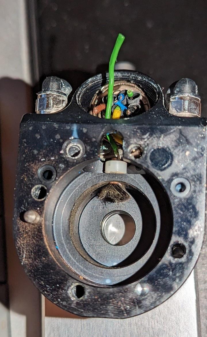

There's a seven wire connection to the motor control board in the photo. I presume that's ground, 3 phase wires and 3 Hall effect sensor wires. I did find a how-to for mapping the phase-sensor relationships & will try that tomorrow.

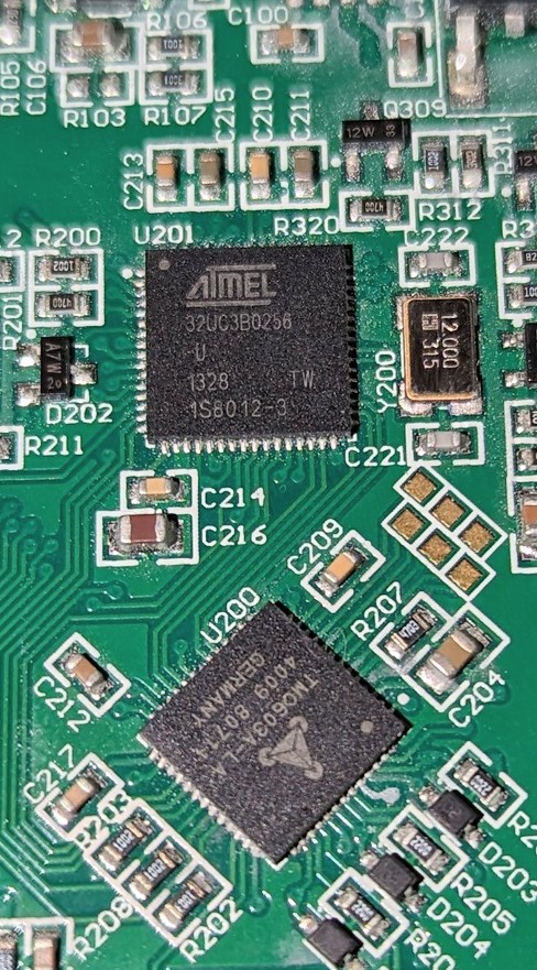

The motor control board has a pretty robust Atmel MCU and a BLDC controller IC, but I suspect that without the factory software I'll be replacing it with a documented BLDC control board

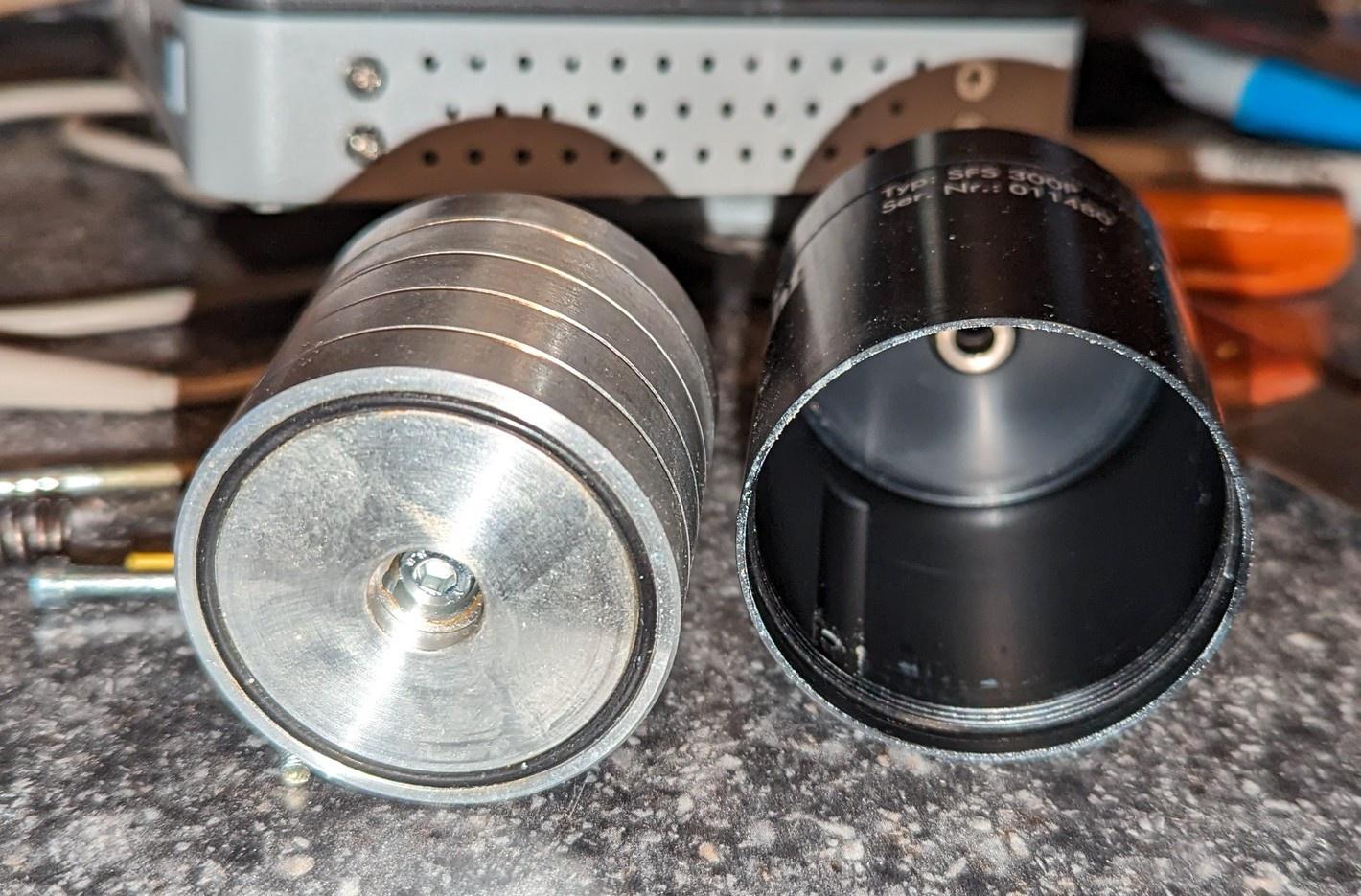

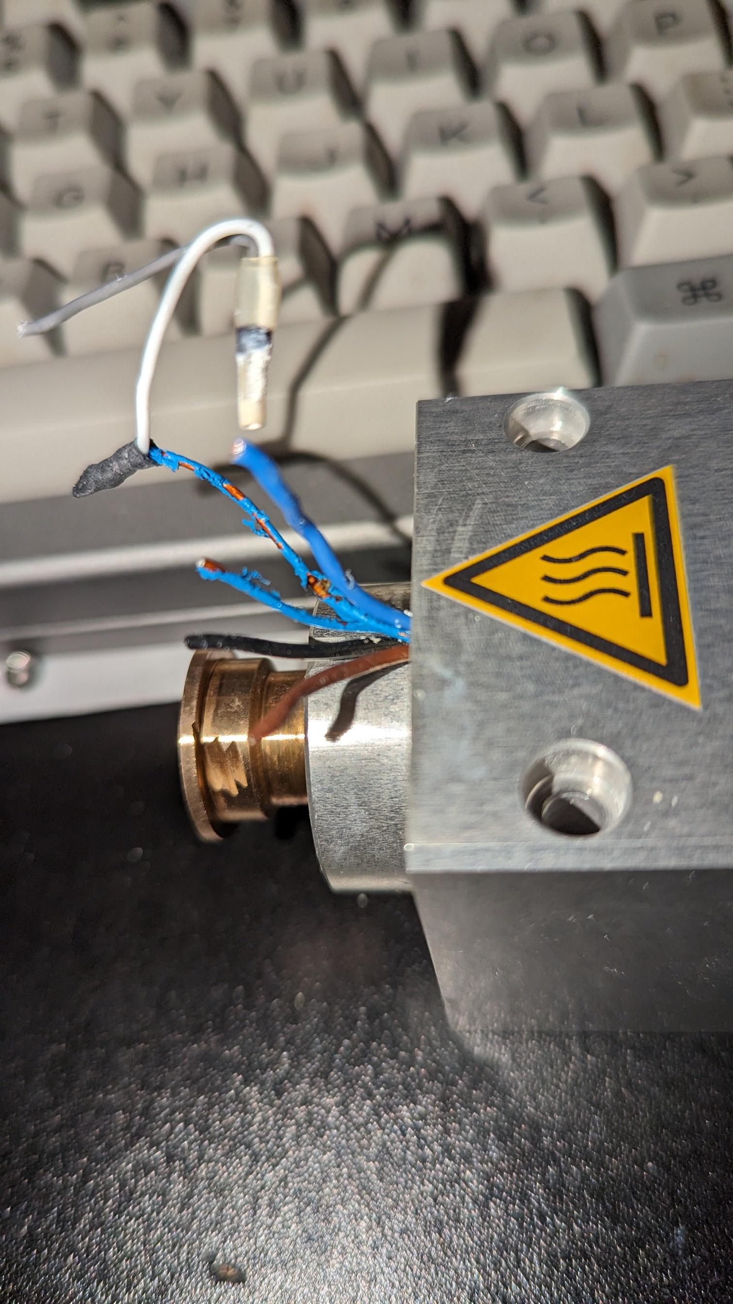

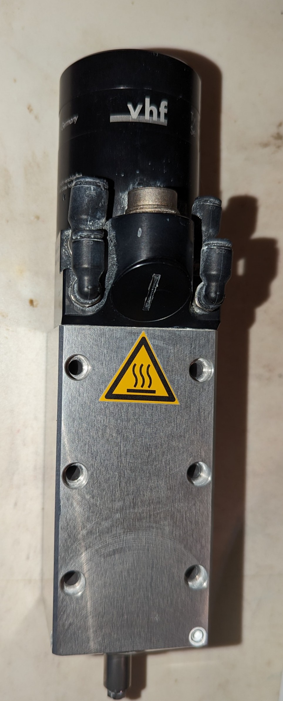

Well, I tried to do some further work while tired and distracted, and smoked something in the spindle. I had hoped to avoid tearing it down and was trying to map the phases and sensors, and put 24VDC where it didn't belong.
Oscilloscope shows a nice sinusoidal back emf if I drive the motor externally, and the wiring indicates no Hall effect sensors, so I'm not sure how to drive the thing. Will a simple sensorless (back-emf controlled) BLDC circuit work?
The sensor in the second photo rides on the "dremeled" collar in the first photo
