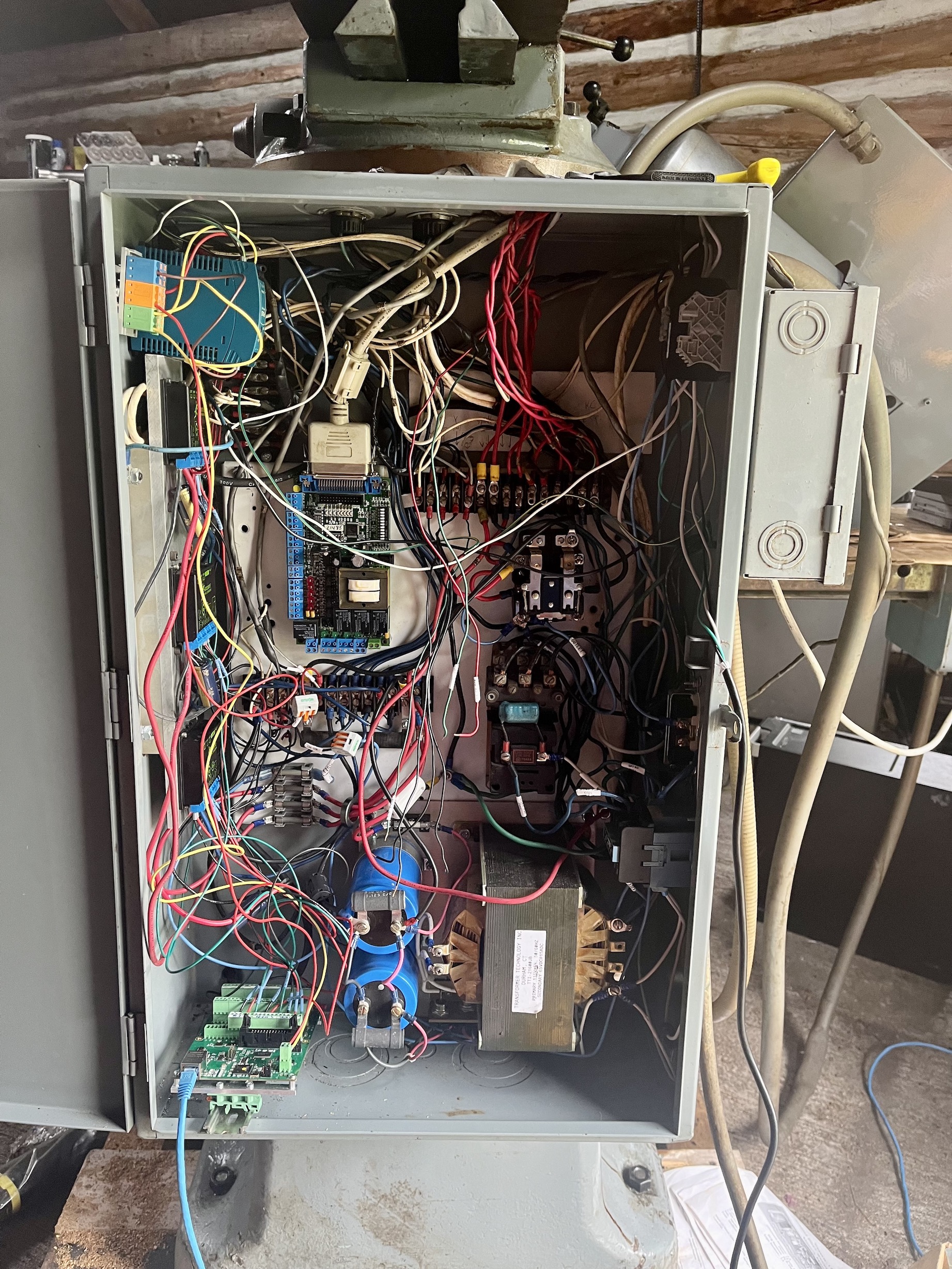

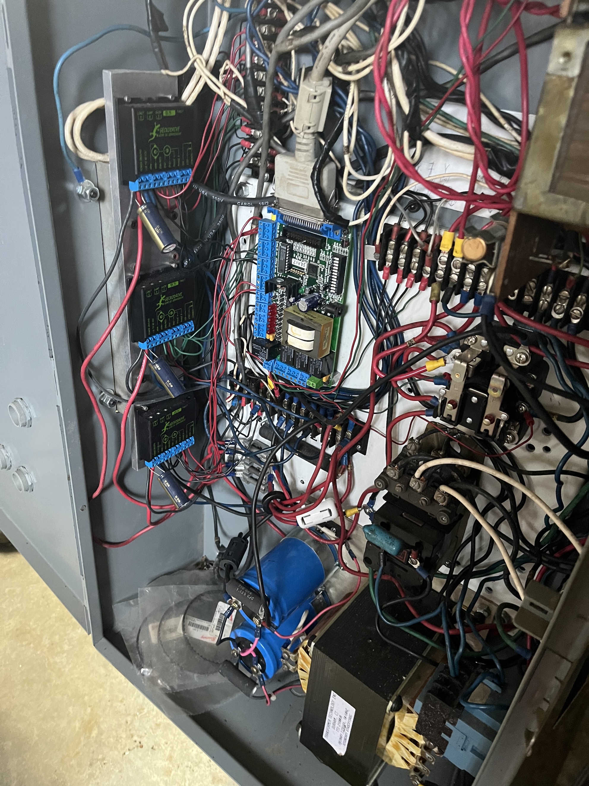

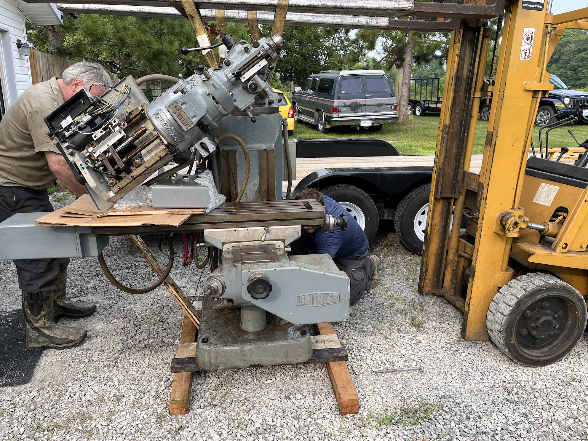

It had already been converted from original controls to PDMX board, Geck 340 drivers, and turbocnc. Olde windows 95 laptop still runs it.
No circuit diagram, yikes
Machine ran off 3 phase input
Installed a MESA board moving one wire at a time

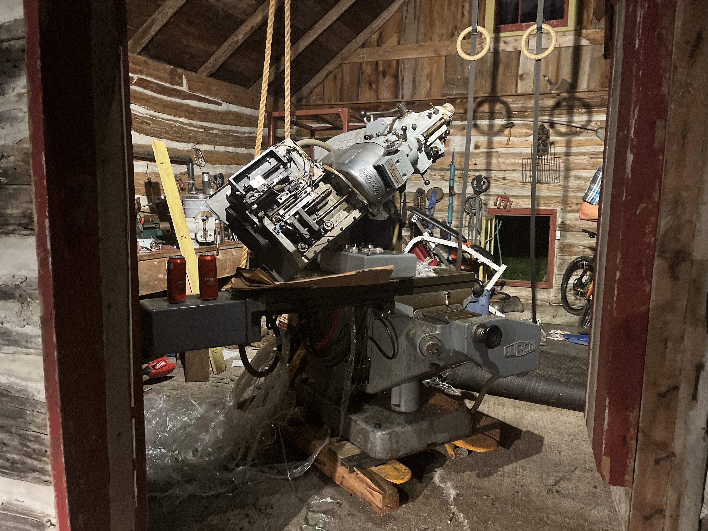

I read the warning that the head has to be supported when rotating back up to vertical.
I didn't do that too well
I broke the worm shaft, had to remove the head and then replace worm shaft, worm gear and head gear.
