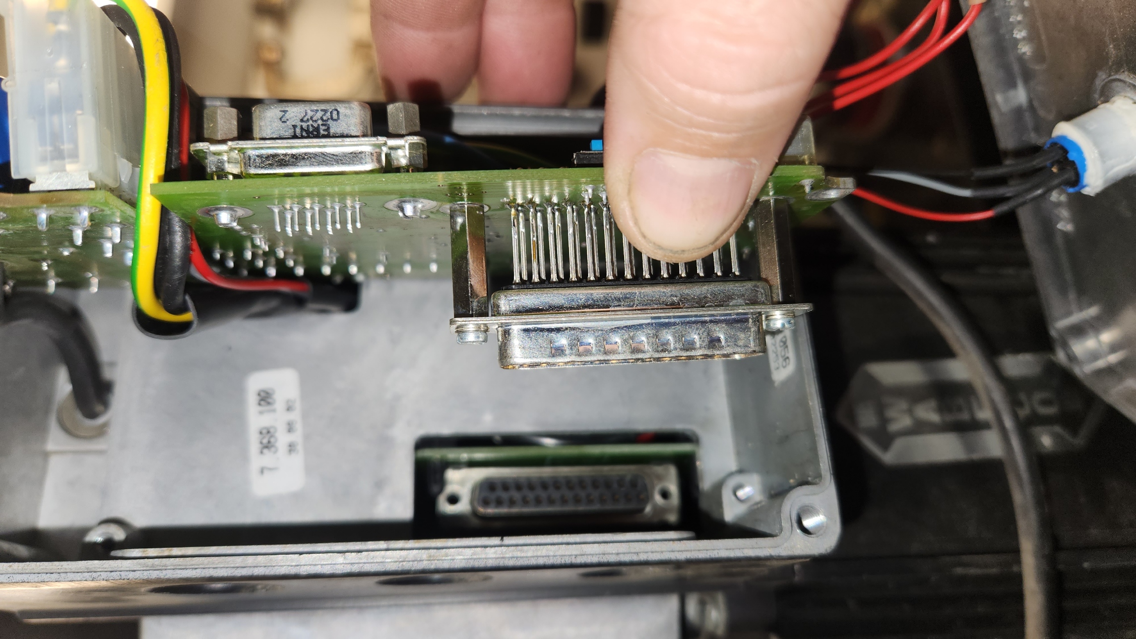

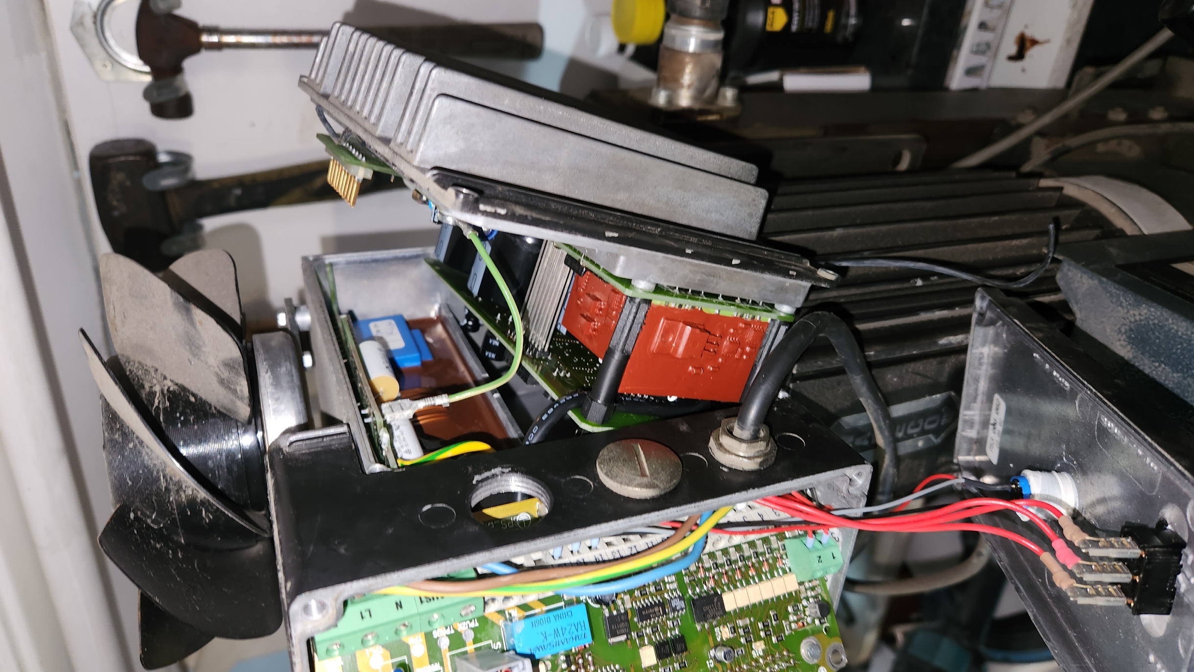

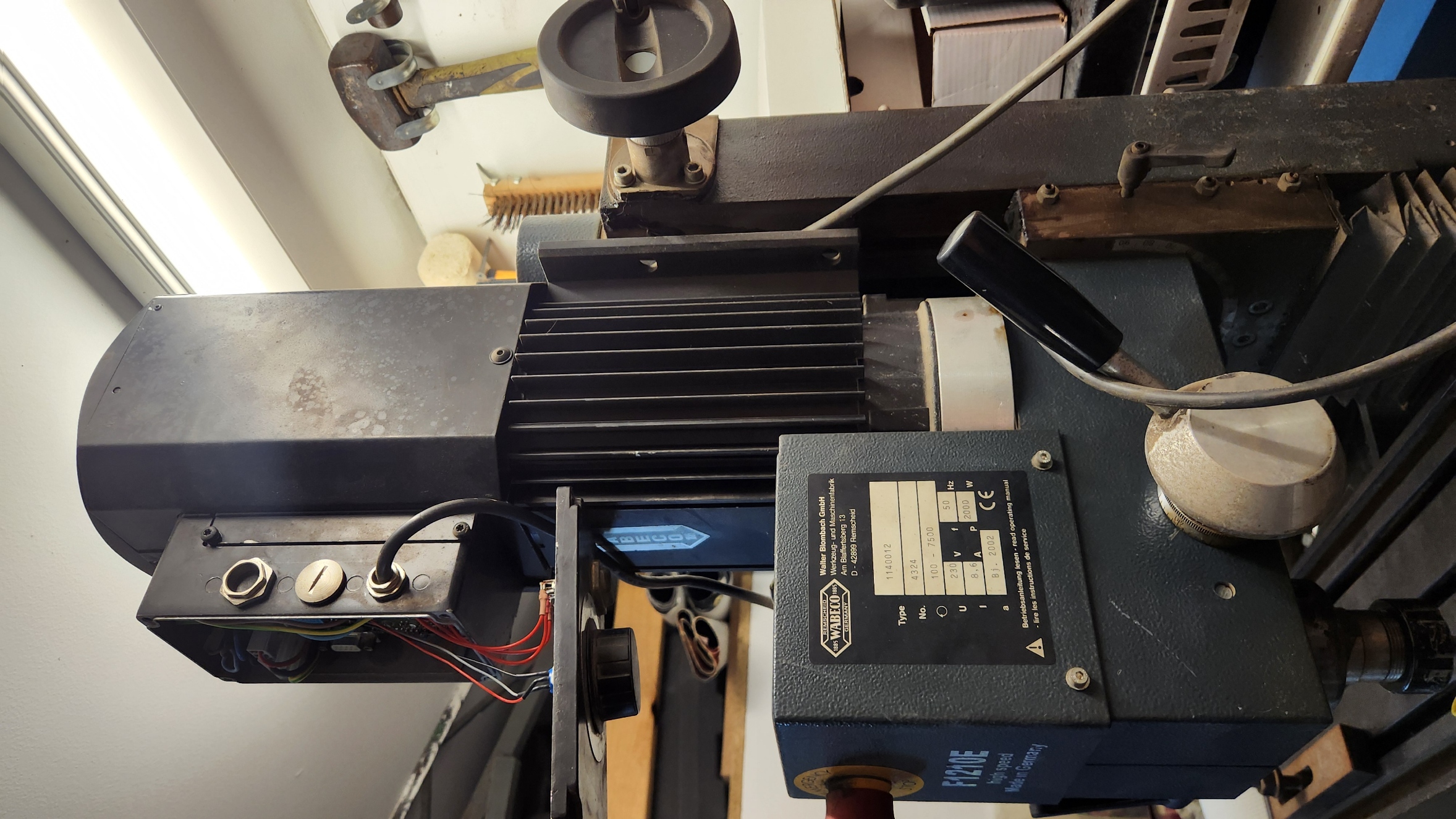

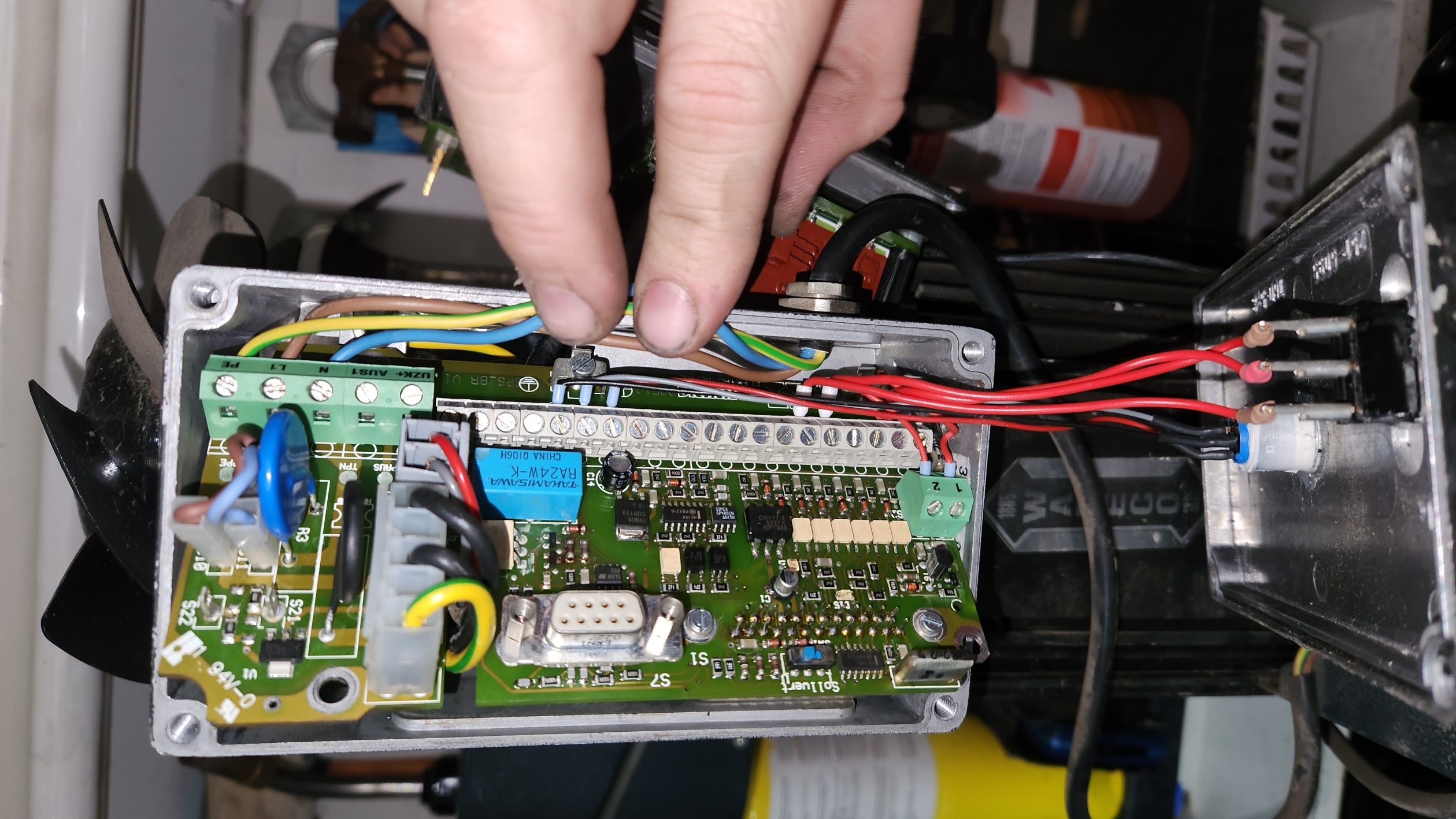

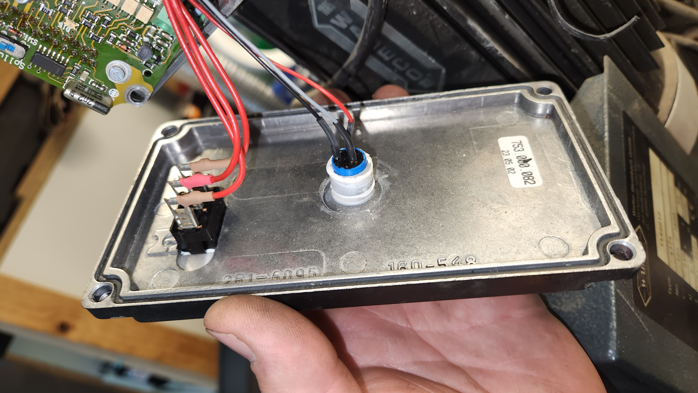

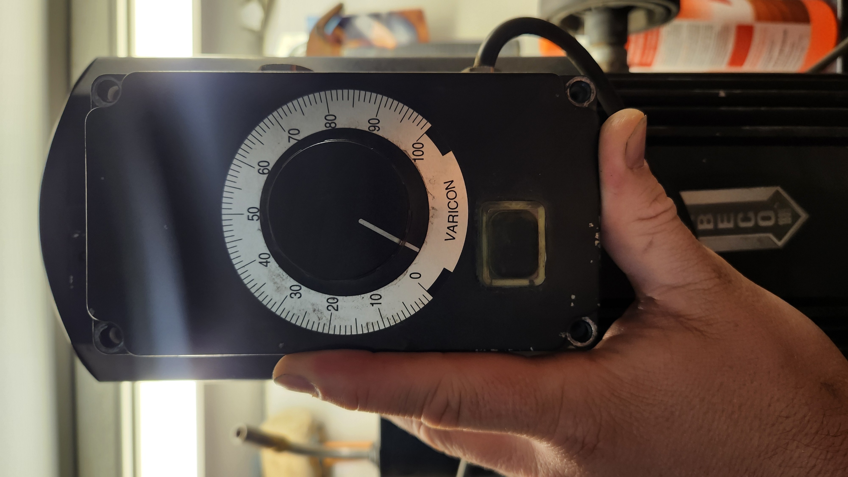

HI All,I am trying to revive an old CNC Wabeco mill, My next step while I wait for new drivers to show up is to interface with the motor/spindle control. There seems to be a lot going on to control the motor, so i am hoping that I can connect to this to control the spindle speed and direction.I cannot find any information online about this setup and I have emailed Hanning but received no response. I would like to find out the pinouts for the 9 pin connector, and all of the other unused connectors.
seems like a decent solid motor and control, else I will just control speed manually, maybe install a tachometer somewhere to it too.
Behind the speed control knob, hoping there is a way I can connect to the RS232 (?) or there are a lot of connections that are not being used, else i need to find a way to emulate the Potentiometer and the fwd/rev switch.
Connects to more electronics via another 25 pin
more electronics above the motor, appears to read the speed of the motor as well,

24 Mar 2024 09:49 #296622
Replied by PCW on topic Interfacing with Hanning motor and control
The 9 pin connector is likely some serial interface (modbus?)
It is currently using what looks like a standard potentiometer +FOR/REV
interface. These can connect to most analog spindle interfaces on parallel
port and other LinuxCNC interface hardware.

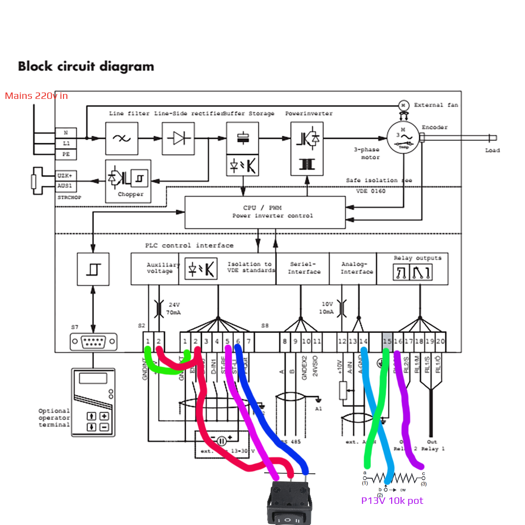

25 Mar 2024 04:48 #296706
by Kandu
Replied by Kandu on topic Interfacing with Hanning motor and control
That looks like the right setup, just need to find the right one for the motor I have, which is much older, (around the year 2000 I think)See attached, this is the closest I could find, but its hard to determine if the diagram is for the board I have, there is the correct number of connections however, that is promising.
Current Config,
Current Config,
- Posts: 22037
- Thank you received: 7505
25 Mar 2024 06:08 #296711
Replied by tommylight on topic Interfacing with Hanning motor and control
Potentiometer is wired incorrectly.
In general it should be:
one side of pot to agnd
the other side of pot to +10V
the middle of pot to AIN

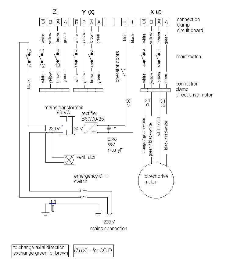

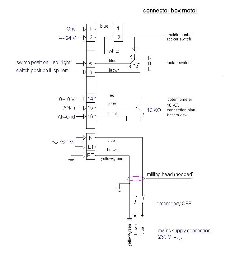

12 Apr 2024 06:06 - 12 Apr 2024 06:12 #298057
by Kandu
I have made some more progress with this, I received a reply from Wabeco, they sent through the following diagrams, however i would still like to know more, (i.e. if there is possibly an RPM output and/or other means of control)
They also mentioned to contact MOBASI inn regards to a control software and motor wiring, ill give that a go
One is for the control panel that is visible behind the speed dial, the other is for the board on the motor.
Last edit: 12 Apr 2024 06:12 by Kandu. Reason: added detail
- Posts: 22037
12 Apr 2024 06:14 #298059
Just to be sure, you are dealing with analog output from Mesa to VFD, not an input.
Mesa analog output is for all intents and purposes, a potentiometer with 3 pins, so same as in schematics, only difference: mind polarity.
Analog inputs, some Mesa boards have them, some do not.Bummer, I'll keep searching. how is linuxCNC able to control a potentiometer input? i must be missing a keyword, cant really find an answer. Thanks again for your help.
