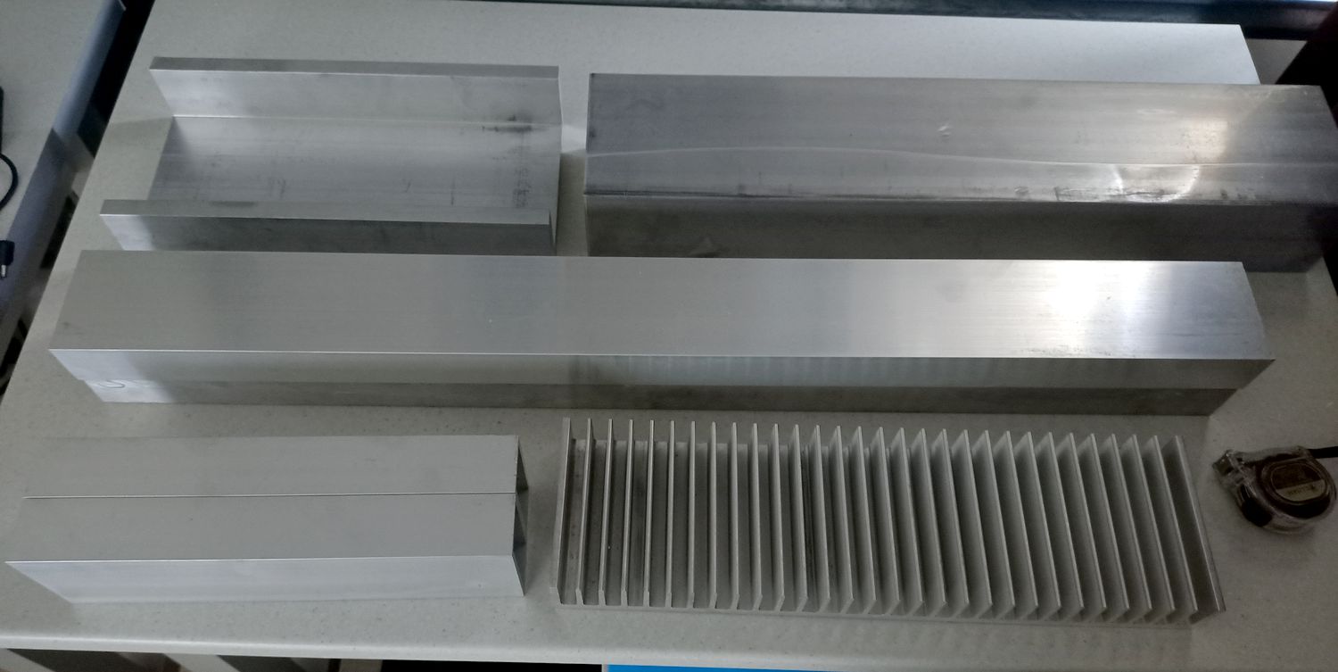

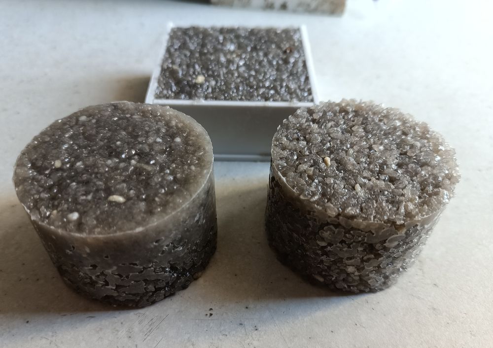

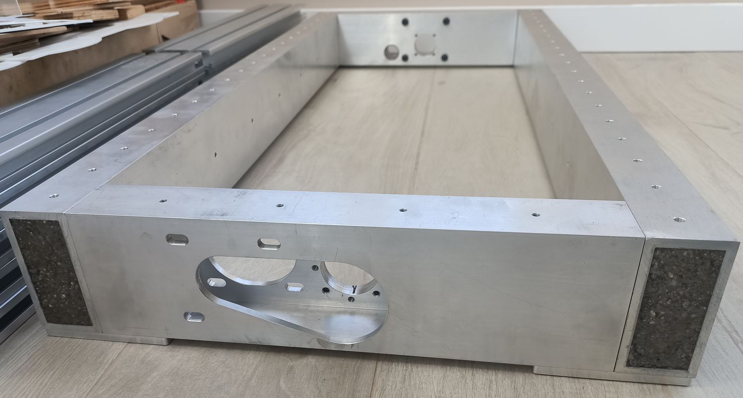

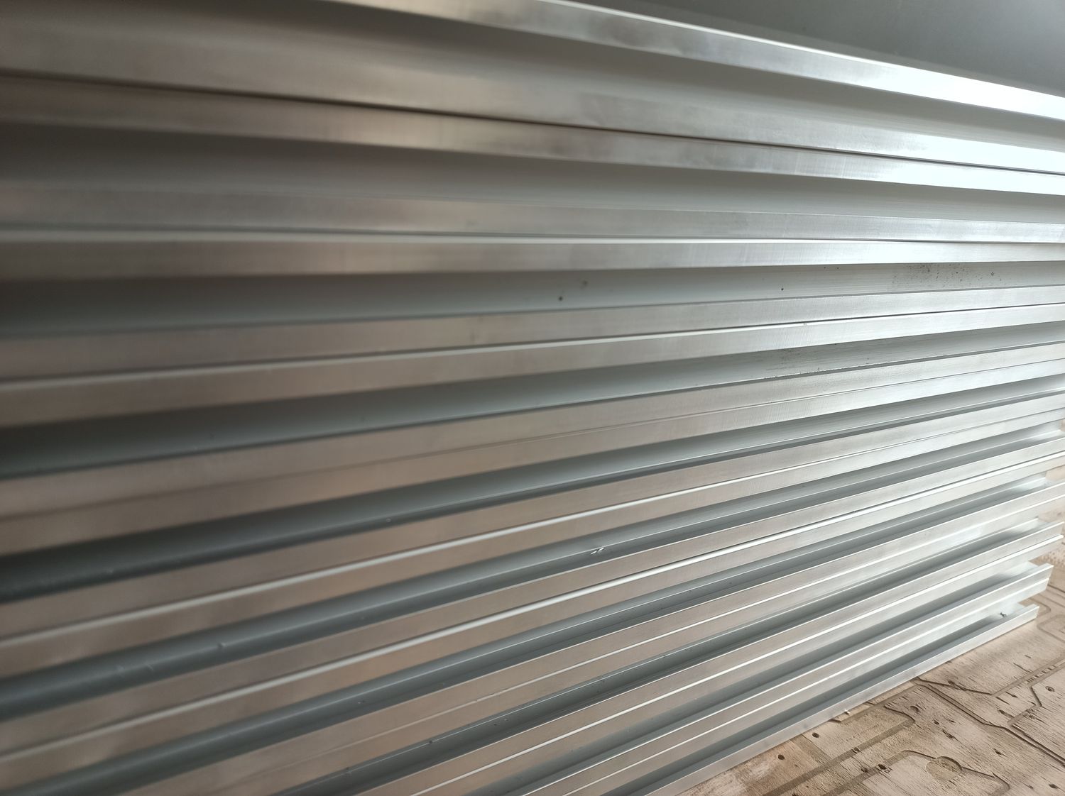

22 Oct 2024 01:15 - 22 Oct 2024 01:18 #312826
by Mr. Mass
Replied by Mr. Mass on topic CNC machine B64-S-ATC

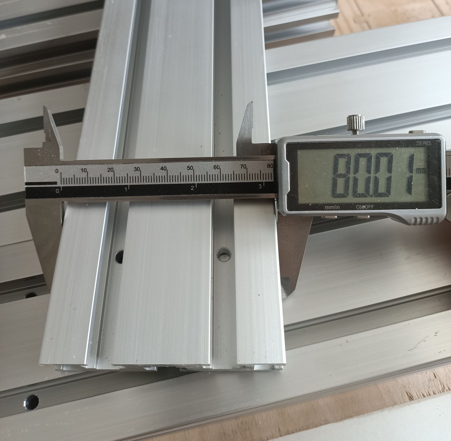

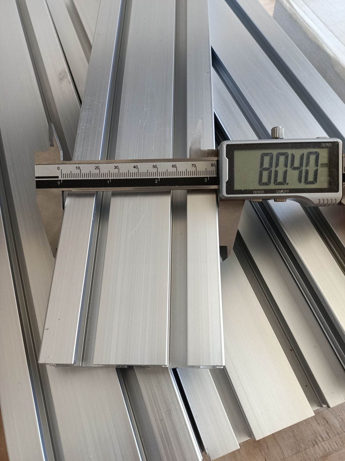

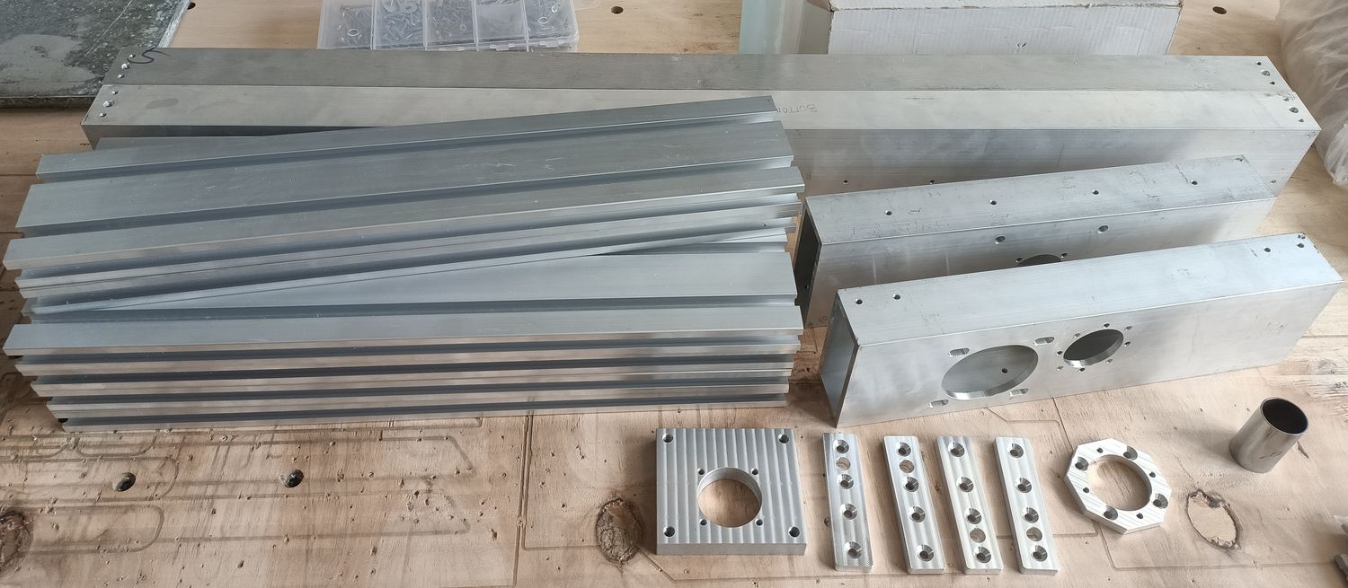

Some progress here. I continued making the base and found out that the profiles with t-slot are slightly larger. Since they fit one to the other and there are 10 of them, this error will not allow to assemble everything.
So I had to fix it.
Finished all the profiles and parts for the base.
Now for the fun part. I've been wanting to try using profile filler for a long time and now I've finally made up my mind. I decided to use epoxy granite, it's easy to make and adds quite a bit of stiffness and most importantly, dampens vibrations very well. I made some samples to check the composition of the mix, everything went well with the calculation.
Then I decided that it would be easy to put the tabs in the profile with an internal cross-section of 70*30mm. But it turned out to be very difficult, don't do it like that.
Laying the mixture inside and tamping it down through all those tabs wasn't easy either. Now while the epoxy granite is gaining its strength I can do the other parts.
So I had to fix it.

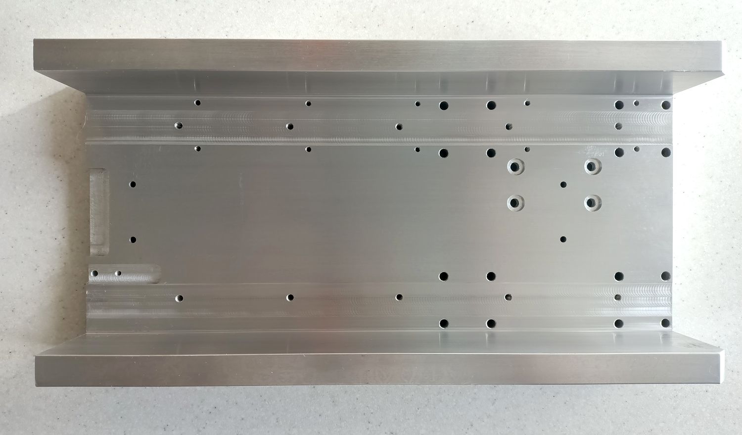

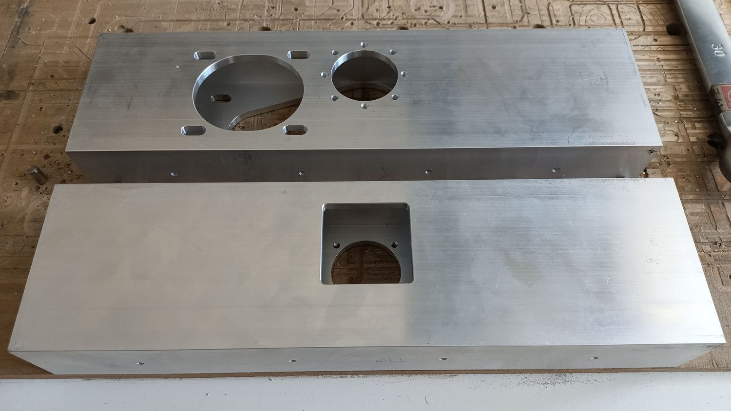

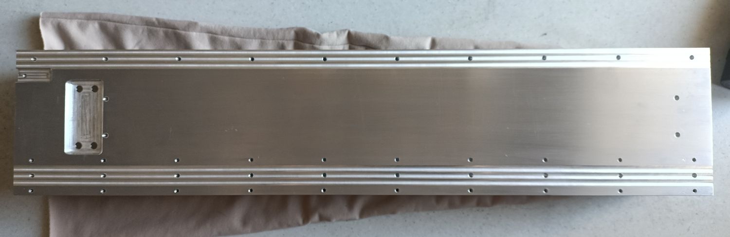

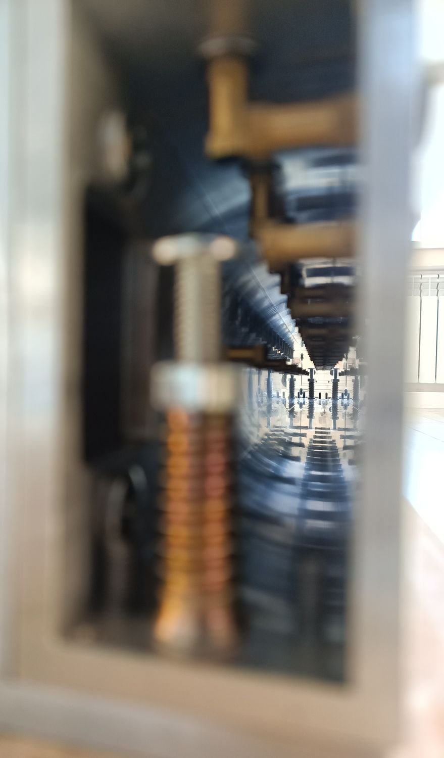

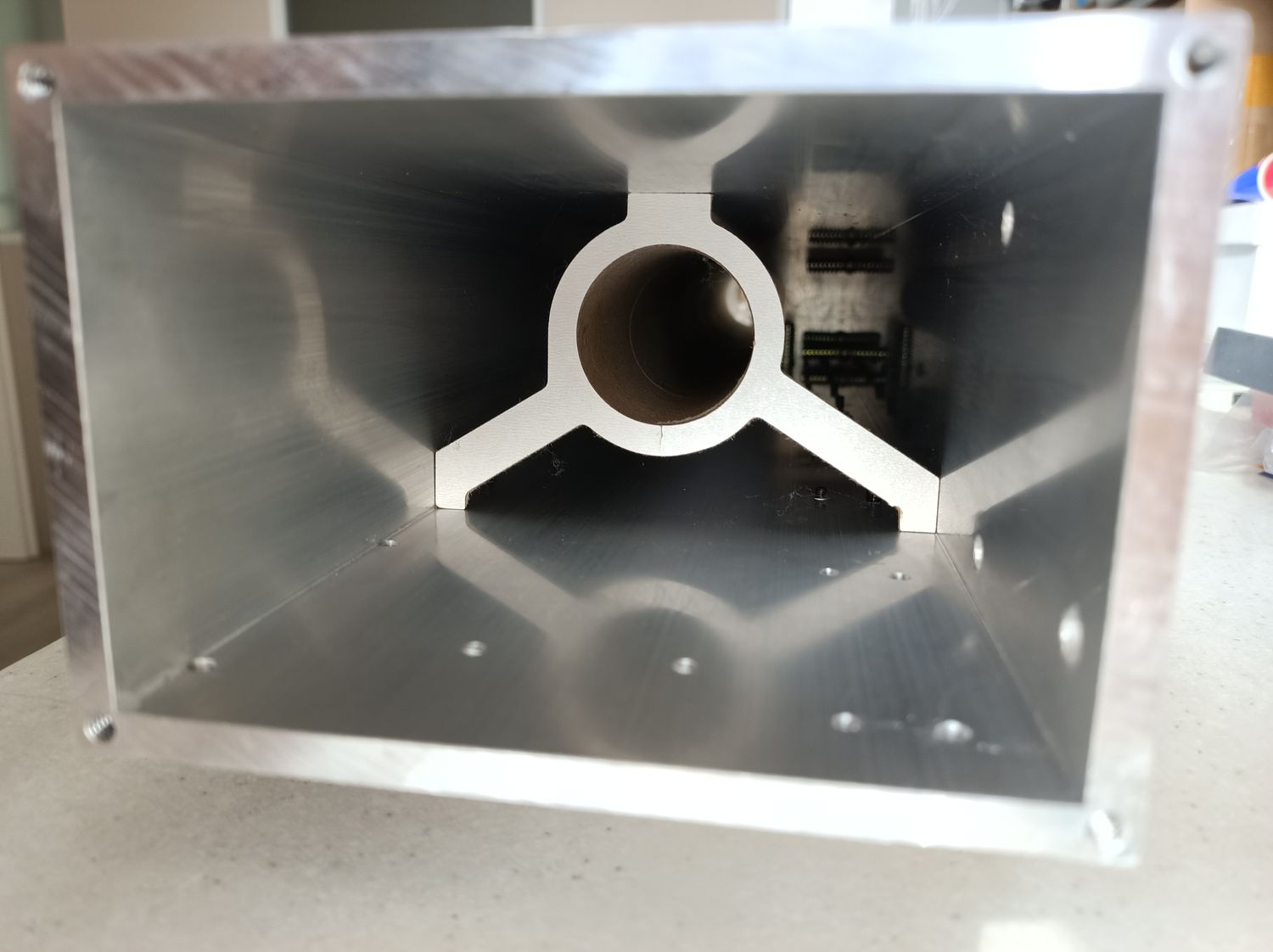

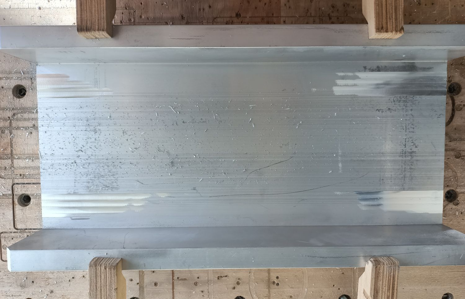

22 Nov 2024 05:42 #315027
by Mr. Mass

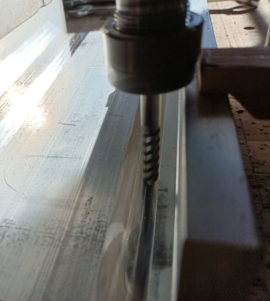

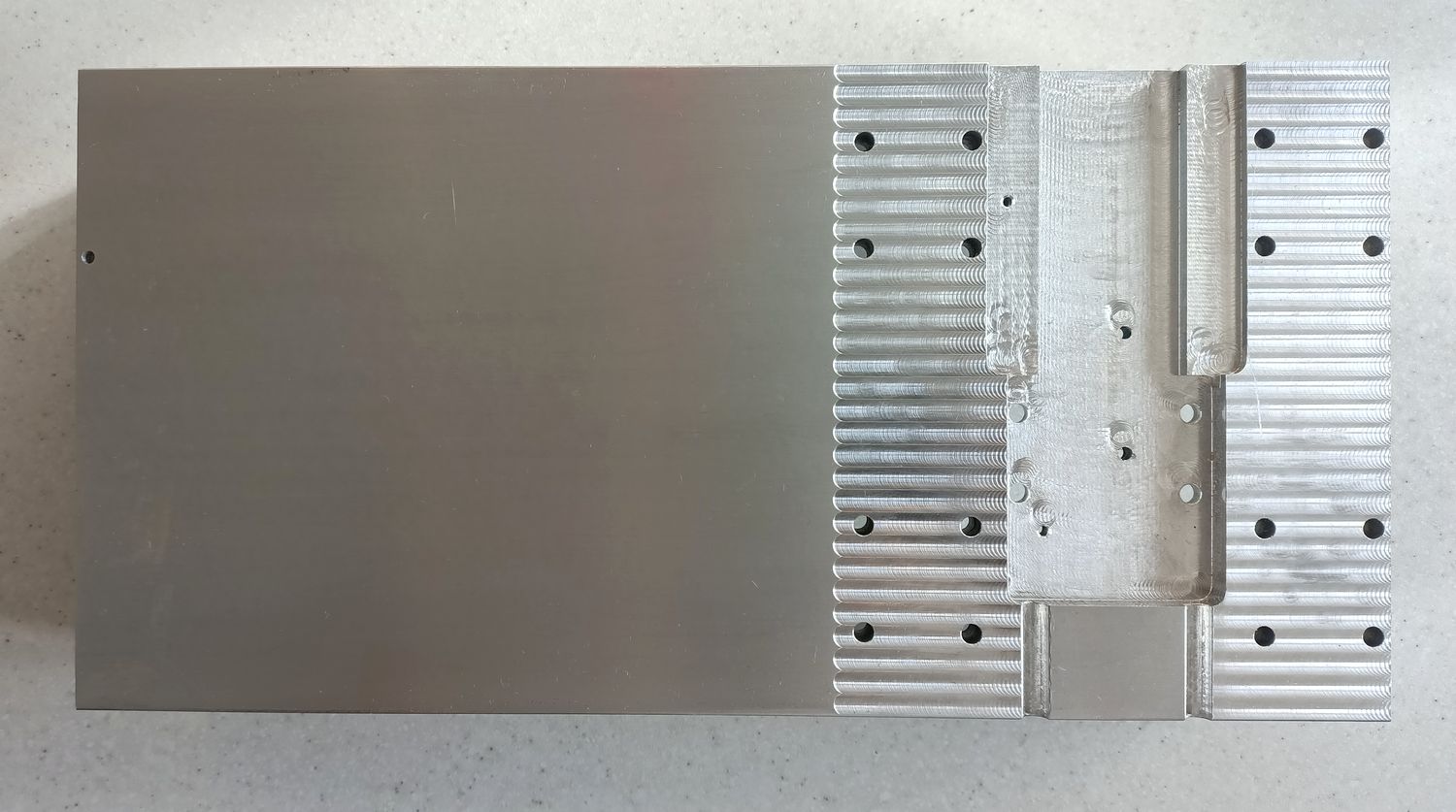

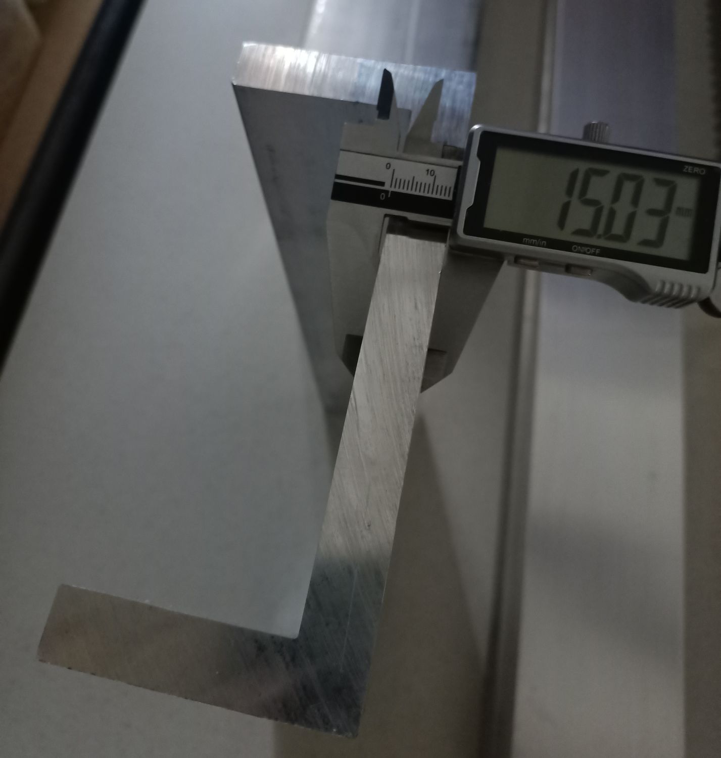

Now it's time for the portal beam. I milled seats for the rails (the profile itself was bent by about 0.2mm) and drilled all the holes.

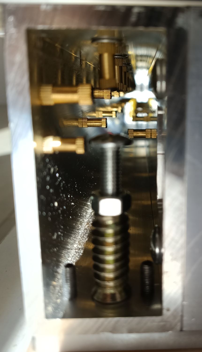

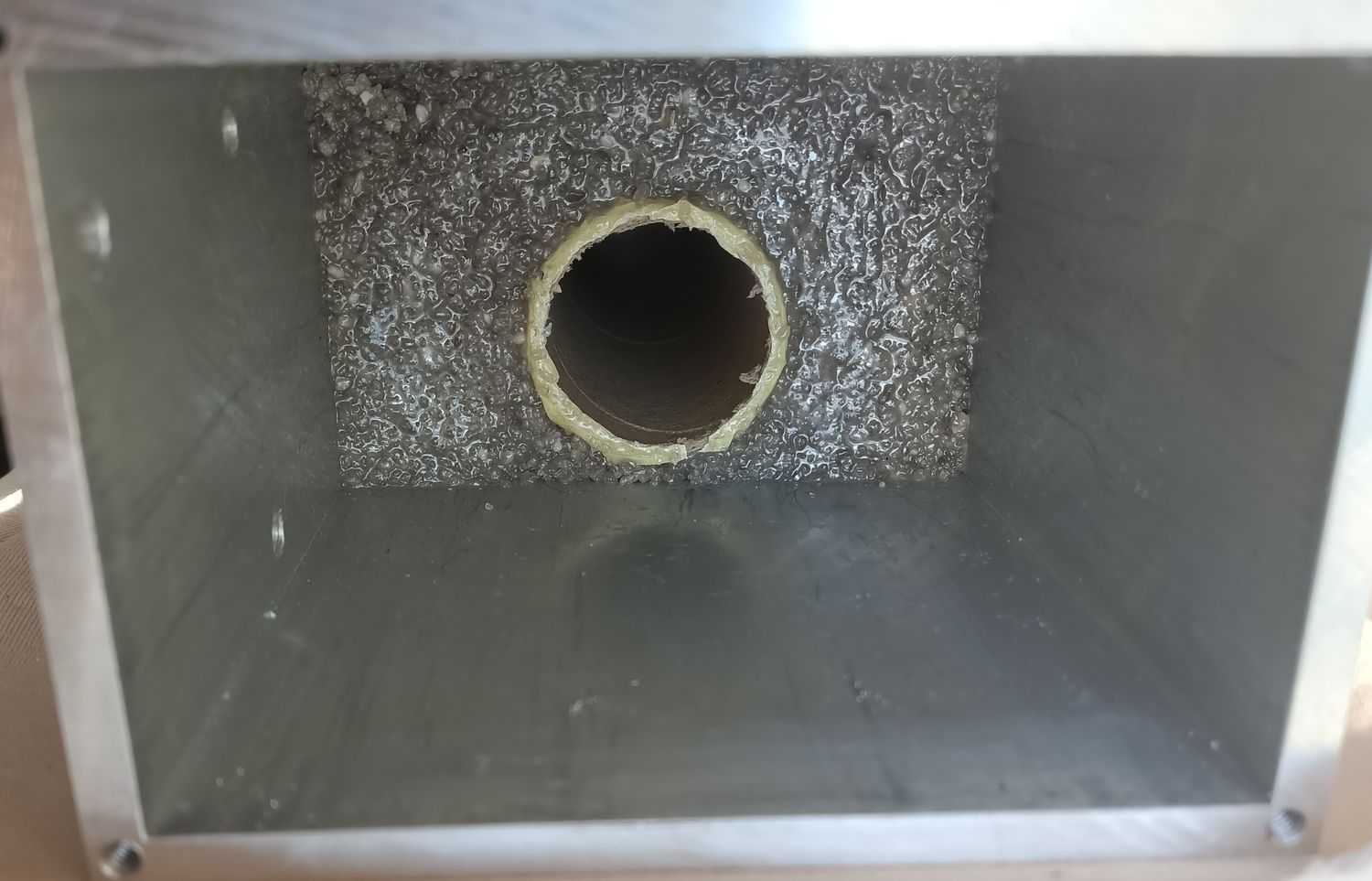

I also decided to fill this profile with polymer granite.
Remembering not very successful variant with tabs in the base this time I decided to try a different way. I cut all the threads directly into the profile and then screwed the screws in. Then I poured the polymer granite and after a few hours, when the mixture began to harden, I carefully unscrewed it all. It was much quicker and easier than with tabs.
There will be a motor on one side, so the fill will not be full volume. I also decided to put the wires from the motor through the profile, so I used a cardboard tube for this. On one side it is held by an aluminum plate. When pouring the polymer granite to have support inside, I made a piece of thin MDF.
