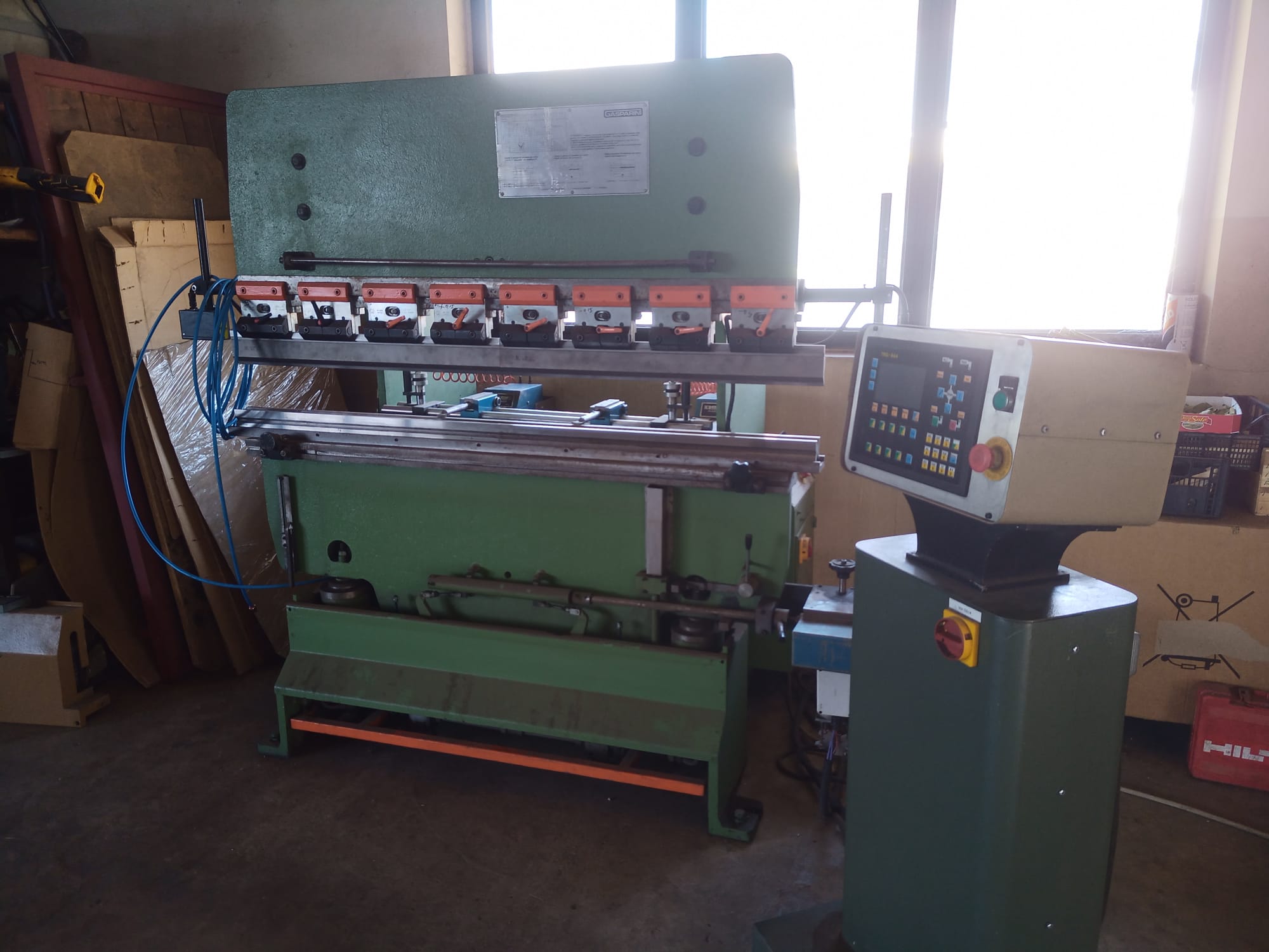

Hi
seem to have stumbled into a little project.
I have already retrofitted my Maho MH500 and a cycle lathe to Linuxcnc
retrofitted, which is why a friend has now asked me to have a look
to have a look at his bending machine.
The press was probably retrofitted to a newer control system.

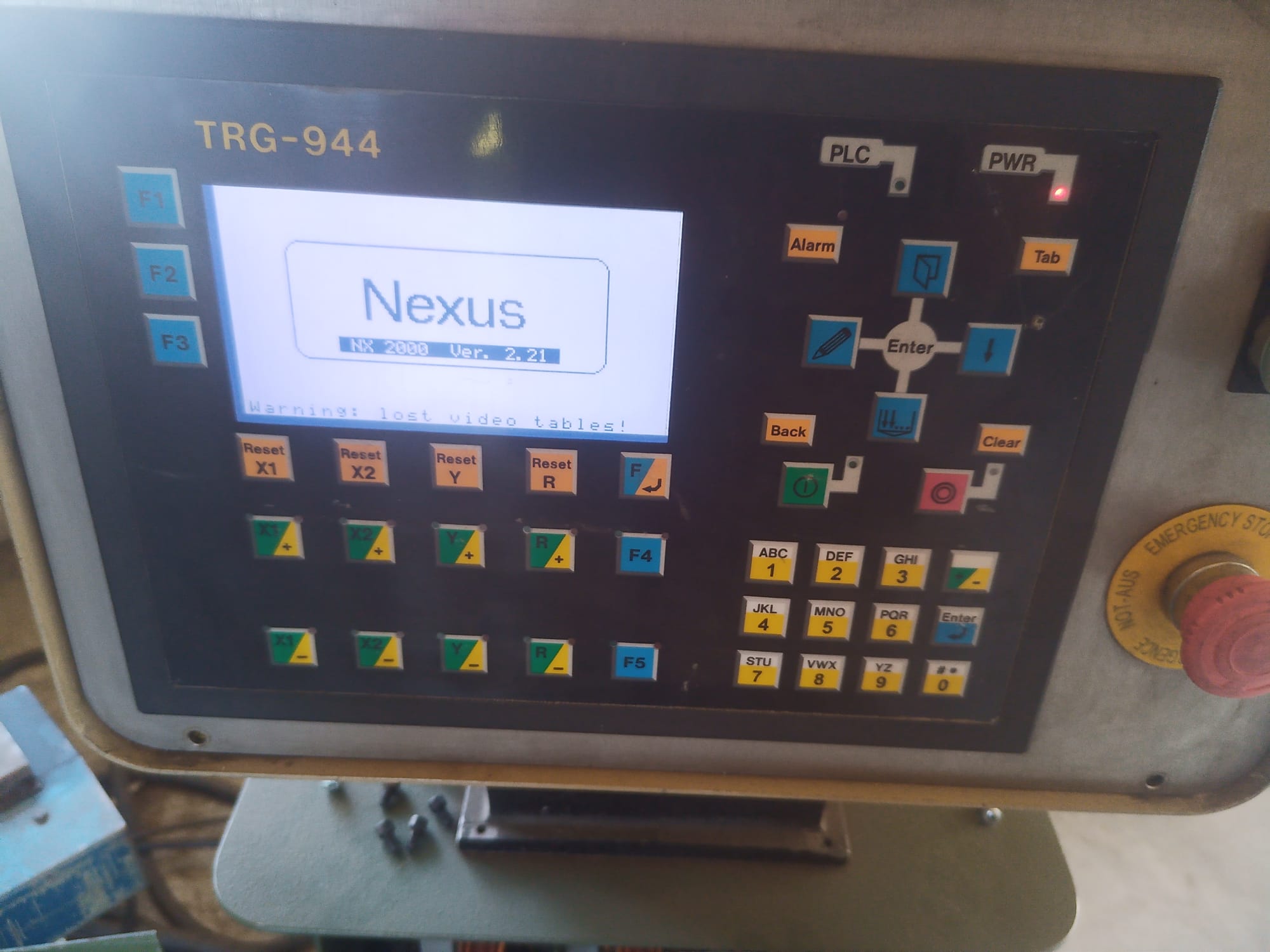

However, it has now stopped working and when I switch it on I get the error message
"WARNING LOST VIDEO TABLES"
if I google this I only find 3 forum entries, but without any answer or even a solution.
I can't say whether the controller is broken or "just" lost the programming or parameters...
In any case, I now need a replacement.
A simple 3-axis positioning controller.
The controller would only have to control 2 stops and the press stop.
all 3 axes have analog -10/+10V drives
there are probably 3 encoders somewhere for the position feedback
and that's about it.
I don't need cycles and bending programs.
If we get the 3 axes into the desired position via the control system and
then operate the press hydraulically as usual is enough...
If the machine were in my shop, I would say
Linuxcnc Raspberry, small TFT mesa card and I operate the thing via Gcode in MDI.
Maybe there is a simpler standalone solution?
