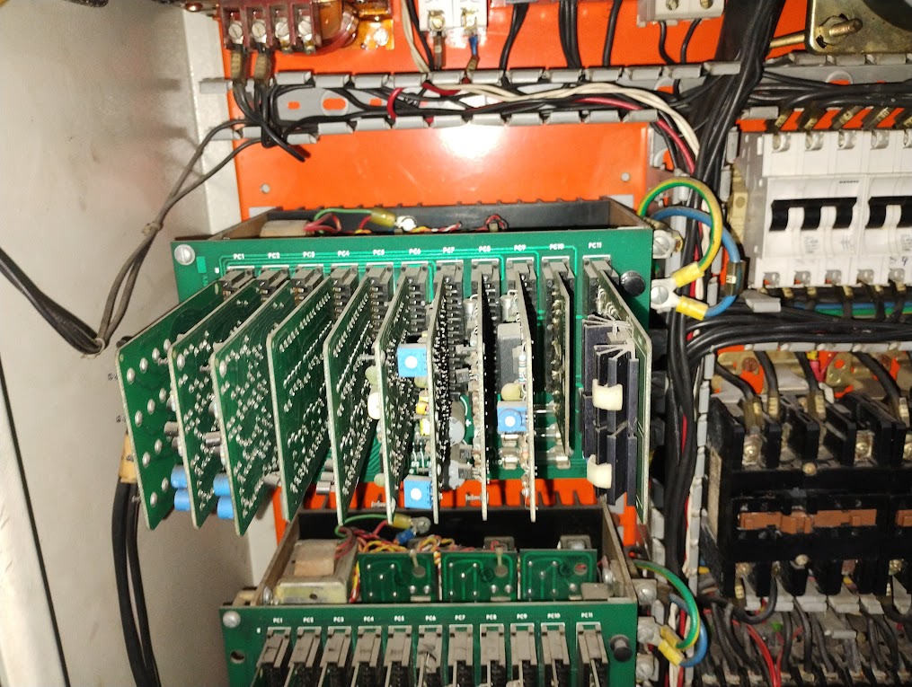

Hello Mates,
I'm in the process of retrofitting this INDUMA Knee Milling Machine from NUM750 to linux CNC, right now the machine is almost running.

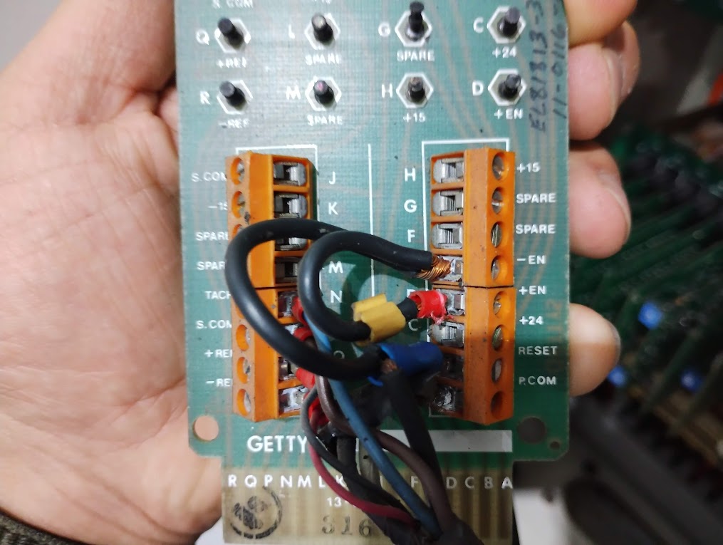

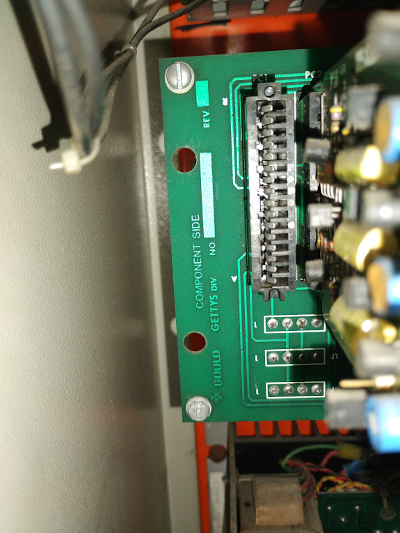

It happens that I have no data at all on the servo drives. All I know they're from Gould Gettys. The Y axis has some drift I'd like to adjust, but I do not know which pot adjusts it.
Googling the driver look similar to the A121 N360 from Gettys.
Another doubt on analog servos: they tend to drift and slow move, even with 0V voltage reference. What is the best strategy to hold axis in position? Internal PID corrections or to disable the servo output?
Greetings from Brazil!

It is completely normal for an analog velocity mode servo to drift when the position loop is not being closed. Yes you must have some form of position feedback to the control system commanding the servo. Usually that would be an encoder connected to Linuxcnc with a PID loop controlling the velocity command to the servo. Normally the servo should be disabled unless Linuxcnc is in control of if and sending commands to correct for any drift. (In other words that enable signal you have jumpered on the drive's input pannel needs to be connected to a digital output from Linuxcnc.) That will stop the drive from drifting when Linuxcnc is not enabled (once you've tuned the position loop in Linuxcnc.)
