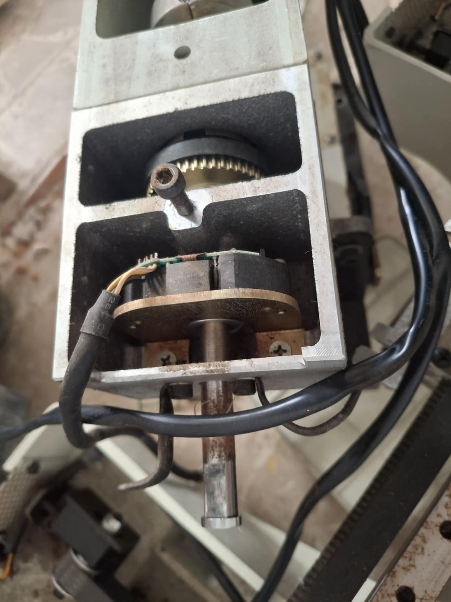

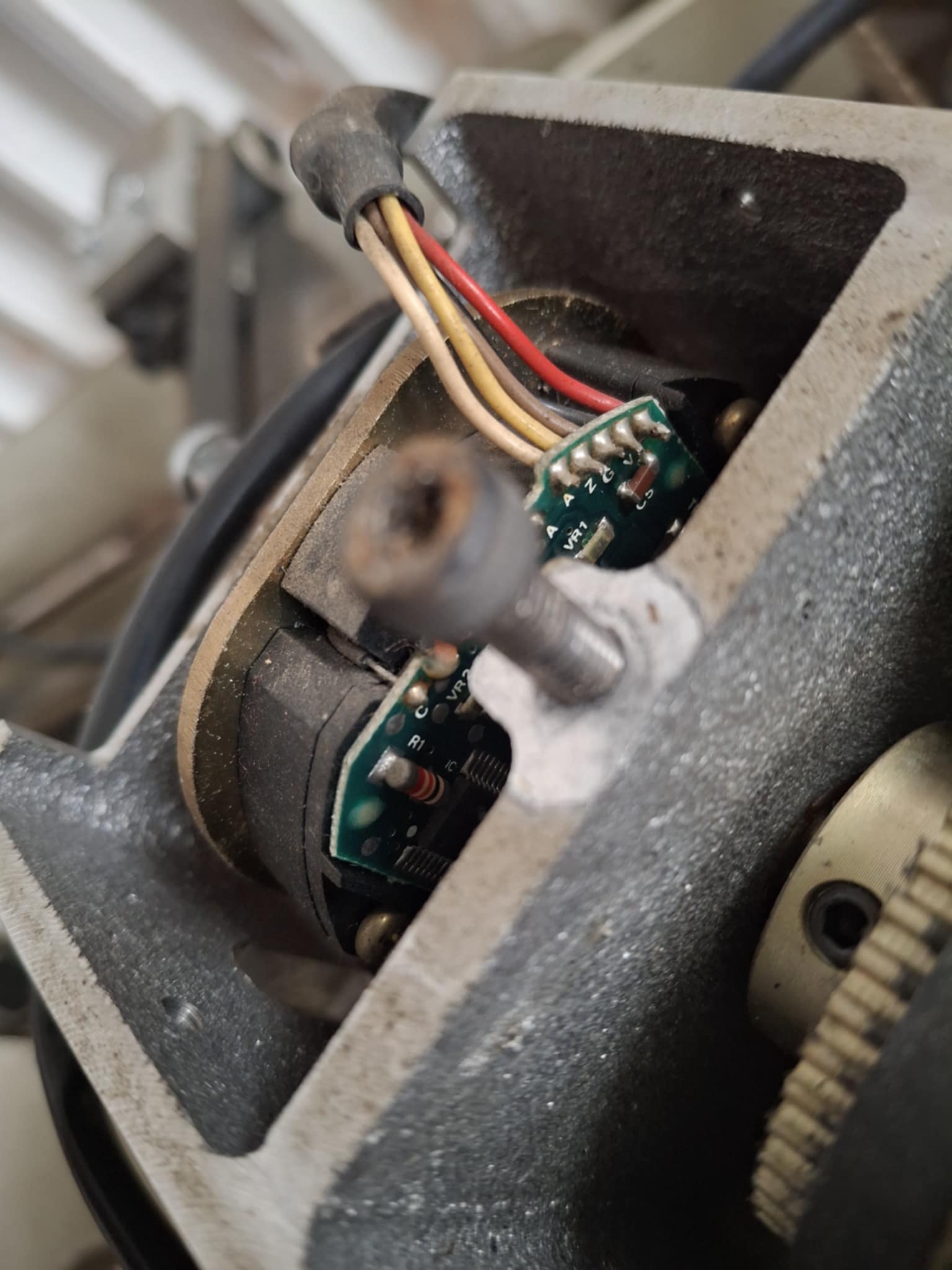

I have a question about the needle motor control.
I have this electronic component, I suppose it's an encoder because of the markings next to the wires. A (Phase A) Z(Pulse) G(Ground) V(VCC) B ( Phase B )
Can you confirm this?
If yes, I suppose that I control the speed of the motor for embroidery and the position for changing the head (I have 5 heads).
However, I don't have a reference for this one. What test would allow me to know the number of pulses for this encoder?

For homing I would meassure how much the resistor value changes for one motor revolution. After that one can think of solutions. That said. It would be a good step to identify the ratios of the axis.
For the needle encoder. Plug it to a mesa card (first test with bench power supply and oscilloscope) and turn 10 revolutions....

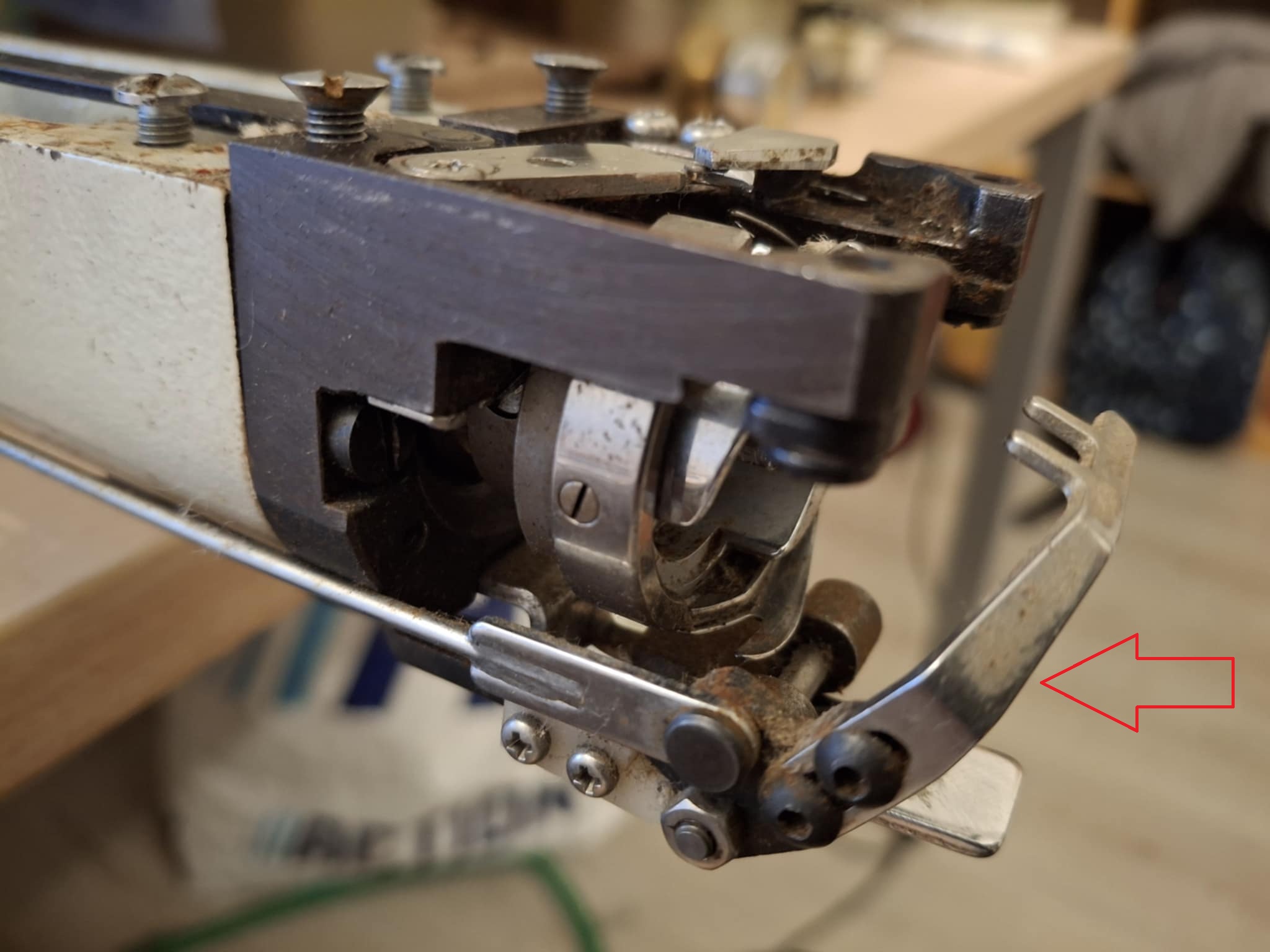

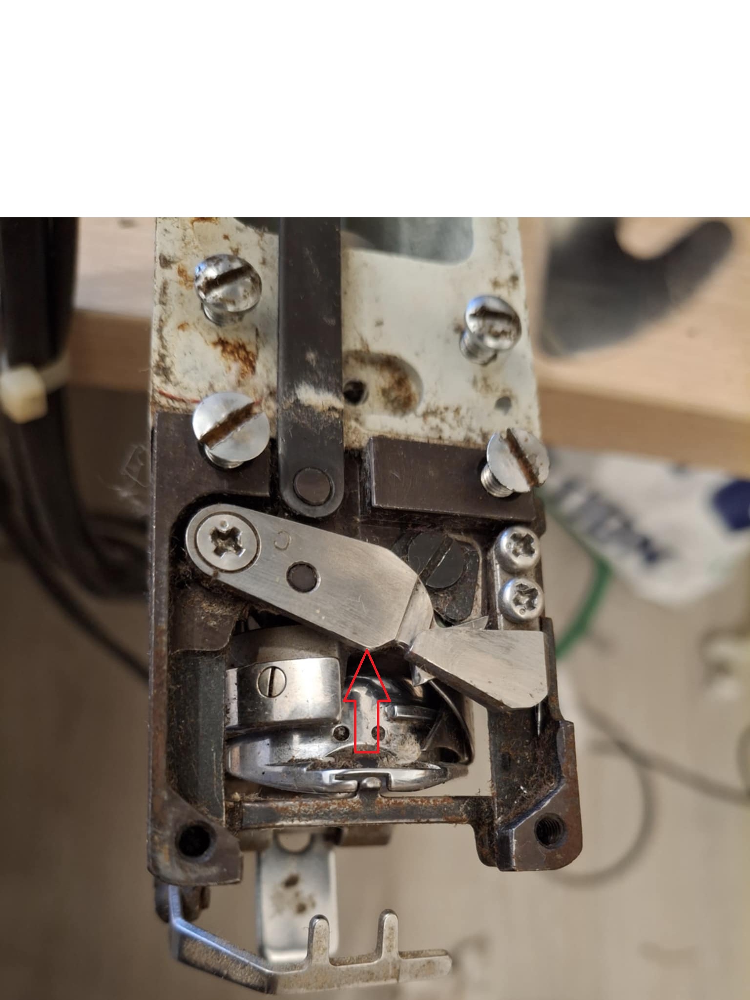

- greg23_78
- Posts: 142
- Thank you received: 7
07 Jun 2025 22:08 #329903
by greg23_78
Replied by greg23_78 on topic Toyota embroidery machine - retrofit
I'm trying to identify each component to find out how this embroidery machine works.
I have two rotary solenoids that operate elements in the bobbin.
I presume that this lever locks the bobbin. Is this correct?
For this component, I'm not sure. At first glance, I have the impression that it cuts the thread, but I have a rotary solenoid on the upper arm.
The way it works, when the rotary solenoid is active, it engages the system and the component moves back and forth when the needle is up and stays in the position shown in the photo when the needle goes down and up.

I will try to get my mother to have a look at the pictures, she still uses those machines daily despite being 75 years old.
Replied by tommylight on topic Toyota embroidery machine - retrofit
Nice.i think i'll keep the potentiometers, because i've never coded a homing with an encoder so this will allow me to improve, and if i never manage to, it's easy to dismantle so i could insert home switches.
- Posts: 21980
- Thank you received: 7480
08 Jun 2025 19:36 #329964
Nope, she can not figure out what those do, strange as her machines have that part much, much more complicated.

Thank you for asking.
I've done a lot of research and I've just about found the solution, now I just have to imagine how it works in my head.
Below is the result of my research for those who are interested:
I found exploded diagrams of toyota embroiderers and therefore found their name.
Then it got easier!
Their names: thread catcher and ass'y picker (assembly picker).
ass'y picker :
thread catcher :
Then it got easier!
ass'y picker :
thread catcher :
