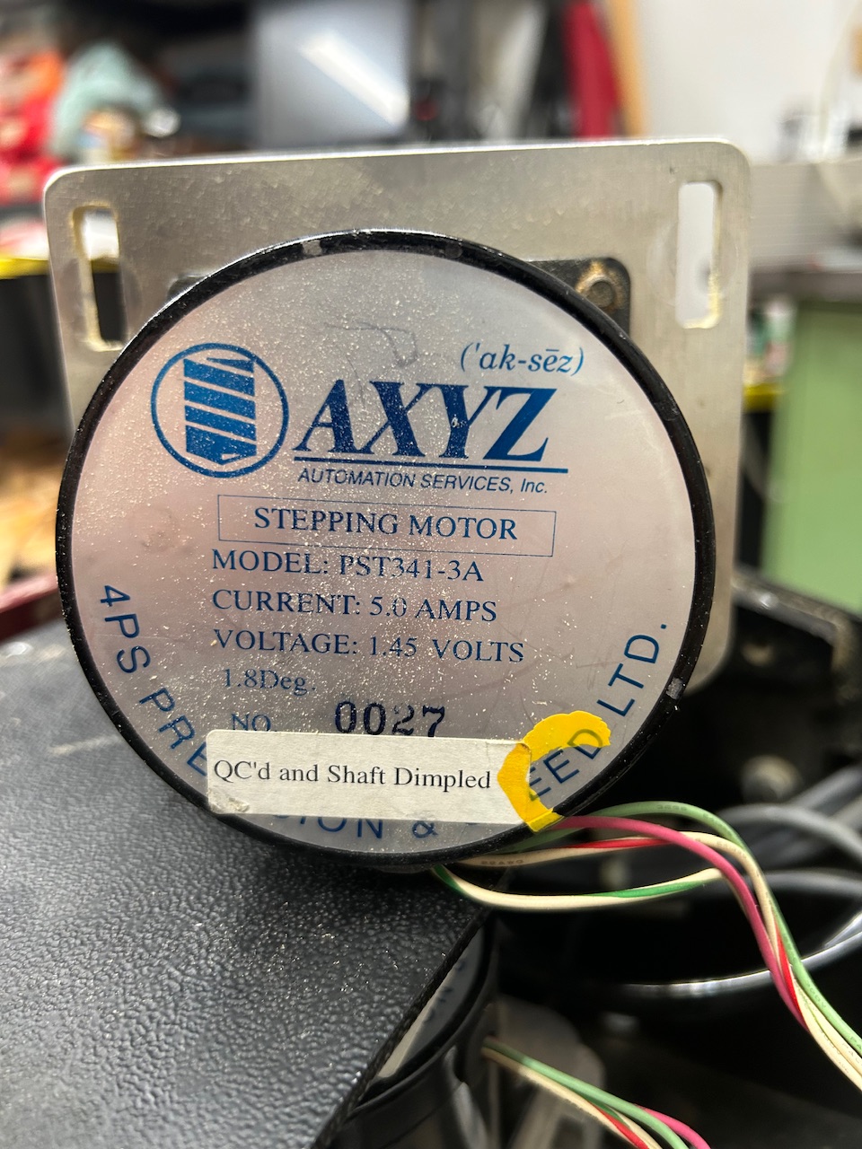

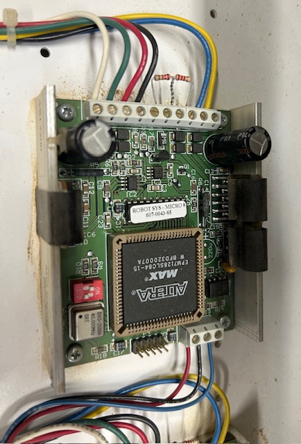

Well, not much progress tonight. I think I need to take a step back and better understand what signals linuxCNC and the Mesa card is producing for the PnCconf settings. Doing some research online suggests I’m not alone in struggling to get these undocumented stepper drivers to work. I foolishly messed with the output side wiring voltage divider this evening (without having adequate documentation) and the stepper driver released some magic smoke. Sigh. I am hopeful it was only the driver that died.
Looks like I’ll need to look at replacing the stepper drivers. Are there budget options? Motor size below.

Drive pictures?
Motors look like 4 wire ones, so Bipolar, so even cheap China drives should work, those "TB6600" that use TB67S109 chip are pretty good and are the cheapest enclosed drives at about 10-15$ a piece.
If you just want to get the best stepper drives, LAM Technologies are the best i have used, but at 100$ and up a piece are not cheap. DS1044 should be more than enough for most hobby or semi professional use, and the above price is only when they are on discount at www.mechapro.de, and do not mind the disparity between the current ratings, LAM insist on printing only the real current they can do so 4A drive is the usual inflated 5.6A. This is very important as if you set them to 3A for a 3A china motor, that motor will be smoking soon.

At this point, I’m really looking for budget friendly. If/when I get the machine moving with the new Mesa card, I will look at upgrading the stepper drivers. The stepper driver power supply I have is putting out 40VDC. The TB6600 looks to have a rating of 9-42vdc and 4A but the motor lists 5A. Is that going to be an issue? The price is right. Would a DM556 20-50vdc and max 5.6A be a better option?

Here is what I’m seeing regarding specs. Recall, I have 42V and the stepper is listed at 5A.
DM542 2-phase stepper motor driver
* Output Peak Current: 1.0~4.2A (3.0 RMS)
* Input Voltage: +20~50VDC (Typical 36VDC)
DM556 2-phase stepper motor driver
* Output Peak Current: 1.8~5.6A (4.0 RMS)
* Input Voltage: +20~50VDC (Typical 24-48VDC)
DM860 2phase stepper motor driver
* Output Peak Current: 2.4~7.2A
* Input Voltage: +18~60VDC

DM542 Has a better voltage range, but is still small in current output (4A peak).
- Posts: 21980
- Thank you received: 7480
16 Aug 2025 15:59 #333518
Replied by tommylight on topic AXYZ retrofit - Stepper driver settings
If you can choose from the 3 you listed, DM860 for sure.
It is the only of those 3 that can drive your motors properly.
