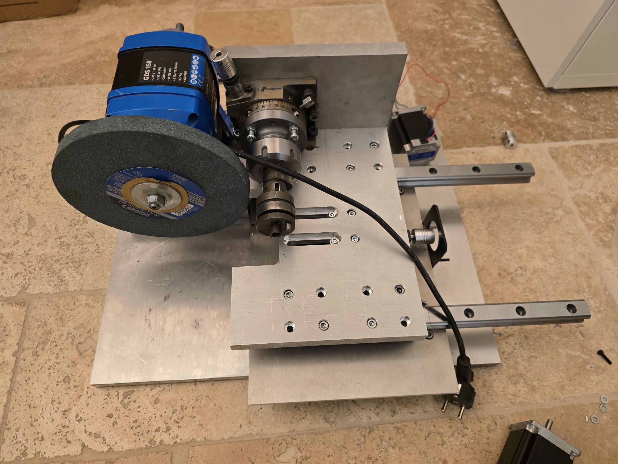

Hi all,
I am Juxus from Germany and building my first LinuxCNC project: a camshaft grinder. The mechanics are almost done - now it is time to setup the Mesa 7i96s and LinuxCNC. Laptop (Lenovo T450s) is setup and exclusively for operating the machine.
The idea is to run the A axis with an encoder for turning the camshaft and Y axis for positioning the cam against the grinding wheel. X Axis is to positioning the second cam after the first one is done.
I am a total beginner with LinuxCNC and I am thankful for all hints!

Change the couplers between the lead screw and stepper motor. They can wind under load and tear themselves apart.
Looks good so far.

You might consider a more narrow grinding wheel. Then you can traverse the x-Axis. I think this might improve surface finish.
I also would add a tailstock support on the end of the cam shaft. It will improve things, worth the effort.
Edit: I would first try to get x-y-z and rotation running. Then try some simple cylindrical grinding to get a feel for the machine and surface finishes.
Please keep reporting how things go.
