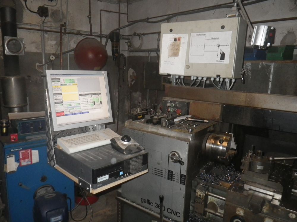

If you have a 7I96, it can support up to 4 MPG encoders directly on the isolated inputs
with the right firmware ( 7i96_inmd.bin )

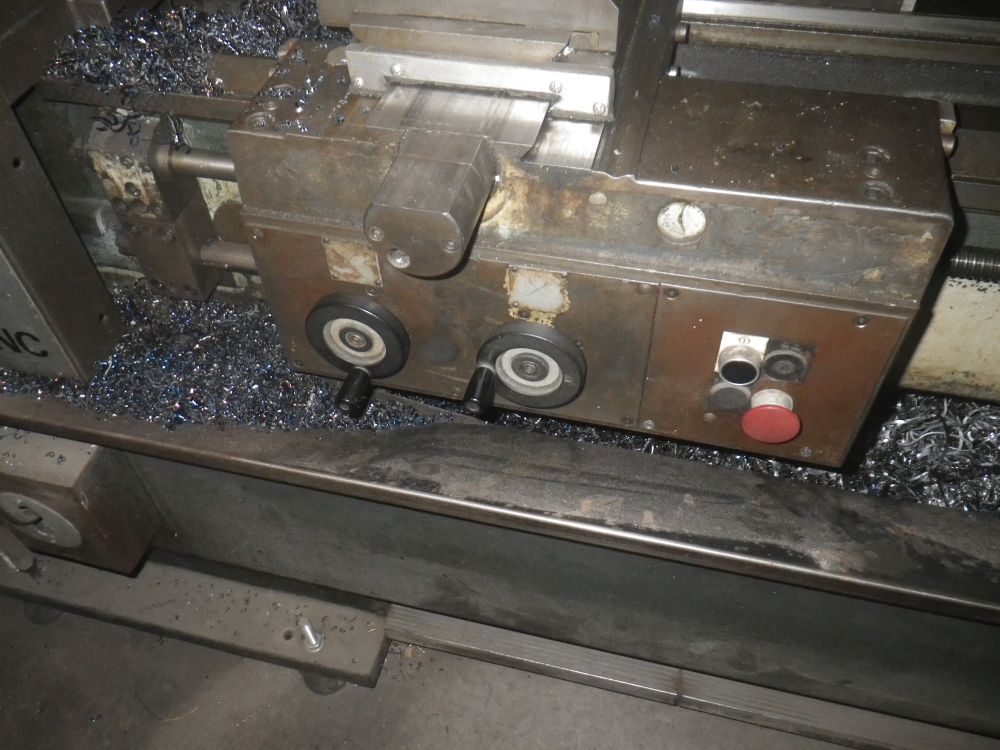

On my lathe:
bodgesoc.blogspot.com/2016/08/holbrook08.html
I installed a 7i73 inside the apron to handle the limit switches, handwheels and a jog-rate select knob (which is also a switch that selects manual mode to enable jogging).
Your 7i96 has a smart-serial port, so you would connect a 7i73 to that.
It means simpler cabling in the cable chain, but you need to use suitable cat5 cable to handle the continuous flexing. (eg Igus chainflex / LAPP Etherline FD)
I don't see anything in the photo to exclude the possibility that you are in the UK (I look at mains sockets) so if you are, Rapid Electronics sell a lot of these expensive industrial cables by the metre. www.rapidonline.com/lapp-0028308-liyy-pe...e-8-x-0-25mm-63-6718

Thanks for enlightening us ignorant folks. I'll call Siemens and Heidenhain right away and tell them to remove that feature from DMT Kern, DMG, and the rest. I'm sure they'll be thrilled that someone has finally pointed out they've been doing it wrong ever since the 1980s.

I converted a manual KBC GRIP-1340 lathe to CNC, kept the handwheels connected via encoders. I can manually machine or NC with it, It is more like a 'teaching' lathe, or tool room cnc lathe. Gives you the ability to quickly face or turn a diameter without having to write code or install a gui/cam thing to do it for you.
When i spin the handwheels, then stop, the machine stops. Encoder over-run is something you can disable. Sure you dont get feedback like a manual crank, but for the odd time doing something it doesnt matter. I put microswitches in the feed sticks and spindle fwd/rev lever, right now im using on screen dials to set the pitches and speeds, but its very similar to a manual lathe when you want it to be, and exactly a CNC lathe when it has to be.
I ended up using a 7i76E and 360ppr encoders connected with a small timing belt to 3d printed gears secured to the hand wheels inside an apron box i made from some rectangle tubing. My X ballscrew isnt in the apron it is beside the cross slide. I still have the cross slide on the lathe incase a quick taper job is required. Ill probably end up ditching it eventually for a more solid mount as its a weak point.
Anyways, the machine has made its money back and then a small fountain of cash to fund the other toys. It might not be everyones cup of tea, but it works very well.
