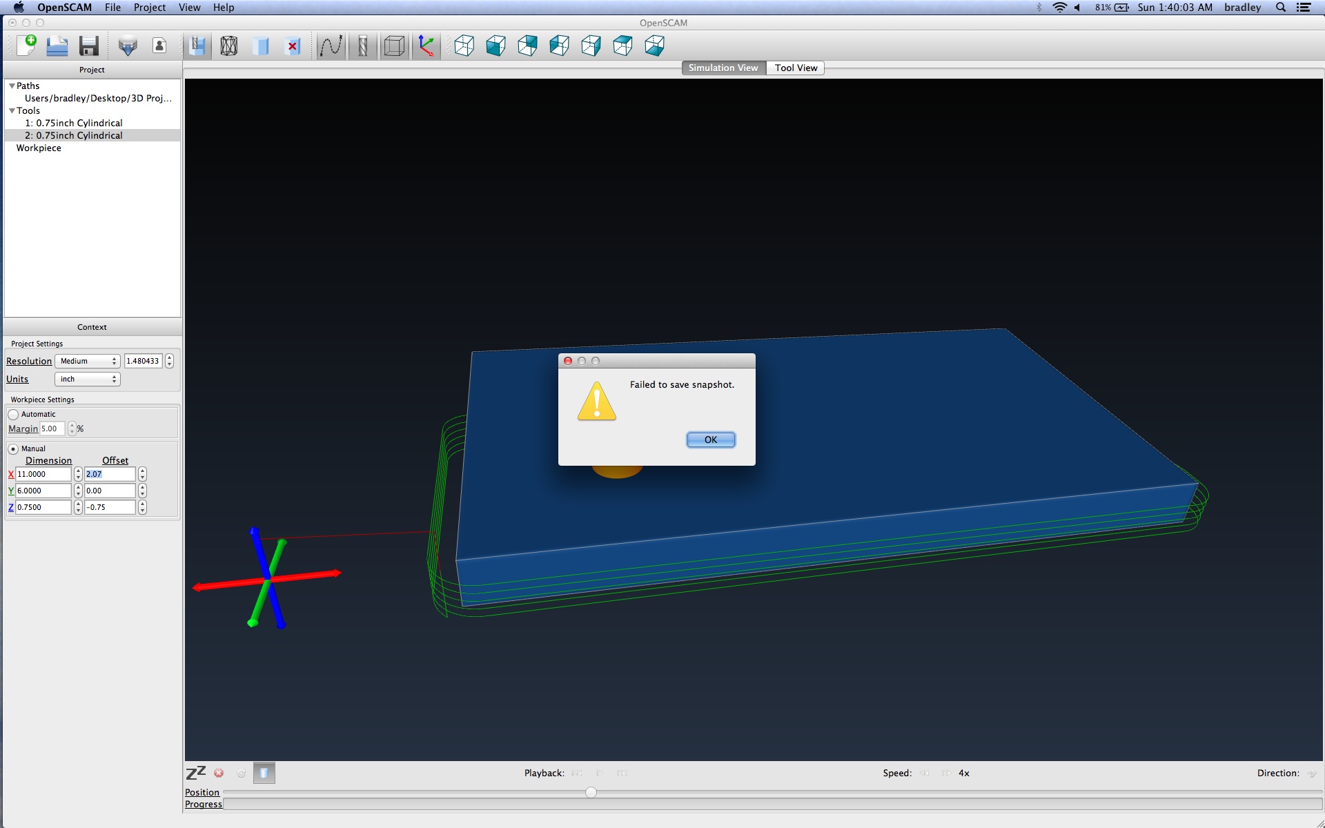

How do I correlate the movement in the simulation with a specific line of gcode? In other words, if I identify a problem through your program, how do I find that line?
I got it to "think" in inches by adding G30....It does seem to fight every step by defaulting back to mm. I don't think adding a G30 should be considered the long term fix. Only a workaround. By selecting inches in the program, it should always start assuming everything is in inches. IE, selecting "inches" in OpenSCAM should be the equivalent of issuing a G30. Not all post processors add in a G30. Mine doesn't. LinuxCNC already knows my mills operate in inches, so the G30 is redundant.
A user interface suggestion: change the color of the playback, speed, and direction buttons. They are light gray on a background of darker gray. I can barely see them.
Things to note: the built in snapshot isn't working on OS X. The simulation doesn't actually cut through the material...The tool just goes through it like a ghost. I've attached a screen shot.
I'm glad to see an OS X version and I look forward to how it progresses. It looks promising.

I see your point about mm/in. Dont you mean G20 though. G30 means go to a predefined position. G20 is imperial measurement mode.
I'll try to find some better icons.
I think you might be confusing the way OpenSCAM currently works. It does not yet do real-time simulation. i.e. it wont show you the cuts as they happen. However, it can simulate the process at any point if you set the tool to the desired position and rerun the simulation. If you do one of these "partial simulations" and then move the tool position, then the tool moving through like a ghost, as you say, is the expected behaviour. I don't think this is something special about the OSX release.

Re: finding the line number of a move. If you enable the Machine State dock it shows the line number of the current tool position.
You might want to check out the user's manual: openscam.org/manual.html
