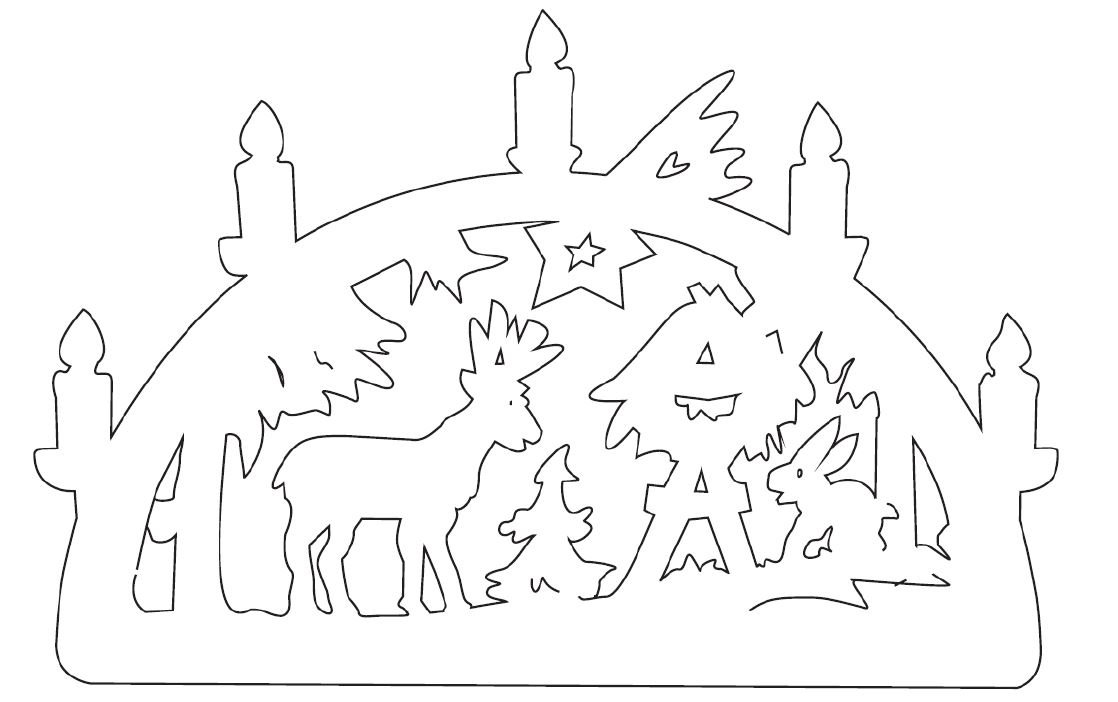

image to dxf
- seppel
- Posts: 18
25 Aug 2013 16:50 #38058
by seppel
image to dxf was created by seppel
- cncbasher
- Posts: 1744
- Thank you received: 288
25 Aug 2013 17:18 - 25 Aug 2013 17:46 #38061
by cncbasher
Replied by cncbasher on topic image to dxf
yes you can , use such programs as scan2cad , wintopo , theirs also extensions available for Inkscape
that will take it directly to gcode ... see gcodetools plugin http;//www.cnc-club.ru/forum/viewtopic.php?f=15&p=101
for a tip dont use JPG as image format , best to use TIFF and is in black and white , no greys .
