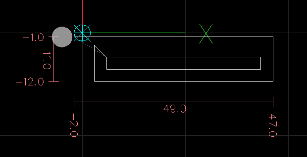

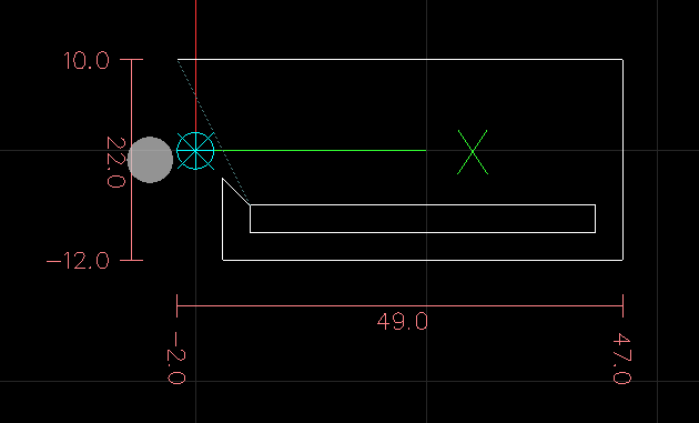

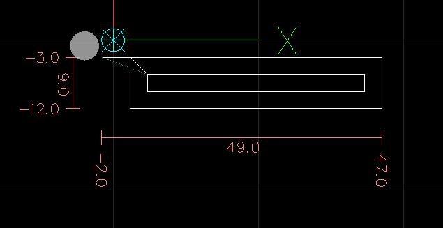

Checked 1.7.04. Export to Axis and save to file works perfectly.
Step over issue:
I enter:
The work piece rear edge is positioned at Y0.0mm
The first horizontal cut will be made at Y-3.0mm
With a tool radius = 2.0mm, the cut area will then range from Y-1.0 to Y-5.0, leaving the first mm from the edge untouched, right..?
The left, right and bottom edges will also be cut, leaving 1mm along the outside uncut in the same way.
I expext:
With a 4mm tool and 75% step over, the tool should cut 3mm into the material in each move. So to me that means the first move should be from X-2.0 Y-1.0 to X49 Y-1.0, and so on.
I assume:
X and Y Length corresponds to the size of my work piece to be cut.
I have to admit that I am a complete newbie in CNC and CAM processing and have a lot to learn, so I might very well be completely lost here. But I really believed I had a fairly good grasp of this...
Step over issue:
I enter:
- Tool Diameter: 4mm
- Step over: 75% (or empty)
- X Length: 50mm
- Y Length: 15mm
- X Reference: 0
- Y Reference: 0
- X Start: (empty)
- Y Start: (empty)
I expext:
I assume:
