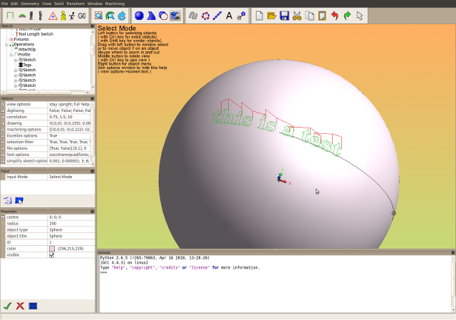

Thank you so much for doing this. I've been using the HeeksCNC implemented version of your software and I am very impressed.
Dan Heeks also set up the 'Attach' machining operation to your libs and now we have some really interesting options for machining surfaces and machining on surfaces.

Hi Dan F,
It's nice to see that someone actually uses OCL. The foam spider on your blog may have been the very first part anyone has ever cut with this code!
Once the basic routines for cutter-location (drop-cutter which is done, and push-cutter which I am working on slowly) are done, as well as offsetting and a few other things are in place I think there is potential for a lot of different things. For hacking, the closer you can go and take a peek at the low-level functions in the python-code the better.
I've really only been visualizing things with VTK so far, but as heeksCNC improves I might switch to developing OCL under it.
Ofcourse OCL is not tied to HeeksCNC and anyone could come up with another GUI if they wanted (Coin3D, VTK, etc. etc.)
I am very slowly working on a lathe project, and if/when that machine starts making chips later this year then I will take a look at 2D lathe operations. These should not be so different from the 2D offset or waterline ideas/algorithms which are needed for 3-axis milling anyway.
Anders

Hi Anders,
I think it was Brad (sliptonic on IRC) that did the spider. He's got a cnc router set up for doing a lot of fun wood projects for his family and friends. That's one of the things that I love about this sort of thing- you can amaze your family and friends with awesome work.
I see your code unleashing a wave of creativity that hasn't been seen before in the open source cadcam world. I know that it could be used for all sorts of things- guitar parts, surfboards, jewelry...
I especially like the fact that you and Dan Heeks are working together on this. Dan's 'Attach' machining operation is especially powerful in combination with your code.
Thanks for all the hard work with this.
