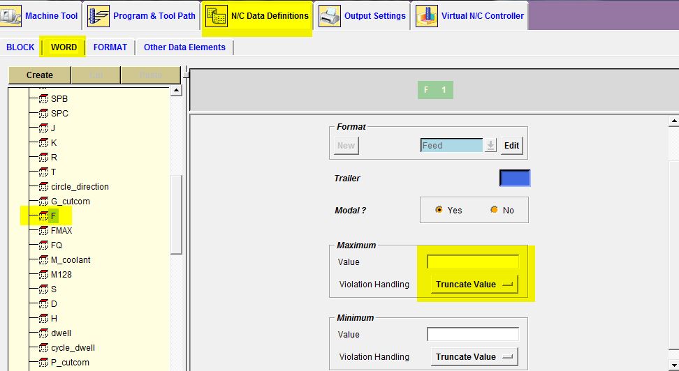

21 Jan 2016 16:53 #68887 by speedwizard
Replied by speedwizard on topic Siemens NX Postbuilder
Hi all,
it's my first post and even this is an old thread the answer would be interesting for everyone working with Siemens NX Postbuilder:
Feedrate limiting in Postbuilder is machine specific and surely can be changed:
Just go to the N/C DATA Definitions Tab, choose WORD on the left side, search for your Feed-Word e.g. F and change maximum value to nothing. Have a look at the attached file. If there is a maximum feed value, violation handling set to "Truncate Value" will reduce any feed value > maximum value to maximum value.
Hope this helps, Thorsten
21 Jan 2016 17:03 #68888 by speedwizard
Hi all,
this is my first post and even if it is an old thread it may be interesting for everyone who uses Siemens NX Postbuilder.
Feed limiting is machine specific and surely can be changed:
Go to the "N/C Data Definitions" Tab, choose "WORD" on the left side and search for the feed Word e.g. F. Set the maximum value to 20000 or what ever you want. "Violation handling" set to "Truncate Value" will truncate all feeds > maximum to maximum.
