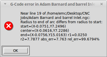

I am going up the wall here. I have days invested in making some tool paths.
I am getting inconsistent results, see the attached screen shot. I will get some things sorted out and then get one of these, fiddle and nopt really change anything and it goes away.
Any ideas?
By the way Ctl-K doesn't work to clear the screen.
Any ideas?

Are you using cutter compensation? I have similar problems when I try to use cutter compensation. Although I'm not certain the problem is with the Fusion 360 post, I get errors if I manually write g-code with cutter compensation and use a radius that is too small, or if the lead in move isn't long enough.
- Thank you received: 4654
31 Mar 2016 10:16 #72449
Can you show us the first 25 lines or so of the G-code?
Which post-processor are you using?
Fusion may or may not understand G91.1 (Inventor inserts it but then their G-code editor/previewer gets really confused, seeing it as a G91)
Replied by andypugh on topic Problems with either Fusion360 or Linuxcnc
try Ctrl-SpaceBy the way Ctl-K doesn't work to clear the screen.

Hers is the code, it does use G91.1 The code combined 5 operations so I am going to post each one to figure out which has the problem, about 3125 lines all together. Using the EMC post in fusion.

Line 19 seems to be in the (POCKET1) operation.
I have to assume that the problem move is off the end of the G-code you posted, as there is no move to Y7.2496 in the code.
(unless, as a bizarre possibiility, you have X / Y offsets in the tool table?)
