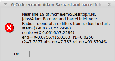

I am having a similar issues to another post with Fusion 360 and my lcnc equipped lathe. I get the alarm/ warning in the picture, which I nicked from the other post .When I switched from I/k arc centers to "r" , the issues went away. I tried all three fanucish posts with the same results. I'm not using TNC .Suggestions. Thanks.

Can we see the g-code that is causing the error?

this gets an arc endpoint error at the line with G18 G3 similar to the screen shot above. Every place in the program there is a chamfer, , the software generates arcs and errors with I/K radius designations.

I have not had this issue with other cam systems, so i suspect the post in Fusion. Thanks ahead of time
