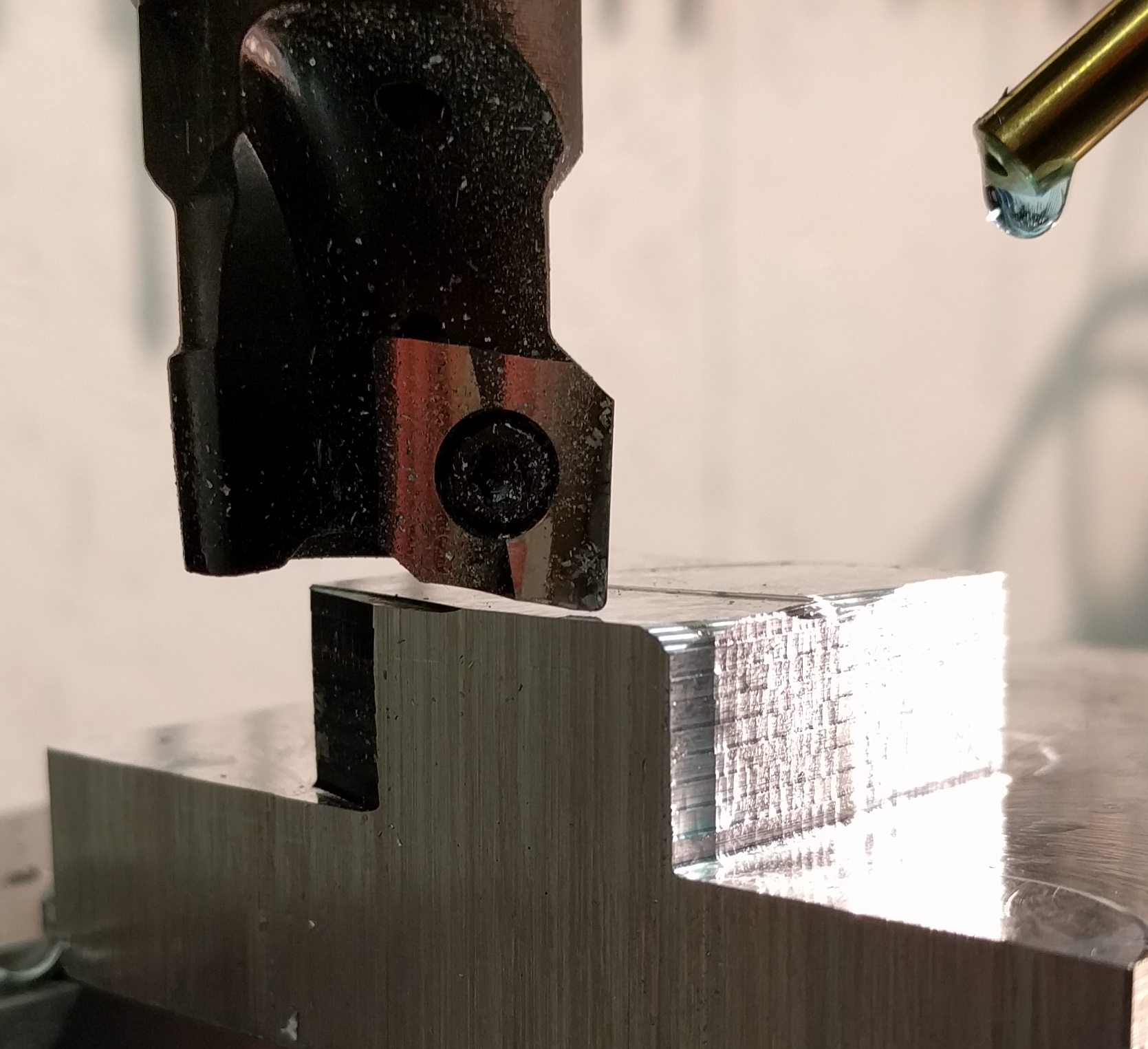

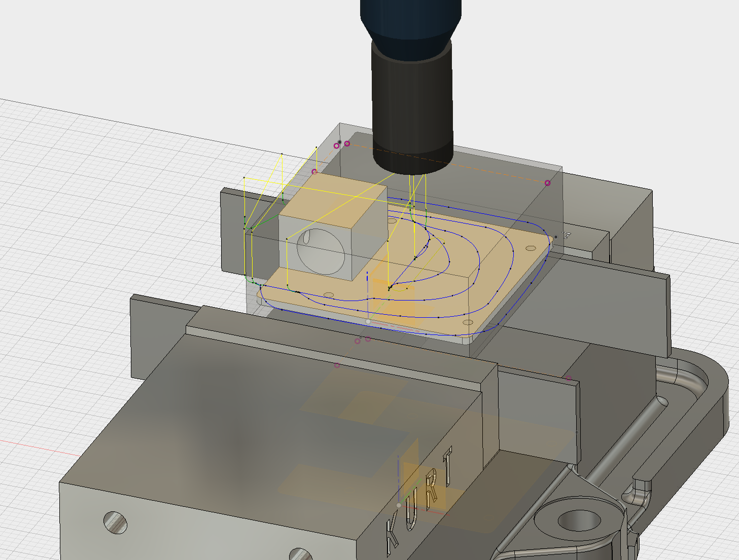

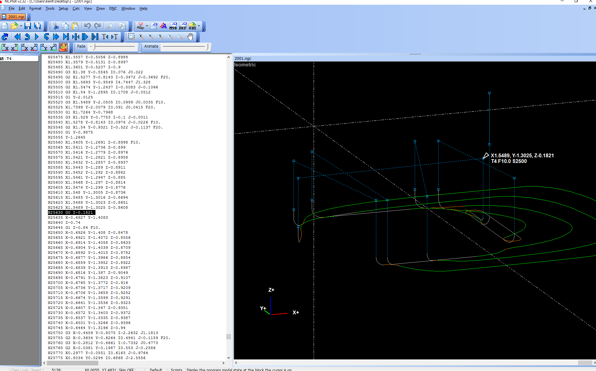

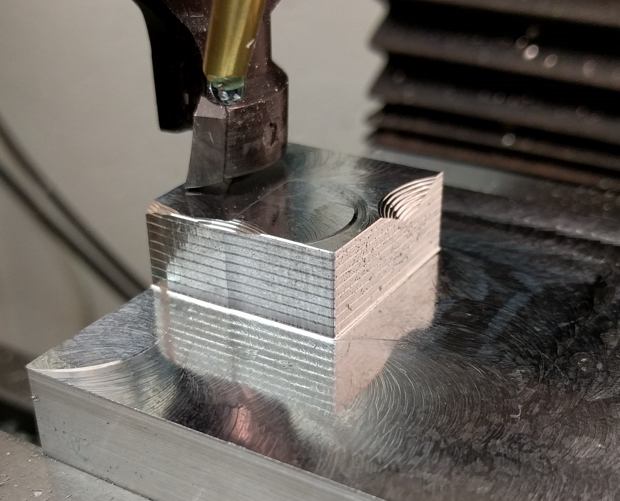

Hi, I'm using Fusion360 Adaptive Cleaning to create mill CAM code for LinuxCNC 2.7.4. I select the "linuxcnc.cps (Generic LinuxCNC (EMC2))" post configuration. I'm encountering a problem that retracts along Z do not retract before movement along X-Y begins, and the part gets clipped by the cutter.
I've attached a couple of pictures showing that the tool gets above the work piece, but clips the part along the way. Also, a screenshot of the section of g-code in the Fusion360 simulator and in NCPlot.
The section is
N25550 G1 Y-0.9875
N25630 G0 Z-0.1821
N25635 X-0.6927 Y-1.4083
N25640 Z-0.74
With this code, should the tool rapid to Z-0.1821 and only after reaching Z-0.1821, rapid to X-0.6927 Y-1.4083? I probably have something not set right. I've not been able to find a similar question online but I may be searching with incorrect terms. This is problem a common problem others have encountered and someone will know immediately what's wrong.
If needed, I can post a short video of the tool clipping the part. Slowing the clip down, the tool appears to be decelerating, but not fully stopped before moving along X-Y.

Fusion knows nothing about the limitations of your machine and/or LinuxCNC.
LinuxCNC (unless told not to) will tend to cut corners in situations where the max velocity is relatively high and the acceleration is relatively low. You can adjust this to suit your needs with G61, G61.1 and G64 linuxcnc.org/docs/2.7/html/gcode/g-code.html#gcode:g61-g61.1
But you might want to take a look at your acceleration settings in the INI. Were they guesses or based on data? Accelleration and velocity should both be as high as possible for the machine for best performance.
The simple fix might be to just raise the retract heights in Fusion.

Thank you Andy. I'm sorry if mine was a frequent question. Shortly after posting my question, I found G61, and that stopped the behavior, though perhaps not ideally. My mill is simply a small desktop conversion, that I run conservatively slow. I'll follow your advice and look into the acceleration settings, trajectory planning, and the rest. While this all makes sense, it also shows there is so much to learn, and that most of what I don't know, I don't know. I used Mach3 in the past. Making use of the sophistication of LinuxCNC is rewarding, and while it can be challenging, so far it's not been frustrating
