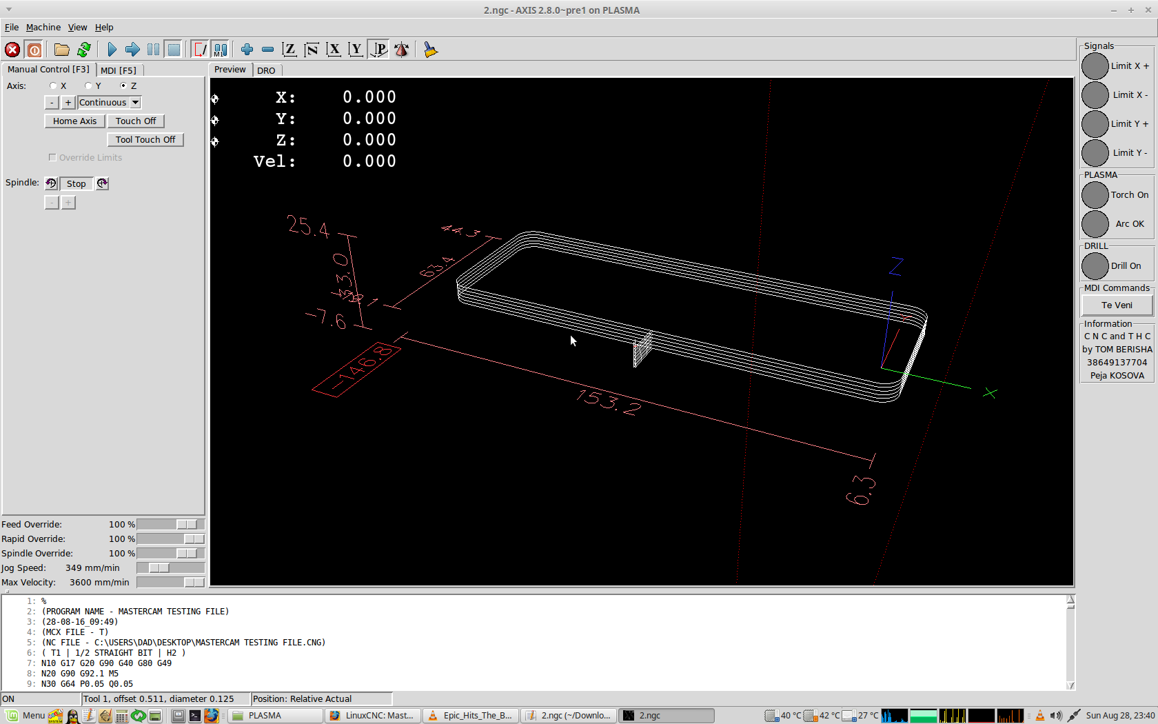

I do not know if it would matter in that machine, but mine would not run it as it travels at -150mm on X axis ( 6 inches).
Everything else seems OK
The negative limit on my machines is always set at 30 to 50mm, never more, except Z axis as that works in negative.
Here is a screen shot,

Thank you, Tom. Getting it to read the code without errors is half the battle without trying to run it. If my lead in and out were smaller, and on the -Y- side, it might have helped you. Thank you again for your time and efforts.
