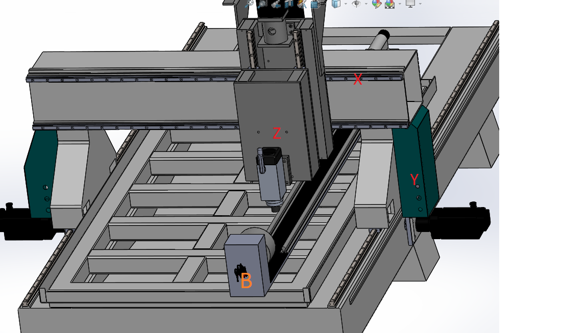

14 Sep 2018 18:03 - 14 Sep 2018 21:47 #117550
by Marcodi
Replied by Marcodi on topic Camworks - virtual machine and postpro
Ok, indeed deleting the entire line did work, i can't see how i didn't try this one before. Thanks a lot. So that is fixed. leaves me with question number 2 , where is the name of the axis actually set?
Secondly I cant seem to change the letter of the axis from A to B . I set it as B in the upg and for drilling commands I get B but for this wrapped thing it remains A and only if I leave that first line.
Thx
Thx
Last edit: 14 Sep 2018 21:47 by Marcodi. Reason: adding picture of machine

14 Sep 2018 21:39 - 14 Sep 2018 21:50 #117558
by Marcodi
Well i have been trying for a couple of hours now again.
I just can not find how to do wrapped features ( the only feature i should use for a rotary on the bed with a gantry machine so it seems ) and to change the postprocessor to set all rotary axis labels as B axis.
Whatever i do or look at the wrapped features are set as A axis coordinates, i need this to change to B axis as my axis on the machine is a B axis ( don't ask me to change that, i have a rotary on the head aswell and that is set to A, as a sidenote )
i attach the file i am using aswell as src and lib. Please some help, i just don't find it where i can change this, it seems such a simple thing but it really isn't.
(Apart from this issue, the postprocessor seems to be working quite fine in linuxcnc, i am testing everything on a vismach sim setup and all axis seem to be moving exactly as it is supposed too. For someone with an A axis setup, this postprocessor seems to be in progress of finishing, i hope i can finish it and post it here for everyone with a rotary to use.)
thx
