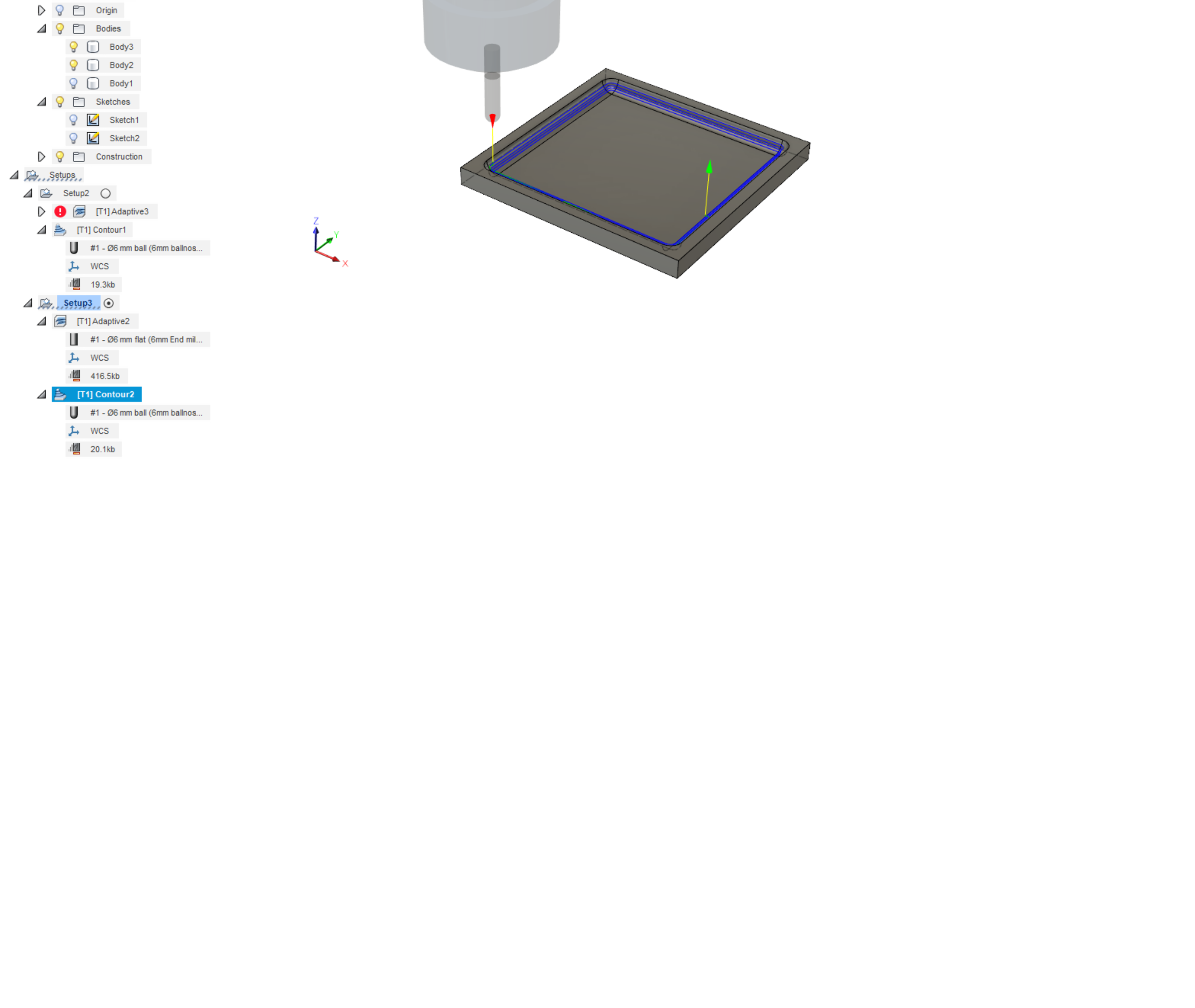

So I am trying to get Fusion 360 drawn piece to work on Linuxcnc and partially failing. The first run an adaptive clearing works fine. I then expect the spindle to wait for me to change the 3 flute roughing end mill to a ball nose for the second operation, this doesnt seem to occur. I have no idea what I am doing wrong.
The one of interest is setup3. setup3 is my second go setup 2 didnt work either just a bigger piece which took too long.
What info do you need to help me? the f3d file? ngc file?

Hi, You have both tools set to tool #1. Change your finishing tool to another number and you will be good to go. Cheers Matt

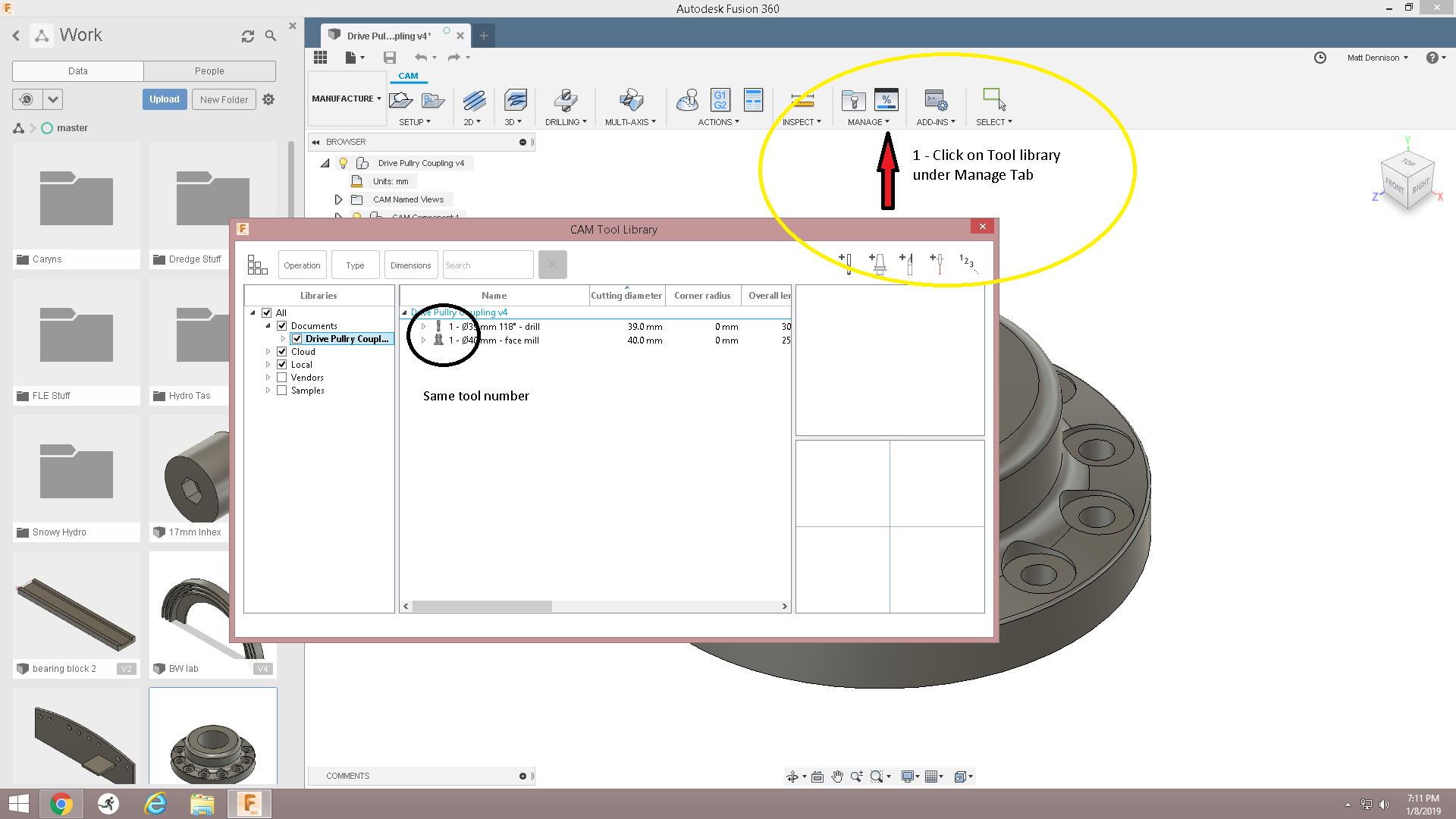

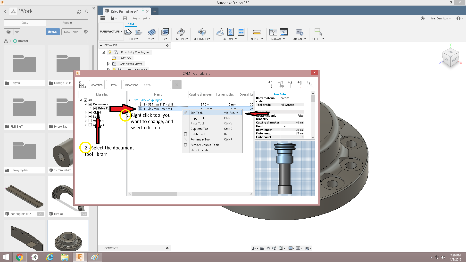

Will give you a quick run down if your unsure on how to change it (or for anyone else who isn't sure). While using cam workspace, click on Manage, And select "Tool Library". In the Libraries Field (left hand side), click on the document name you are working on. Your tools will be displayed. Right click and select "edit tool" on the tool you want to change number (2nd tool in list). Go to post processor tab and change the tool number in the top box to "2", the numbers under will change automatically. Click Ok, you will want to check your feeds and speeds, as you can choose to override the previous data or not. After you check your feeds and speeds, you are ready to re-post the G-code and start machining.Hopefully i havnt forgotten anything. Hope this helps. Cheers Matt

Got the pics in the wrong order. The circles have numbers to follow in the pics. You mat already know this, but i thought it might help anyone who doesnt.
