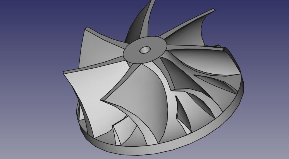

hi
i decided to make a Quick speed advice on how to get a turbine modeld in FreeCAD
with Sweep Blade
with Sweep Blade

15 Oct 2019 00:00 #147904
Replied by tommylight on topic Impellar Turbine made in FreeCAD
Is there a usable CAM module for FreeCad ?
Nice tutorial, thank you.

15 Oct 2019 03:02 #147911
Replied by Todd Zuercher on topic Impellar Turbine made in FreeCAD
Yes, I have used it to produce g-code for a machine a couple of times. But I am far from proficient at using it.

15 Oct 2019 07:18 #147919
by phillc54
Sliptonic has several videos www.youtube.com/user/sliptonic/videos
I have used it for milling and like everything there is a learning curve.
Replied by phillc54 on topic Impellar Turbine made in FreeCAD
This is an intro www.freecadweb.org/wiki/Path_WorkbenchIs there a usable CAM module for FreeCad ?

13 Nov 2019 18:35 #150318
by ikkuh
Replied by ikkuh on topic Impellar Turbine made in FreeCAD
Yes, the Path workbench is a 3 axis cam generator. It works a lot like Fusion, not the very fine control that Fusion offers though.
There is a LinuxCNC post processor and it generates good code, it works on my homemade machine with almost no problems.
Path workbench:
