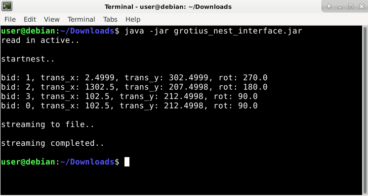

2. After input file is ready, you have to execute : "java -jar grotius_nest_interface.jar".
- This can be done easy by a script.
3. Output file is "nest.out.txt" + "ready.txt"

Terminal output:

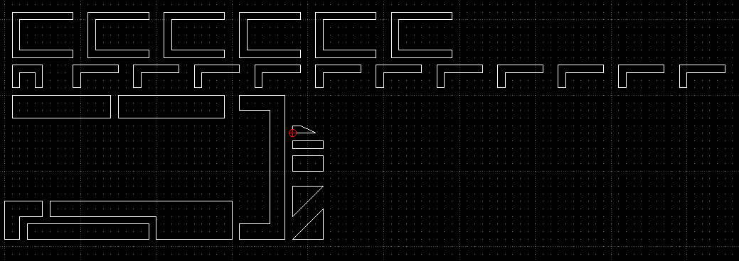

Nesting input :

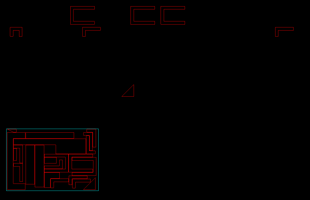

In the nesting output the plate is 3050x2030mm. See cyan colered line.
Items that not fit, are left untouched. This is a startpoint for a new plate nest routine.
Nesting output :
For the rotation parameter output, this is how to calculate the new contour coordinates, on github the information is giving wrong.

Nesting input :
Nesting output :
