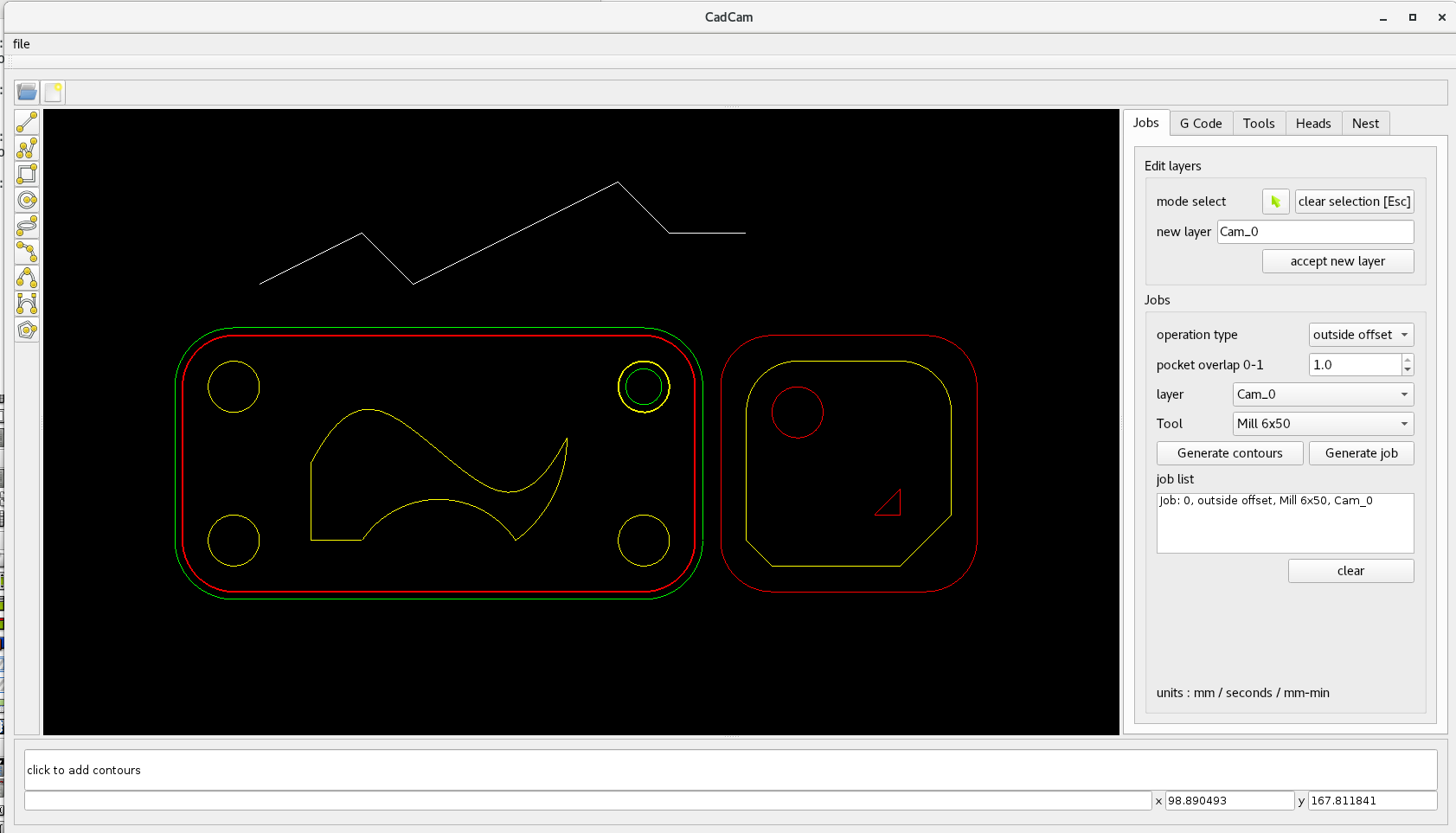

To test with linuxcnc : free cadcam software
No additional installation required. It's just a appimage that works from anywhere, like a usb flash drive.
- Currently for testing cam path's output.
- Dxf test file included.
- Can import inkscape + librecad dxf's.
- Outputs gcode
- Todo : keep parts together, etc.

29 Jul 2020 04:13 #176334 by Reinhard
Replied by Reinhard on topic free CadCam software tryout
very nice work and nice to offer an early test :)
First of all I miss a slider between drawing area and config notebook. I have plenty space on desktop so resizing app is no issue. But notebook stays too small, so that texts are cutted (see next picture).
I just played around with your testfile.

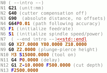

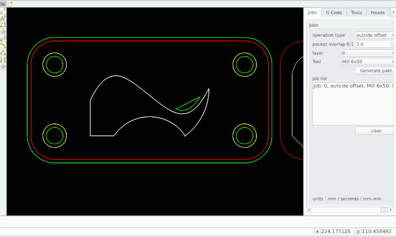

Using operation type "outside offset" leads to this picture:

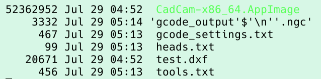

Then I used "generate and save Gcode" which leads to these file entries:
Looking at the saved GCode, ...
I just realized, that "<<std::endl" is in the intro textbox already, so I could have deleted it before file generation ...
nice option that intro textbox. I think G80 should be part of the default too.
I think, stopping spindle at cut-depth is not a good idea, especially if M5 is the only command in a line. Motion will wait until the spindle is stopped, which could result in ugly artefacts. Better put M5 after "G0 Z10", which starts retiring tool and stops spindle during motion.
Then a lot of space could be saved with unneeded output. Unchanged coordinates don't need to be mentioned in following motion commands and G4 P0 is a big nothing too.
... any way: trying operation type "pocket" on layer "pocket" leads to an endless loop, where I had to kill application.

29 Jul 2020 16:24 - 29 Jul 2020 19:41 #176398 by Grotius
Replied by Grotius on topic free CadCam software tryout
Updates:
1. Tooldelay appears only in the gcode if tooldelay > 0.
2. For milling and drilling the M5 is at safe height. For plasma and oxyfuel the M5 it at cutheight.
3. Added G80 to intro.
4. Added sliders to window.
5. Removed the "std::endl" from the generated intro.
6. Added open contour path's.
7. Repaired gcode filename output, nextline '\n' sign removed, at next release.
Updated CadCam program :

@Reinhard,
Thank you for your comments.
So I think, it would be better for your app, if you allow the user to select a shape. Then the user could select inside or outside - probably less work for you and better result, as you can't foresee any possible situations.
This selection model, we do in the near future, and is quite easy to do.
First i need to implement the "keep parts together" as it is more important now.

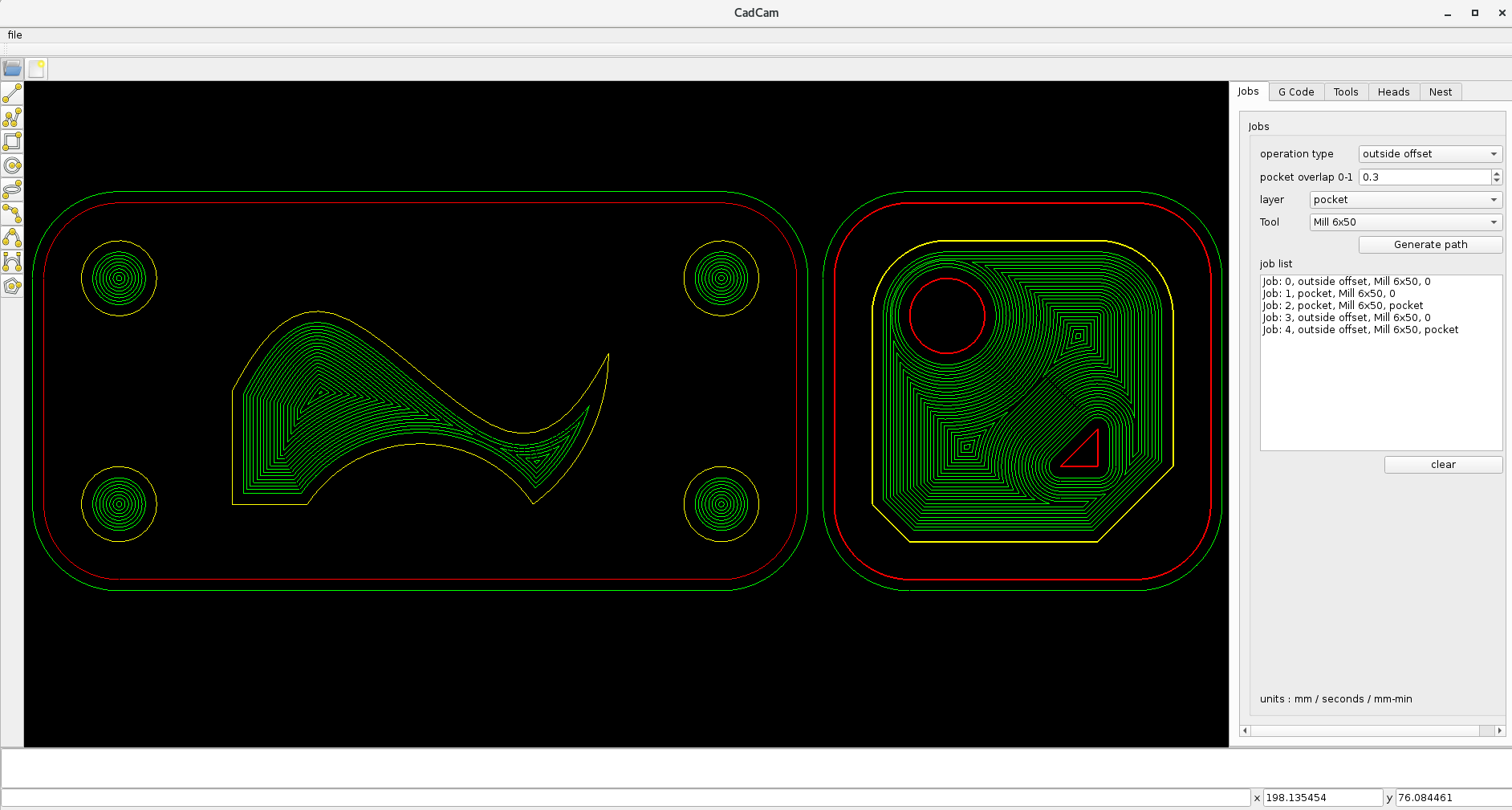

Strange, for the pocket operation. Try to draw two rectangular shapes in each other and do the pocket operation.
For info : The pocket needs to have a yellow outside color at this moment (ccw direction). Later on, it will be programmed that a red outside color is also possible.
I see i have to integrate the ellipse offset's for a pocket.

The pocket result :

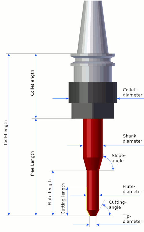

I had a closer look at the tool definition tab ...
You should distinct between tool properties (like tool diameter) and job properties like travel height, feed rate and all others.
Here's a sample of tool-properties from another cam (which checks collision and the like):
So all properties from your "Tools"-tab below "Name edit" are job-properties (except tool diameter). And Job-properties should be changed for each job ...
... or save presettings for different materials ...

... and if you recall the first picture from my first test:
May be, I want to cut the outline of the workpiece with a different tool then the insides of the holes. Therefore it is evident to limit toolpath generation.

31 Jul 2020 18:13 - 31 Jul 2020 20:45 #176688 by Grotius
I split my post up in two.
First here is a updated Cadcam program to download :
github.com/grotius-cnc/QT_CadCam_rev0/releases/tag/v1.1
Update includes :

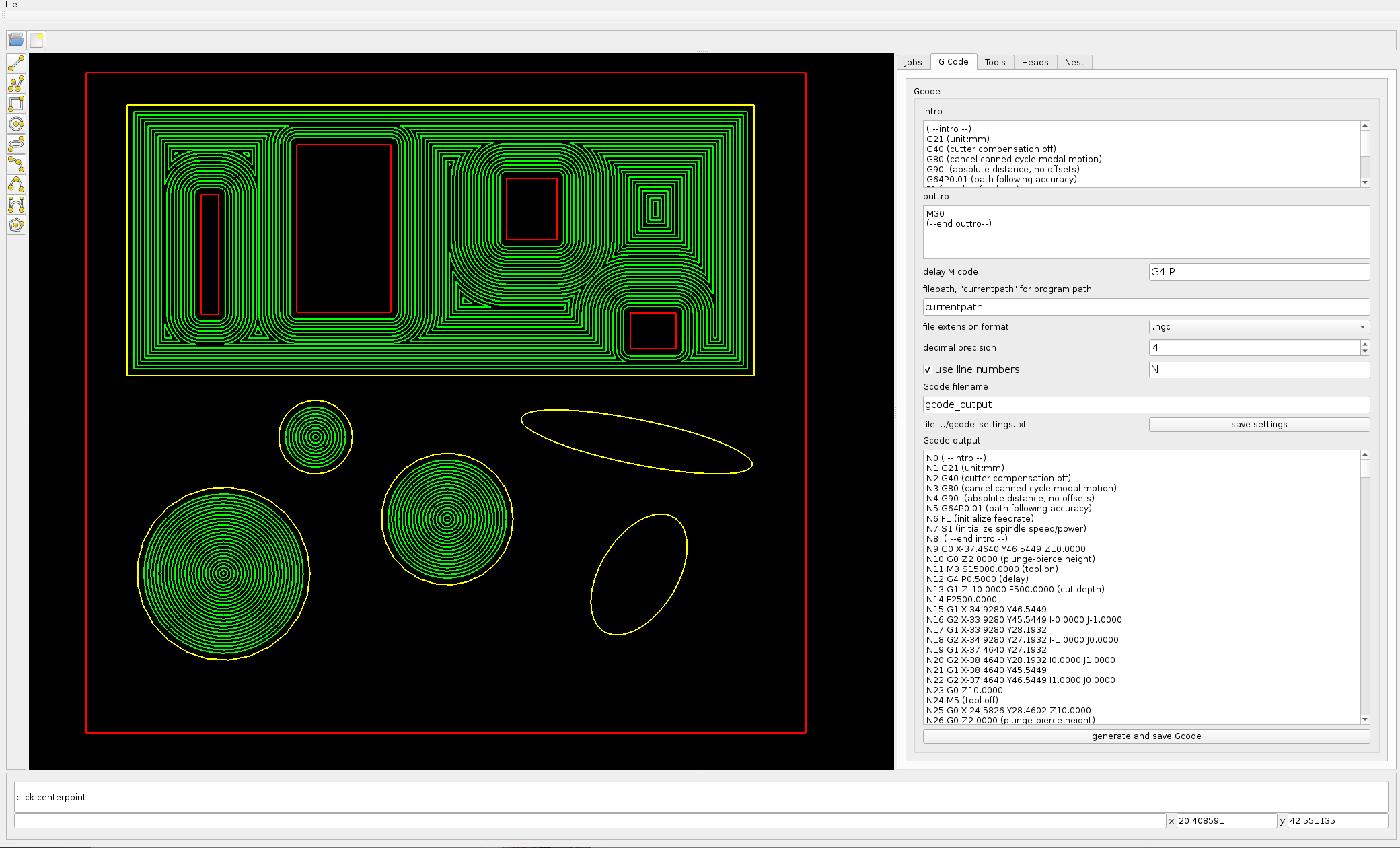

1.Contour selection by mouse, to select specific contours by user. Morpf contours into new layers that can be used for jobs.
2.Repaired file output name by deleting '\n' sign in filename.
3.Tooldelay only appears in gcode when tooldelay>0.
4.Added G80 to gcode intro.
5.Added sliders to window, users now can adjust parts of the screen layout.
6.Added open contour path's to contour class and gcode output.
7.Removed the "std::endl" from the generated intro.
8.For milling and drilling the M5 is at safe height. For plasma and oxyfuel the M5 it at cutheight.
And a version with above updates and autonesting enabled :
github.com/grotius-cnc/QT_CadCam_rev0/releases/tag/cadcam.v1.2
** had to solve a java issue first. Downgraded the java compiler to JDK1.8 to be compatible with opensource java
that lives on standard linux systems. This to avoid that users have to update java first.
Example of contour selection by mouse, wich result in a layer edit. User has selected one contour + one hole to cut
in this example.
You need to mention that red=cw, yellow is ccw contour.
You have to practice a little bit to understand a yellow outside offset is going
to be a inside offset.
Will bring back feedrate, cut depth, rpm etc to the job page and keep the current tool page as is.
This is now possible. User can select contours by mouse click and do specific jobs for the selected contours !
