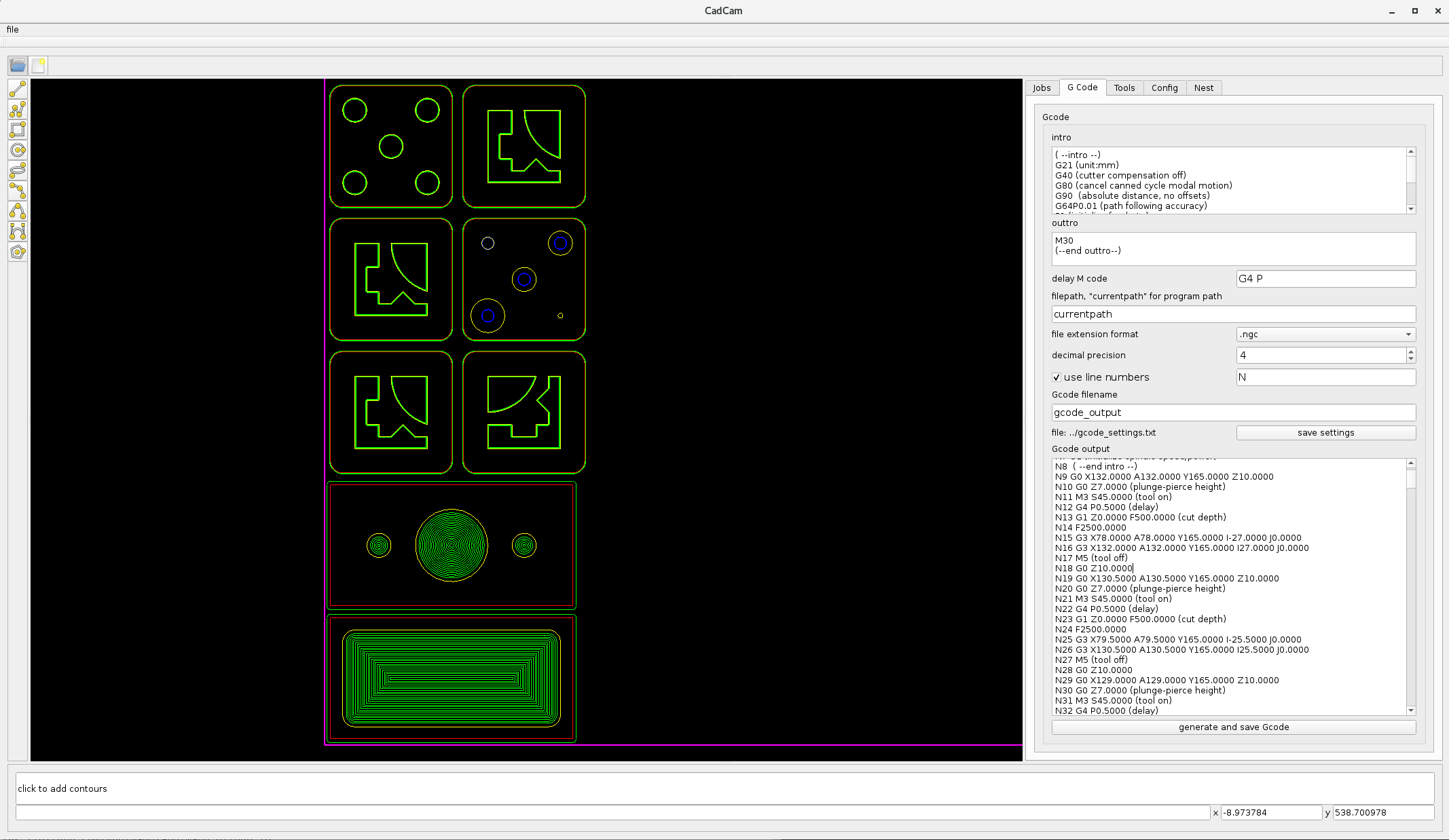

Hi Reinhard,
Yes, I wrote a replacement for axis
Respect !! A few day's ago i went trough your github code a little bit.
I was curious. A few weeks ago i did my first Java program with Netbeans. It's used for autonesting. So i can do a very little bit
of java at the moment.
In your source code. Can you point me to the location where you send the linux nml commands. I want to test if i can do the same with c++. Maybe you can give me some advice where to start to save time. And works it without a linux rip install?
Thanks in advanche.
The purpose of all of this is to provide a Qt c++ template interface for linuxcnc.
This would be usefull for students and some programmers around here. Maybe i can provide some ethercat based example's with it.
Added slave axis support today for x,y,z, this for windows mach3 users
github.com/grotius-cnc/QT_CadCam_rev0/releases

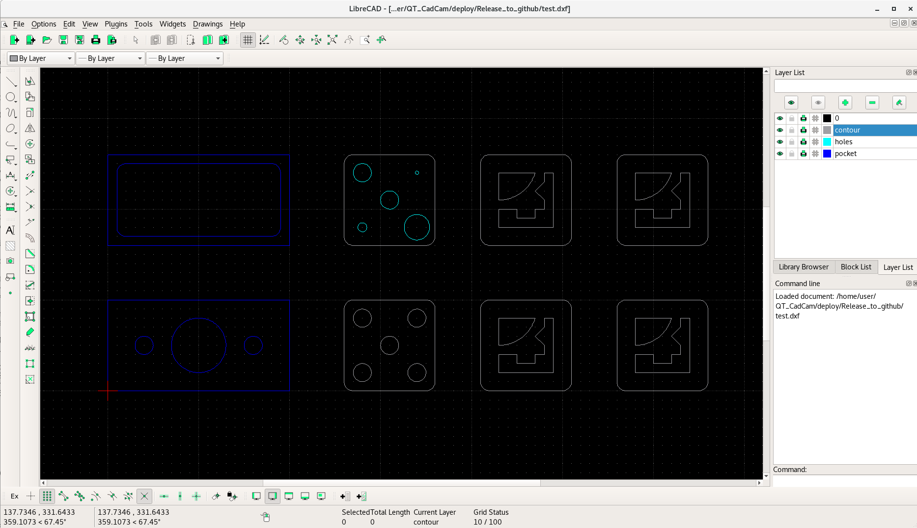

sample of dxf drawing in librecad :
sample after autonesting, and jobs for : pocket milling, drill hole's (blue) and plasma contour cut.
Thanks in advanche.
