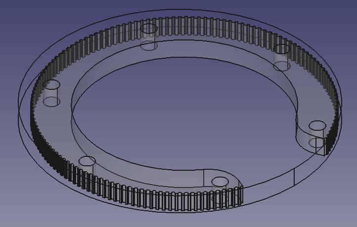

My mill is very nearly done so I foolishly offered to do a 'small' project for my daughter's boyfriend as a thank you for getting a very old engine running... Part of that gift is a GT2 gear in the shape of a 'C' (see attached screenshot - I haven't uploaded the FCStd because it's a small cog in a larger project but I can recreate it if need be).
My cunning plan for my first(!) Path job for the teeth was the following:
1. Drill ~ 150 2mm holes around the circumference
2. End mill (5mm) to within 0.1mm of the circumference
3. End mill (2mm) to clean up and put the 'fillet' on the teeth
Feel free to tell me if this is not a reasonable approach, but I'm struggling with step 1* - I cannot select the 2mm inner radius of the teeth for a drilling operation. I tested this with a slot in another part and was able to select the end(s) of the slot for drilling, so is this possible on what is effectively an un-closed 'slot'? Or rather, 150 of them (will I have to select them individually?).
My workaround would be to create a dummy model just with the holes but that feels like cheating.
Any thoughts and advice would be welcome.
* I will probably also struggle with steps 2 & 3 when I get to them...
PS, I couldn't find a 'Path' category - would there be any mileage in separating some workbenches?
