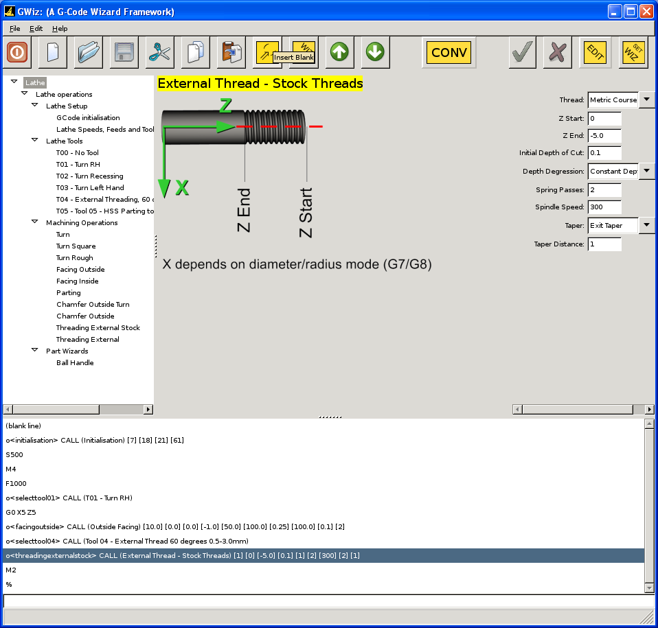

I've started playing with Kenneth Lerman's GWiz (wiki.linuxcnc.org/cgi-bin/emcinfo.pl?GWi...ode_Wizard_Framework). My lathe was down and while waiting for parts, I created some wizards. I've attached a screen shot.
I haven't actually used them yet. I'm a little unsure what I want from them. You can use individual wizards, or you can build a sequence of them and suddenly it's a conversational programming application.
But, I usually draw up my parts in 3D CAD (alibre) first, and I really miss the verification a visual model gives.
