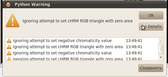

Is there any other messages? That message looks like a warning not an error. Actually, googling the message shows it is only a warning. It has to do with a .png image being loaded. Are you customising GWiz?
