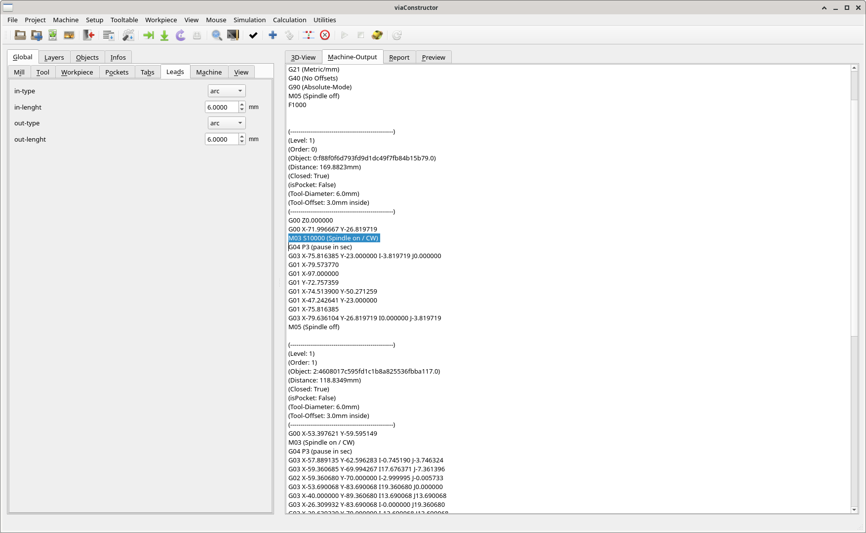

for 2.5D you can try github.com/multigcs/viaconstructor/

Replied by Hakan on topic Best cam software to use for plasma cutting
Can it also do g-code for plasma cutting?

Replied by meister on topic Best cam software to use for plasma cutting
Don't have plasma and can't say what is needed, but if you tell me what is missing I can expand itCan it also do g-code for plasma cutting?

Replied by tommylight on topic Best cam software to use for plasma cutting
M3 and plasmac feed rate at the start of every cutAnd M5 at the end of every cut.
Also simple nesting or just ability to change the order of cuts would be nice to have.
And lead in and lead out with the option of no lead out.
F#<_hal[plasmac.cut-feed-rate]>
M03 $0 S1(turn on plasma)Also simple nesting or just ability to change the order of cuts would be nice to have.
