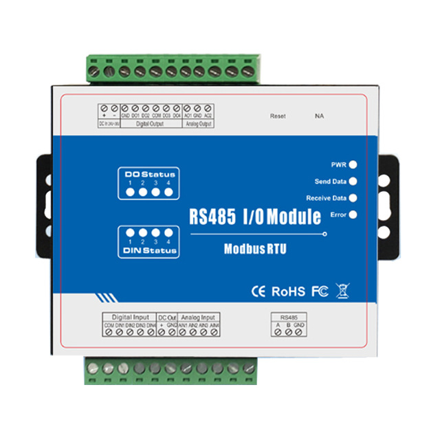

This document can save you time. It is for integrating in custom linux applications.
For the device on the picture all basic function's are working.
Tested on linuxcnc 2.8 with debian 64bit stretch with builbot reprository set for update to master :
deb buildbot.linuxcnc.org/ stretch master-rtpreempt
With package manager install module : pymodbus
In some linuxcnc versions you have to be member of usergroup plugdevs and serial to get sudo acces to read i/o.
How to become a member of those groups, is a matter of googling. In linux mint it is very easy to select this groups.
ali shop : modbus rtu module
