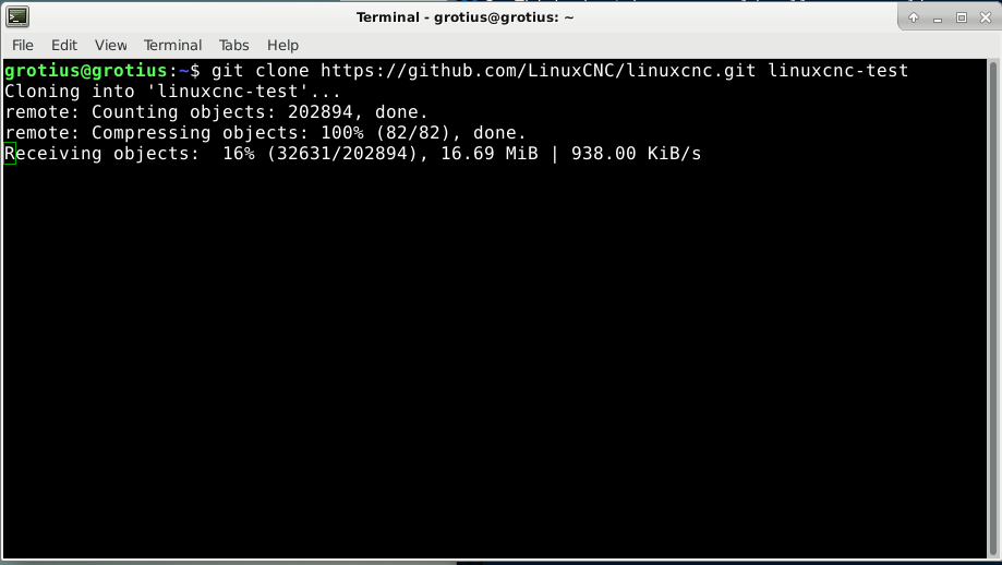

3. Download linuxcnc
This would be your standard if it is your first linuxcnc installation on ubuntu, mint, etc.
Type in terminal :
git clone h*t*t*p*s://github.com/LinuxCNC/linuxcnc.git linuxcnc-dev
I would prefer to start with debian 9.... 64 bit. Very very good. www.linuxcnc.org/testing-stretch-rtpreempt/
For example is you want to change your directory name into "linuxcnc-test" you type :
Type in terminal :
git clone h*t*t*p*s://github.com/LinuxCNC/linuxcnc.git linuxcnc-test

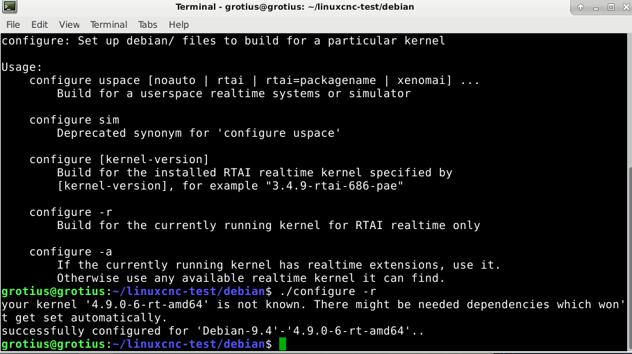

5. Configure
In your linuxcnc target directory cd to the debian directory :
you@you:~/linuxcnc-test/debian
Type :
./configure
#### Picture configure kernel ####
Okey if you want to build linuxcnc for currently used kernel use -r so we type again with -r:
./configure -r

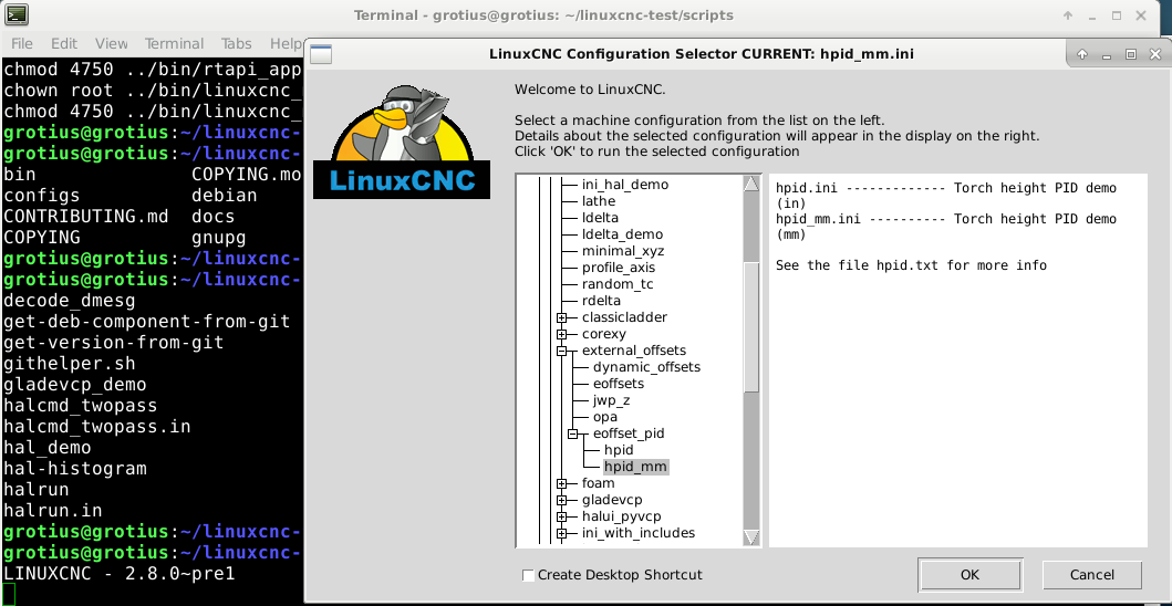

9. Rip environment
If you have more then one version of linuxcnc running on 1pc. You want to select the version
you want to use. How to do that? The solution is type in the directory : scripts/
. ./rip-environment
linuxcnc
#### picture rip-environment ####
#### picture external offset linux startup ####
