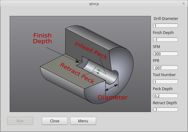

08 Jun 2019 18:20 #136303
by partec
Replied by partec on topic rem em ber - in Document QTvcp Development 5.6. Dialogs
this looks absolutely going to a perfect direction, thank you Chris, I think I have to prepare some input pictures for flat grinding needs!
- Posts: 7361
- Thank you received: 2173
08 Jun 2019 18:50 #136304
Replied by cmorley on topic rem em ber - in Document QTvcp Development 5.6. Dialogs
Currently the macro menu uses svg image files so one file can hold all needed images and it can be resized easily. I used inkscape.
If there are many different macros, then it's nice to have a simpler icon image too.
The lathe macros you see are based on Andy's lathe macro work.
You can see more if you start sim qtdefault screen and press f5
( I have not tested them on a real machine so anyone should be real careful)
I'll have to add a way to open and save presets.
We should start a new thread if you wish to continue...
