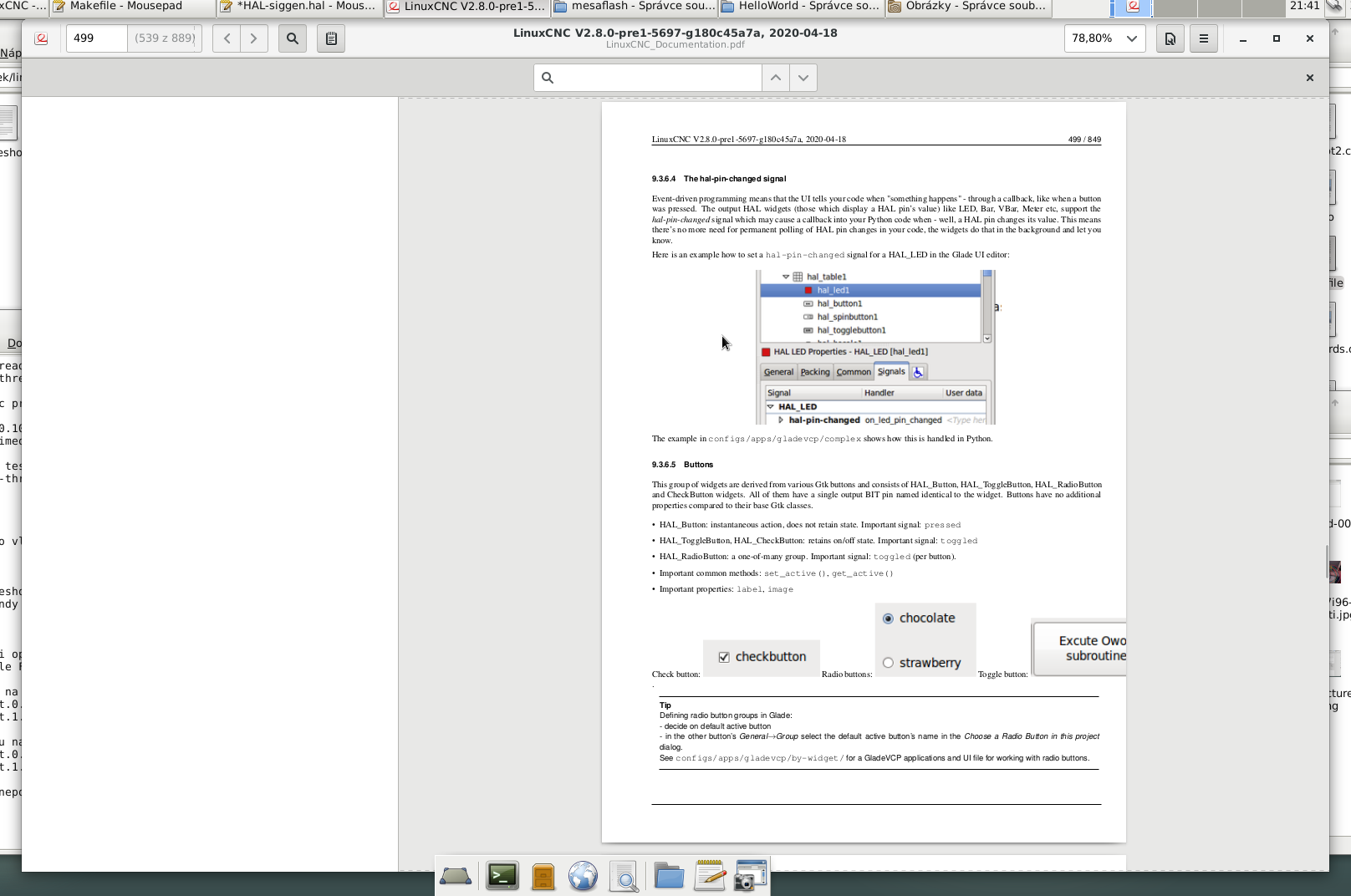

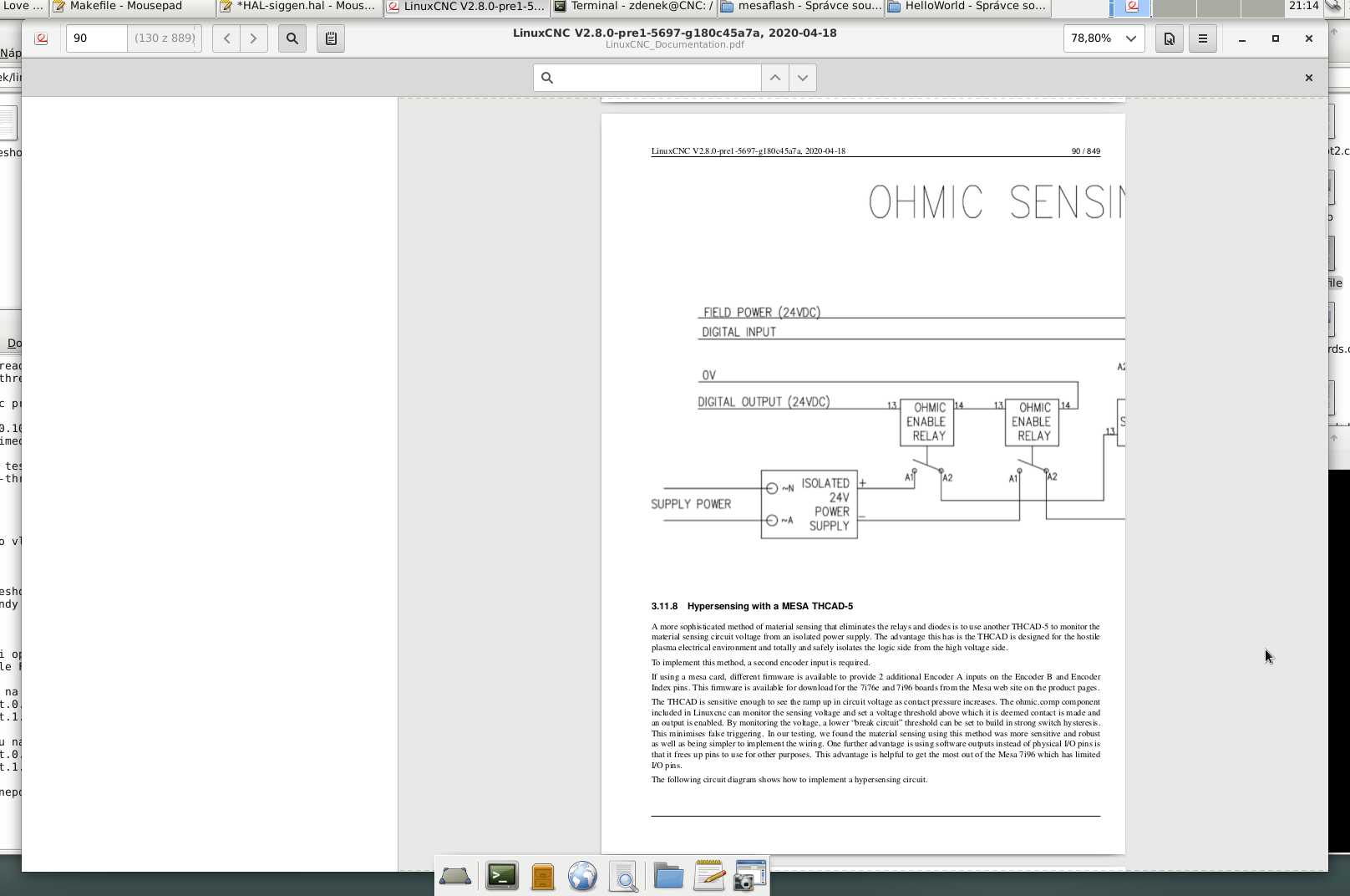

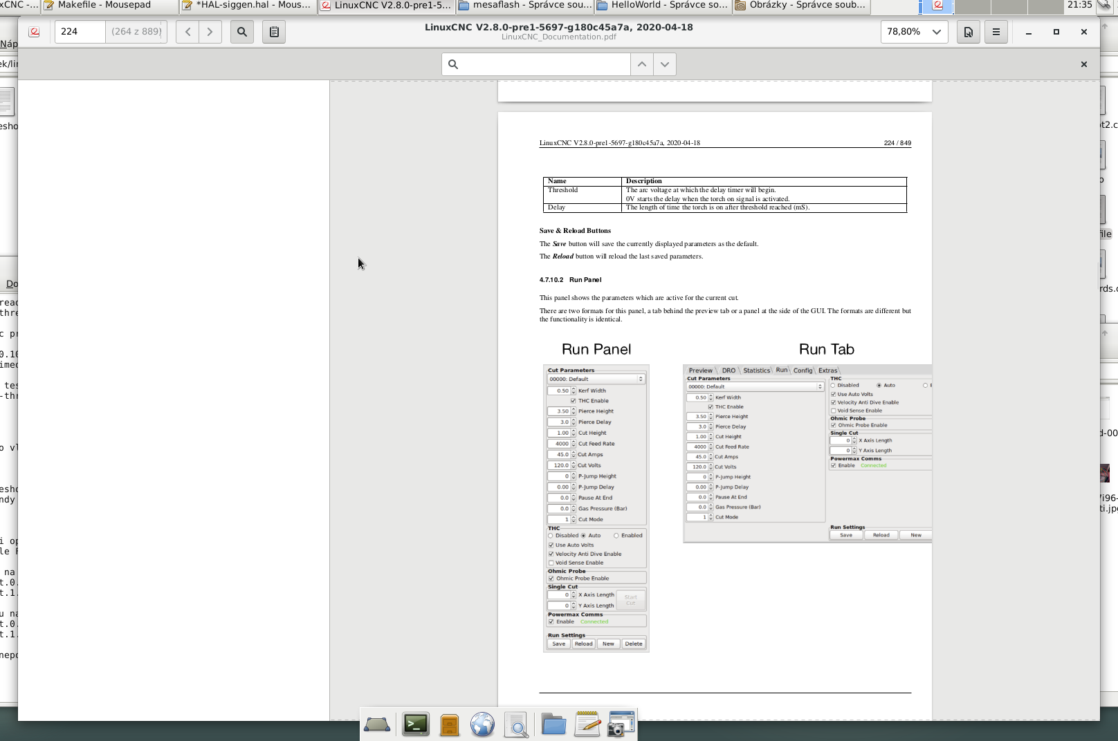

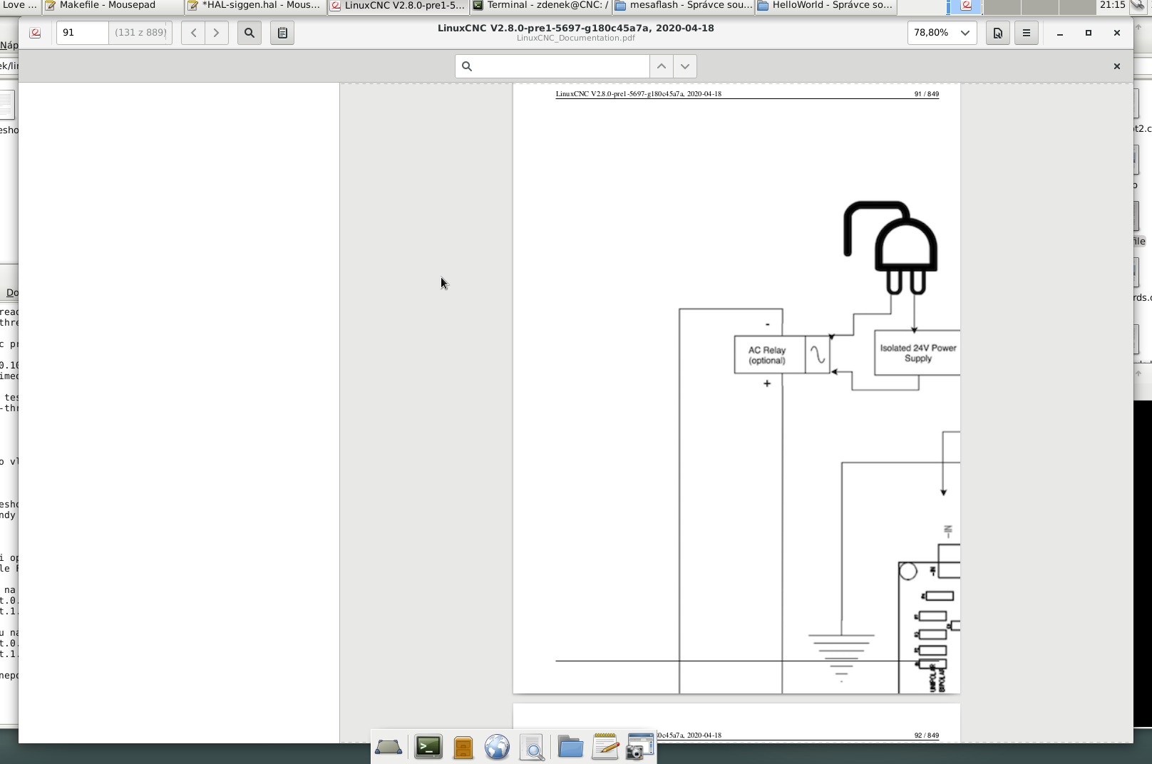

Yep, that is strange. It must have something to do with the PDF document build, they are correct in the HTML docs.
linuxcnc.org/docs/2.8/html/plasma/plasma...r.html#ohmic-sensing
linuxcnc.org/docs/2.8/html/plasma/plasma..._with_a_mesa_thcad_5
linuxcnc.org/docs/2.8/html/plasma/plasma...guide.html#run-panel
linuxcnc.org/docs/2.8/html/gui/gladevcp....l-pin-changed-signal
