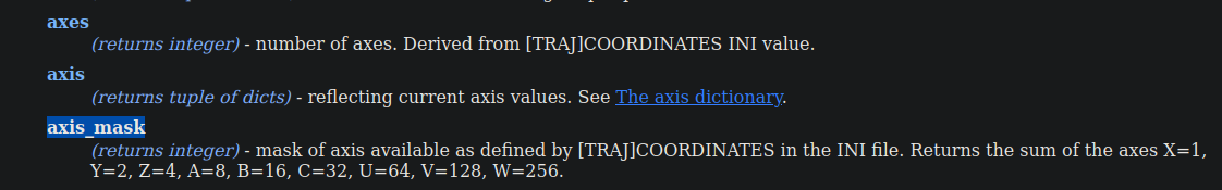

The 2.9 docs show a status
axes (returns integer) - number of axes. Derived from [TRAJ]COORDINATES INI value.
When I try and get the axes I get the following error:
s.poll()
s.axes
AttributeError: 'linuxcnc.stat' object has no attribute 'axes'. Did you mean: 'axis'?
I looked in src/emc/task/taskinf.cc and can't find stat->axes anywhere, so was this removed or is the documents wrong?

13 Dec 2023 14:21 - 13 Dec 2023 14:31 #288038 by Aciera
Replied by Aciera on topic LinuxCNC Python module
Try 'axis_mask'
[edit]
This will not only give you how many axes there are but actually which ones (ie XYZABCUVW)
But, yes the reference to 'axes' should be removed from the docs .

13 Dec 2023 14:33 #288041 by Aciera
He's referring to these:
Of which 'axes' has been removed.

13 Dec 2023 14:46 - 13 Dec 2023 15:28 #288044 by Aciera
I don't see why axes was removed as the [TRAJ] COORDINATES is still a valid and required ini entry.
Maybe because it was felt to be redundant information as 'axis_mask' actually gives you more information about the [TRAJ] COORDINATES entry.
The axis status gave you the number of axes without having to know new math... :(

13 Dec 2023 14:58 #288047 by Aciera
I have created a pull request to fix the documentation
github.com/LinuxCNC/linuxcnc/pull/2789
