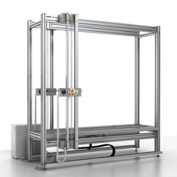

Some pictures of your machine would help. tommylight and I have both built hot wire foam machines.

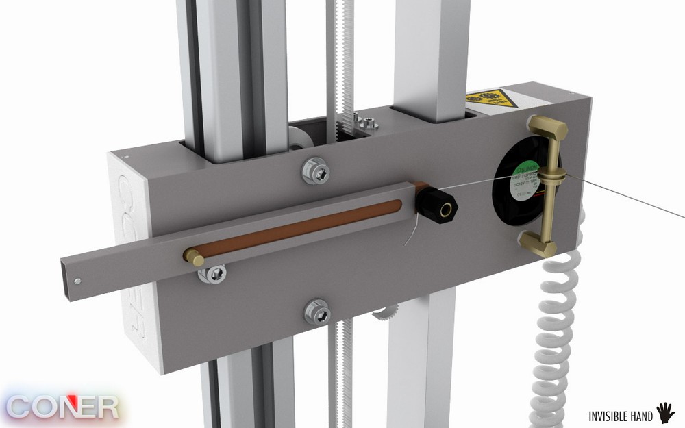

I am also attaching two photos from the manufacturer's website of my own now I don't have until the weekend I will be in the workshop.

I will admit I haven't herd of Kanthal wire before. From what I could find online it is an iron chromium aluminum
wire. I would have concerns with a wire that is heated and flexed repeatedly when it contains aluminum . That
would generally be a recipe for stress cracking. Hence why I like NiChrome wire. I would venture a guess that
the wire on your machine usually breaks at the pulley. Correct? At least if it's the same as the picture.

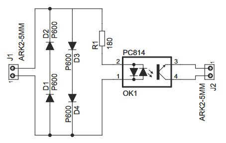

The sensor controls the flow of current through the wire, a simple electronic circuit that operates over a wide range of voltages and gives a low state at the output when the current flow disappears. See diagram.The connectors on the left side 1 and J1 are connected to the wire and the connectors 1 and J2 on the right side are the output.
