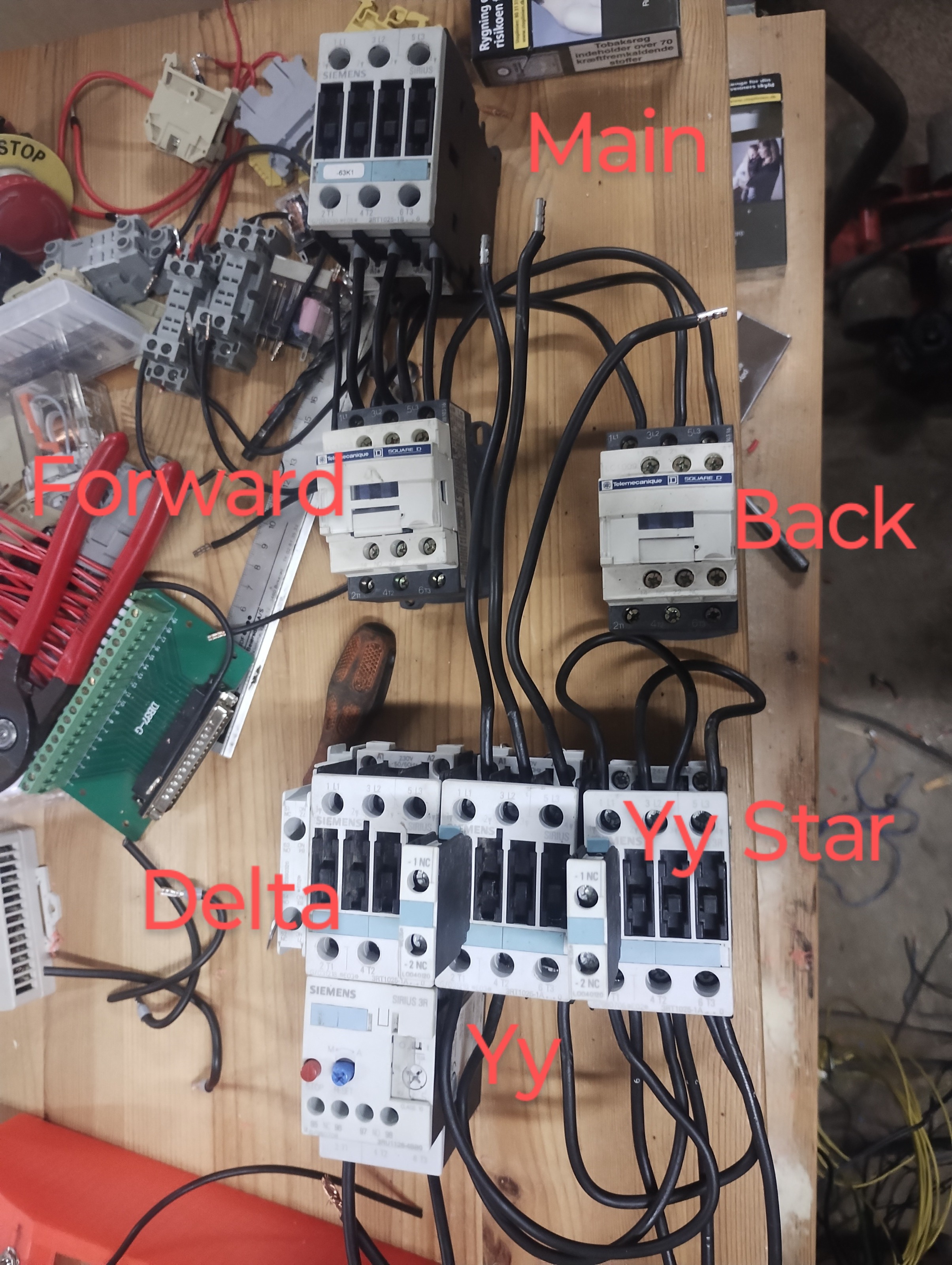

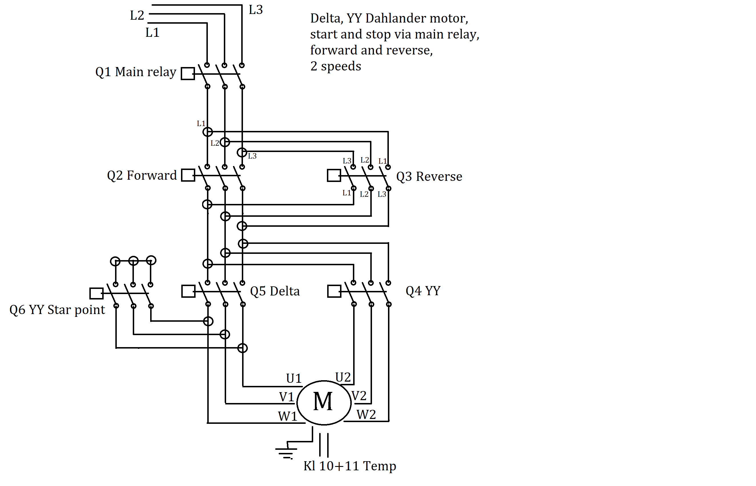

Hi all
I have made this diagram, but is there a smarter way to control this motor ?
I have all the parts on the shelf, but i think its a lot of relays just for a small 5kW spindel.
The motor is a 2 speed Dahlander motor. Running 400V 3 phase 50 Hz.
I have not drawed fuses and thermal relays on the diagram yet but know where to place them.

Replied by Aciera on topic Dahlander spindel motor starter with direction
Not sure I would bother with the 'Main' contactor.
