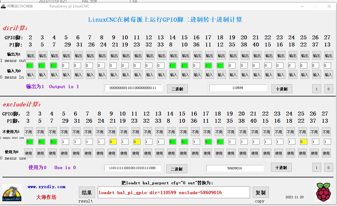

29 May 2024 03:02 #301722
Replied by Cant do this anymore bye all on topic Raspberry Pi GPIO Conversion CNC Software
hmm the attached zip file contains an exe file.

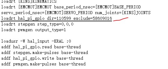

03 Jun 2024 13:39 #302241
by COFHAL
Replied by COFHAL on topic Raspberry Pi GPIO Conversion CNC Software
I think it is to calculate the GPIO values of the RPi, like the image in the first post.
