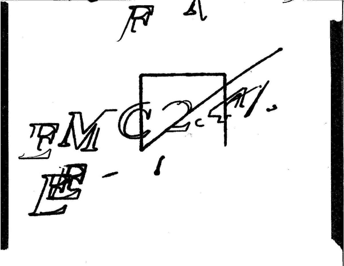

Background on my machine, it's a Milltronics knee mill, purchased with a dead controller. After much work I've finally gotten the machine working on all three axes. Got the 12 wire three phase spindle motor figured out by spinning it and plotting on a o'scope. Last night I went and ran the EMC nc program that default comes up on Axis. My results are attached. I have some issue in varying distance with a commanded move. I put a dial indicator on the x and moved in incremental mode, first positive .100, which I did 3 times, each time I got an additional .120 movement on the indicator, then I moved negative .100 and would get .130 each time in the negative direction. I did this a few times and the error% was not constant. I konw my encoder count/ballscrew/pulley ratio is right. I'm a bit confused as to what would cause the error to change based on direction. Is the 7i43 missing some encoder counts? The distance commanded is correct on the DRO on EMC. I'm using the pre-release v2.5 as I was told that would fix some setup issue I had way back when I couldn't get board communication. Is there any check done in EMC to see that there are the correct number of encoder counts per 1/rev on the encoder to ensure that counts weren't missed? Looking forward to getting this issue sorted out so I can cut some chips soon.

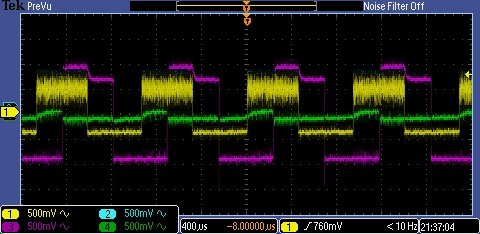

Alright, so tonight I checked the 7i33 board out, it is indeed setup for differential input. Then I put my scope on the A and B channels of the encoder. The scope was hooked up in the following way, all grounds common tied to 7i33 ground.
CH1: A+ connected to encoder and 7i33
CH2: A- connected to encoder and 7i33 (look closely for blue channel follows CH2 exactly)
CH3: B+ connected to encoder only
CH4: B- connected to encoder only
As you can see when the encoder is hooked up to the 7i33 board I get the weird almost TTL looking response from the encoder, yet when it's free (i.e. only connected to the encoder) it looks like a proper TTL signal. I originally hooked this up with the B side of the encoder hooked to the 7i33 and the encoder and it looked just like A. Anyone have any ideas? Just for grins I tried swapping the TTL/Differential input jumper on the 7i33 board thinking I interpreted it wrong, but the scope didn't show any difference.
-Scott

13 Oct 2011 02:58 - 13 Oct 2011 02:59 #13879
Replied by PCW on topic Re:EMC Logo not drawing correctly!
Is CH3: B- connected to encoder only supposed to be CH4: B- connected to encoder only
if so it looks to be open
Are you saying the A+ and A- signal are the same? if this is the case, this likely means that the A- lead is unconnected (and being driven through the differential termination resistor on the 7I33)
Both of these things taken together indicate that you really have a TTL encoder with the A- and B- wires unconnected at the encoder or you dont have the actual A- and B- pins connected correctly
For TTL, just connect the A+ and B+ (and perhaps Z+) encoder wires and jumper the 7I33 for TTL inputs

14 Oct 2011 11:54 #13909
by gtms_scott
Replied by gtms_scott on topic Re:EMC Logo not drawing correctly!
What I'm saying here is that the encoder looks like CH1/2 in the picture when measured in parallel to the 7i33, then it looks like CH3/4 when the encoder is measured w/out being connected to the 7i33 board. Maybe I'm barking up the wrong tree because EMC does read the encoders, I just wanted to verfiy that it was reading them correctly by comparing distance traveled according to EMC vs. # encoder counts. I guess I can ignore this weird error and do my test as I was just w/ the odd looking encoder signal.
-Scott

14 Oct 2011 16:19 #13921
Yes I understand, and what I am saying is those traces clearly
indicate a wiring or encoder type problem and you will not read
the encoders correctly until this is fixed.
The problem is that either your encoders are not differential
or that the /a and /b wires are not connected
