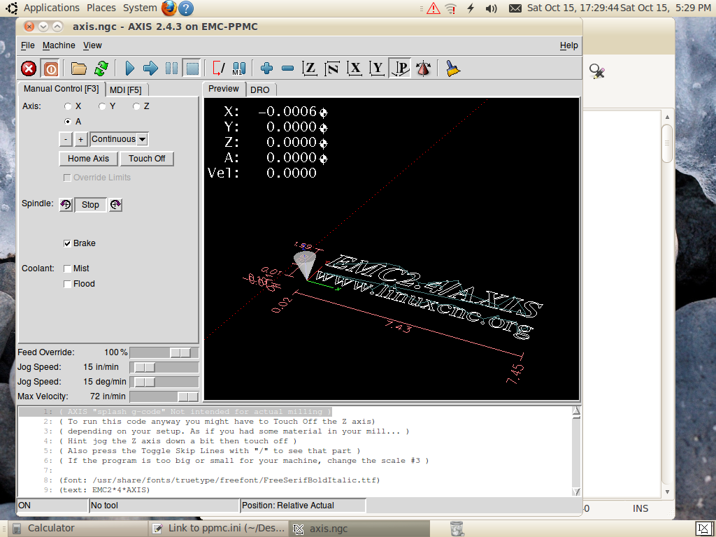

I am having problem configuring the PPMC.iNI in EMC2, My machine is a Sodick VMC, X,Y,Z motor are 1.5 KW with Servo Drive made by Delta AB series, 2500 pulse, 2000 RPM/ rev, 220 colts 3 phase.
Question # 1-
When I Launch the EMC, at bottom of right hand menu in EMN screen there is max speed, Jog rate and a Max Velocity. It shows me 72inch/minute. Where this 72 inch calculating. See the attached screen shot.
Question # 2 -
I can run the following program up to line #28 it goes to velocity 46/minute. As soon it highlights line # 28 it give me ' JOINT 0 errors following,' and stop the EMC.
It is running smooth till line # 27 with same feed rate. What is happening when EMC read line # 28? If I lower the velocity by dragging the velocity control button to 60% then same program runs ok. . Why I am getting joint error?

To change your max speed edit the
Of course these will only work if your machine is capable of the higher speeds you want to use.
Rick G
section of your ini file. Your current seting of 1.2 inch per second is 72 inch per minute (1.2 x60)MAX_VELOCITY = 1.2
The joint error is normally caused by an error between the commanded position and the actually position, try reducing your acceleration and or adjusting the FERROR.It is running smooth till line # 27 with same feed rate. What is happening when EMC read line # 28? If I lower the velocity by dragging the velocity control button to 60% then same program runs ok. . Why I am getting joint error?
