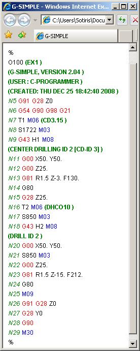

I have a couple of questions that I cannot seem to find answers for.
I am using GSimple as one of the Cad Cam systems, when I compose my G code and send it to EMC2 , I get this error message, Near line 2 named parameter is not terminated. The following is the first five lines of code.
# GSIMPLE SCRIPT FILE
# www.gsimple.eu
$66 2.05
$65 0 INFO
$127 INCH

The first question is what post processor are you using? That doesn't resemble LinucCNC or any other G code at all that I've ever seen.

I uploaded the other file and, received a error message saying "near line 3 unknown control command in the O word. I got rid of the code in line 3 and the program would run.The code was compiled using a Haas Post Processor.
The following is the code:
1:
2 %
3 O1
4: (G-Simple Version 2.05)
As I said I removed O1 from line 3 and left it blank, I could then get the code to run.
The code executed flawlessly until I got to this area
381: N379 G03 X1. Y1. I0.1523 J0. F3.937
382: N380 G00 Z0.9843
383: N381 G28 Z0.9843
384: N382 T2 M06 (EM06FL4)
385: N383 S1114 M03
386: N384 G43 H2 M08
387: (FINISHING LEVEL 0)
388: N386 S1114 M03
390: N387 G00 Z0.9843
I then received another error message saying ( linear move on line 382 will exceed joint 2 negative limit) Why would a change in tooling give me this error message? Or am I looking at the wrong 382, going back through the code I have had a number of references to the same code as stated in line 382, " G00 Z0.9843" which refers to the retraction of the tool and have had no error messages. Have you folks any ideas?
Thanks Chipmunk

14 Mar 2012 09:57 #18594
by ArcEye
Replied by ArcEye on topic Re:Up loading G code into EMC2
Hi
The big problem with CAM to my mind, is that unless you could have written the code yourself by hand, but used CAM to save time, it is hard for you to spot and correct errors.
On such a small snippet of code, a definitive answer is impossible. We don't actually know what happened prior to this.
The line number Axis is referring to will certainly not be the one given that number in the code, but should be the one thus numbered in the axis code window.
If there is some way to do it, output code without the line numbers, as they are not used by LinuxCNC and just cause confusion.
The basic answer is that changing a tool, changes the current offsets to put the new tool tip in the same place as the old one, relative to the workpiece.
It does this by adding or subtracting the offset figure for that tool in your tool table.
Unless your tool table is set up properly and all the other items mentioned are done properly, it could simply be that the code processor thinks you are moving to a co-ordinate outside your axes limits.
I would strongly suggest that you forget CAM for now.
Read
linuxcnc.org/docs/2.5/html/gcode/coordinates.html
linuxcnc.org/docs/2.5/html/gcode/tool_compensation.html
and get homing, touching off and setting the tool table sorted.
Then write a simple program by hand which moves to a set position on the workpiece, then returns to home , changes tools and returns to the workpiece at the same position.
Once you have this cracked and have ensured that your tool offsets are the same in your CAM setup, you should be able to use CAM again.

Also, you might want to try a generic Fanuc post processor if they don't have one for EMC.

Are you hooked up to a real machine now or experimenting with the software?
If just experimenting to start out try some simple programs, perhaps ones that do not require tool changes.
A tool offset could in fact cause the machine to have to travel out of range, so check your tool table is correct or again try the program without tool changes.
As John pointed out try different post processors or post processor settings, some handle specific g-code differently than others, same for comments.
The fact that your program seemed to work with a simple delete of one line up to the tool change seems to indicate you are very close to success.
Once you find the right post processor or post processor settings it should work like a charm.
