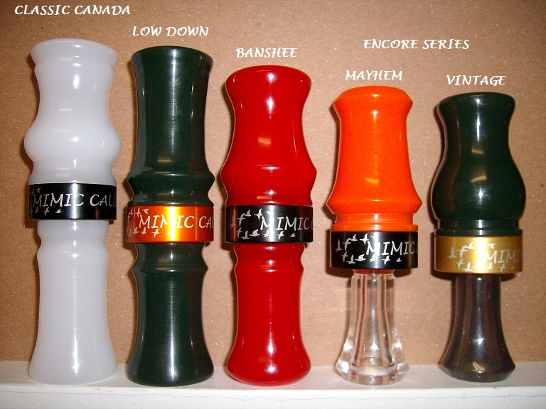

I own a small waterfowl call company and have been hand turning for years. I recently purchased a sherline 4400 cnc lathe with the computer loaded with EMC2. I have read the G Code How tos it came with and......wow I'm lost. So I attempted to download a couple of cad/cam programs thinking that drawing my call parts might be easier, then translating into gcode. I'm so lost. Any help with literature for beginners would be appreciated. It seems as though everything I read goes way more indepth than I need to worry with. All I need to know is how to shape the ooutside and do some simple boring on the inside.

For free-form shapes like this, you really DO want some kind of program to create the G-code
files. Straight lines can be coded up fairly easily by hand, but curves are much harder.
First, you need a CAD program that can accept input in the form you are comfortable
with. Preferably, this CAD program would be able to produce G-code directly, then you
don't have to worry over compatibility between the CAD and the CAM program.
There are separate CAM programs, but these add another level of complexity.
There are a huge number of CAD packages, and now a fair number of low-cost
CAM programs as well. Most of these CAM packages can produce G-code
compatible with LinuxCNC.

With a lathe the profile is going to be cut with G1, G2 or G3 so that is not much to learn. The first place I would start is to upgrade to 2.5 then install ngcgui, there are subroutines that can do 95% of general lathe work without touching G code once set up. As for the profile cuts I would program them by hand as that will be a lot faster than learning a CAM program and trying to get any meaningful code out of them.
Do you have a drawing of a profile? There are DXF to G code converters out there but it is pretty straight forward to write g code with a drawing and some dimensions from the drawing.
The one gotcha on a normal lathe with front tools is arc direction and tool compensation is opposite what you might assume it would be. You don't look down from the top for which side is which but rather lay on the floor (the positive end of the imaginary Y axis) and look up.
