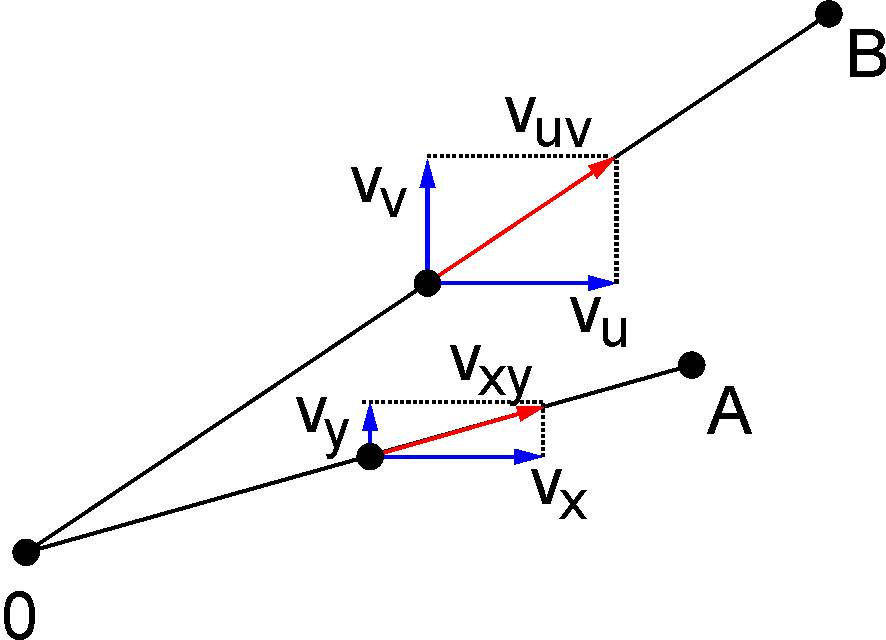

OK, please look at the picture. I have 4 linear axis xy and uv. Both axis pairs start from 0 and xy moves to A and uv moves to B At the same time they hit A and B. now What is the feed rate? is it computed in this manner : feed = sqrt(vx^2 + vy^2 + vu^2 +vz^2) ?
If yes this, then in this case the feed is not the relative tool speed in respect of work piece. If uv slow down, xy speed up. In a case both profiles uv and xy are the same the actual feed (wire speed) should by: setting_feed / sqrt(2). So if uv stops, xy move with setting _feed.
I'm thinking about this because: lets imagine: I've found the optimal cutting speed for the case both cutting contours xy and uv are equall. In a case no equall contours, if uv slow down xy can go above optimal speed and the foam doesn't manage to melt.

I don't think it is physically possible to have different lengths end up at the end point at the same time and travel the same speed.
John

The wire speed will vary along it's length. If your feed rate is 10 the longest move if possible will move at a feed rate of 10 and the short move will move at a speed so both moves end at the same time.
John

will complete at the same time. The only way that could be different is if that would cause
the U or V axis to exceed its individual maximum velocity, then the whole move would be slowed
down. This is a fairly fundamental part of the current trajectory planner design, although
there has been some discussion about relieving these limitations in a future version.
Jon

OK, the speed along wire I don't consider ,just speed off carriages (heads)...
Does this mean that the longer move will move at feed rate and the shorter one at lower speed regardless of which side move longer xy or uv?
So is there any setting that say these axis are in pair: xy and uv? because I can wire the axis such: xu an yv. and linux cnc don't know which axis are in pair.
I tried this code in mach with the results of xy side speed:
g00 x0 y0 a0 b0
f1000
1 g01 x50 y50 u20 v20
2 g01 x100 y100 //xy speed increased
3 g01 x150 y150 u70 v70 //xy speed decreased
4 g01 x200 y200 u250 v250 //xy speed decreased
If you notice the travel of xy side is the same in each movement (delta is 50), uv travel changes (delta is 1:20 2:0 3:50 4:180)
According You linuxcnc should perform movement 1 2 3 at constant speed of xy side at defined feed (uv side has shorter movement)
in movement 4 xy decrease speed and uv move at defined feed.
