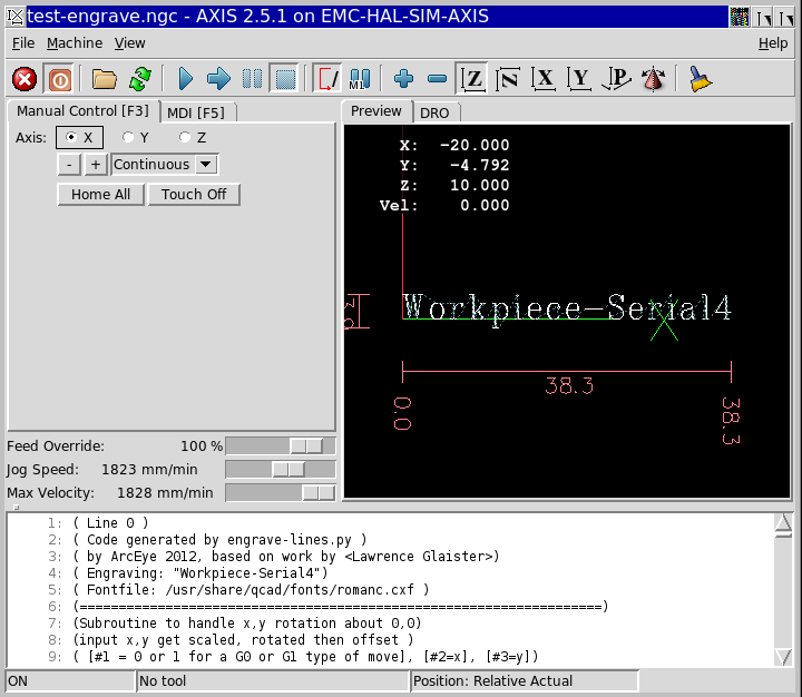

A while back I re-wrote Lawrence Glaisters engrave-11.py, to engrave multiple lines with optional indents etc.
wiki.linuxcnc.org/cgi-bin/wiki.pl?Simple...t_Engraving_Software
In the process I converted it into a command-line program. This makes it ripe for use with a script to generate the engraving code and output it to Axis
Below is an example bash script called serial-engrave, just relies upon a file called serial-num which holds the current serial number and is incremented at each use
It takes one command line parameter, which is the path of the file to output to and then load into Axis.

Another possibility, can never have too many choices!
#!/bin/bash
if [ ! $# -ge 1 ]; then
echo "Usage: serial-engrave filename"
exit 1
fi
value=$(</usr/local/conf/serial-num)
line="engrave-lines.py -S0.4 -s0.5 -0Workpiece-Serial$value"
load="axis-remote $1"
$line > $1
((value++))
echo $value > /usr/local/conf/serial-num
$load
exit 0
and the result is
regards

Hi
Yes it is possible, but you need to understand how potentially dangerous it could be.
The Axis hack below automatically runs any program which is loaded remotely, so does not affect normal file loads.
The code is a direct lift from the run_task() function lower down the file, but as it was not defined yet it was easier just to copy the code in.
It is at about line 1886 of axis (but my copy is already heavily hacked so that may be out)
This is most definitely not warranted fit for anything and may cause damage and/or injury if not used in carefully controlled circumstances.
You need to load the files by hand and run them normally to ensure that everything behaves as expected before attempting to use this to automate the program run.
regards

Hi Again
Have come to a more elegant and safer solution on the same lines.
I have added a --run / -R switch to axis-remote. This passes the command run_command to Axis which in turn runs the currently loaded file.
You can still run automatically via a script, it just requires a specific axis-remote --run command after the required file has been loaded.
Prevents any issues regards giving one command and getting two actions, which makes me happier with it
Axis hack is now
def remote (cmd,arg=""):
if cmd == "clear_live_plot":
commands.clear_live_plot()
return ""
if running():
return _("axis cannot accept remote command while running")
if cmd == "open_file_name":
commands.open_file_name(arg)
## Added
elif cmd == "run_command":
global program_start_line, program_start_line_last
program_start_line_last = program_start_line;
ensure_mode(linuxcnc.MODE_AUTO)
c.auto(linuxcnc.AUTO_RUN, program_start_line)
program_start_line = 0
t.tag_remove("ignored", "0.0", "end")
o.set_highlight_line(None)
elif cmd == "send_mdi_command":
commands.send_mdi_command(arg)
elif cmd == "reload_file":
commands.reload_file()
elif cmd == "destroy":
root_window.tk.call("destroy", ".")
return ""
and the modified copy of axis-remote is below
regards

wow !
people of this forum are fast !
today i did first steps in learning more about the background of emc2 and axis and ...and...and...gcode....
so i need some time to try all the solutions, but now i know that the project i hope to get as job, is possible to realize with emc2
my next step is to make a input-field for the text (axis-frontend) an generate from there the nc-program.
my questions:
how can i give the var's (like serial-number to engrave) from axis into my g-code as #1 or so? (stupid question for most, i know, but i search for one example)
how can i send a var (this my text) as parameter to a external program ?
thanks ! it makes fun to work here
my questions:
