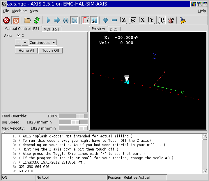

On a slightly different tack, still using Axis as a taster here is a set of altered files which make up a one axis simulator.
You can look at the changes made to just use 1 axis - simple stuff
Just put the folder in your ~/linuxcnc/configs folder and select at startup
regards
regards
