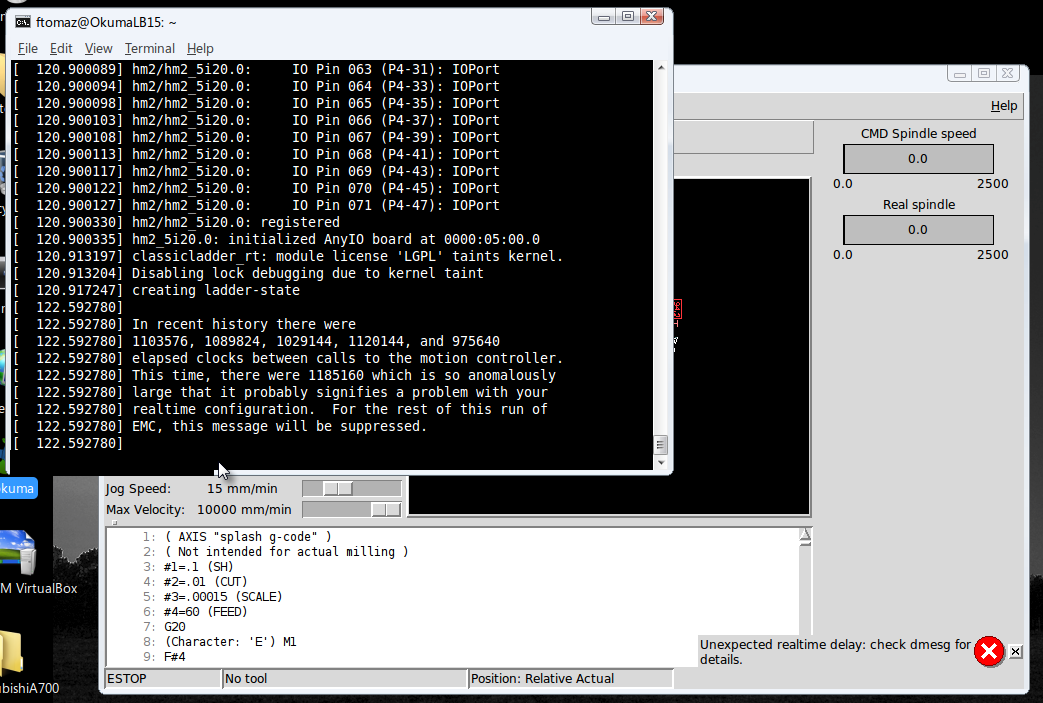

Unexpected real time delay
- jtc
- Posts: 229
- Thank you received: 13
07 May 2013 22:05 #33730
by jtc
Unexpected real time delay was created by jtc
- Posts: 19082
- Thank you received: 5266
07 May 2013 23:01 #33733
Replied by PCW on topic Unexpected real time delay
Have you run a latency test on the PC?
Just guessing from the numbers it looks like more than 200 usec of jitter

07 May 2013 23:59 #33739
by jtc
Replied by jtc on topic Unexpected real time delay
It will run latency test all nigth.
- Posts: 19082
08 May 2013 00:26 - 08 May 2013 00:54 #33740
With what result?
The latency test keeps a 'high water' mark of the worst jitter it has encountered
It is this 'result' that is important
You typically need to exercise the computer by copying large files,
launching firefox, moving windows around, playing flash videos etc
while the latency test is running, to catch things that my make latency
worse.

08 May 2013 14:50 - 08 May 2013 15:16 #33759
by jtc
Hi.
this is the result with load on the system (Asrock AD2700B-ITX), running "glxgears" mooving the windows, copy large files .
can the problem be because I haven't motors connected to the board, and linuxcnc waits for some kind of signal/feedback? what should I look for to solve this problem?
tnks
João
Hi.
tnks
João

08 May 2013 21:01 #33782
It is not likely to be related to LinuxCNCs I/O. The real time delay is measured at a
point before any LinuxCNC I/O is done (at the beginning of thread invocation)
Have you tried launching firefox or something that makes a beep?
sometimes these show problems.

10 May 2013 20:59 #33886
Replied by Todd Zuercher on topic Unexpected real time delay
I think Peter is just asking you to open something that would generate a sound.
Thinking that maybe this could point us towards what might be causing your latency spikes.
