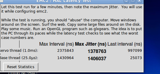

Back to the latency test, run for extended time and lets us know what it is.
You need to get a decent number and you can use that in Stepconfig to set the max speed your motors can run.

19 Jun 2013 06:49 #35798
by JayDeeTOL
Replied by JayDeeTOL on topic No movement?
Ok these are the numbers. I don't understand how to use them. Or I should say come up with the figure to type in the box.
