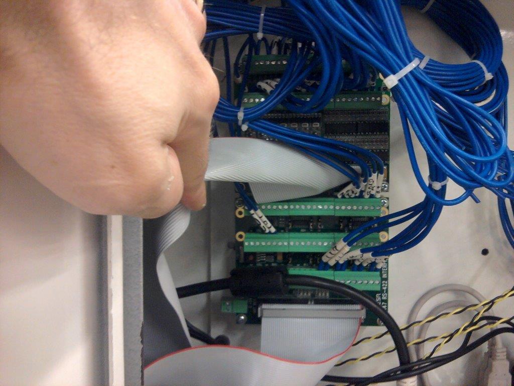

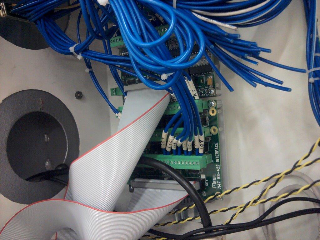

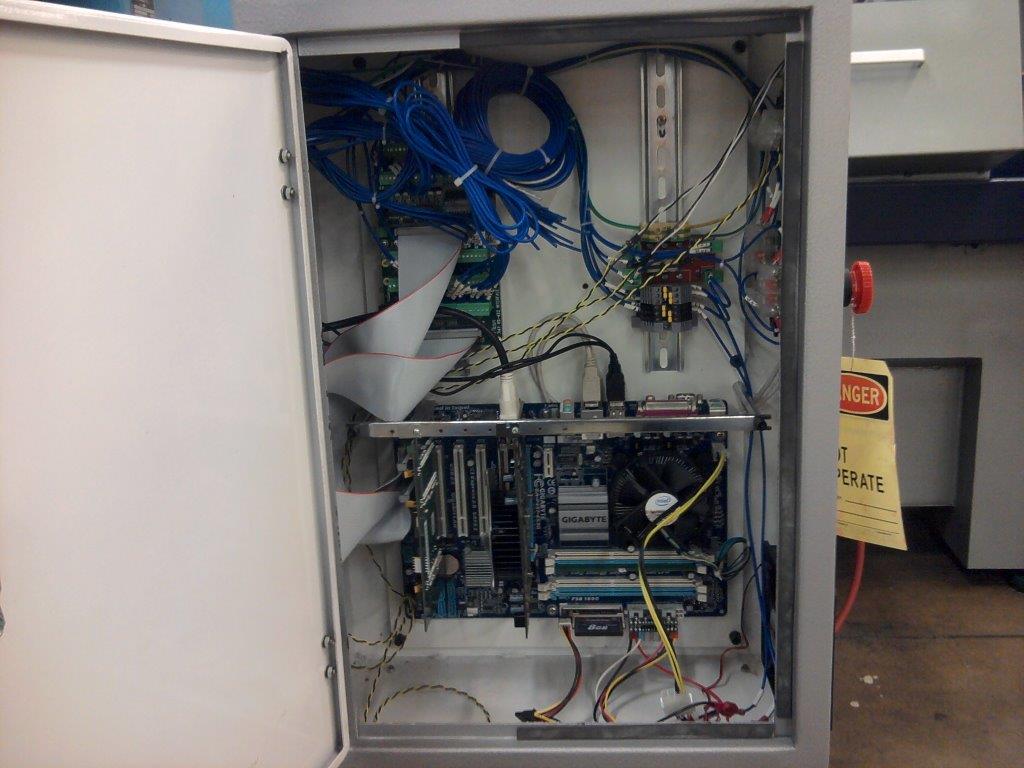

I do have another board. This is probably what I need. It's labeled "7147 RS-422 INTERFACE".
Pictures are a great idea. I've attached a few to help describe what I'm working with.

- Posts: 19082
- Thank you received: 5266
26 Jun 2013 00:34 #36045
Replied by PCW on topic Remote "Run" Button - Cycle Start
The 7I47 is intended as a differential input + differential output interface for encoder inputs and differential PWM or step/dir output type applications. Because of its differential inputs, the 7I47 is awkward to use for single ended signals like those from limit switches etc.
For 5V switches you probably want a 7I42TA daughtercard, for 12 or 24V switches and relay drive, you probably want a 7I37TA.
It is possible to use the differential inputs of the 7I47 as TTL I/O but it requires external resistors, so probably not worth the trouble

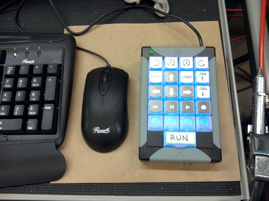

10 Jul 2013 04:52 #36469
by javabandit
Replied by javabandit on topic Remote "Run" Button - Cycle Start
Hey everyone!
I received my keypad in the mail yesterday, and after a little work, I have a really nice external "jog box" with a remote start button. I'm attaching a picture.
It was really pretty straightforward. I installed the software that comes with the device, and programmed the buttons using the hotkeys that LinuxCNC normally uses.
Thanks again for the help everyone.
