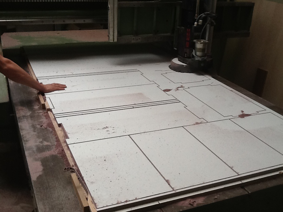

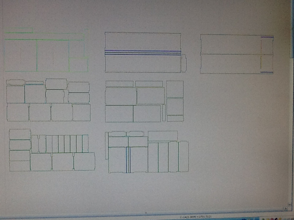

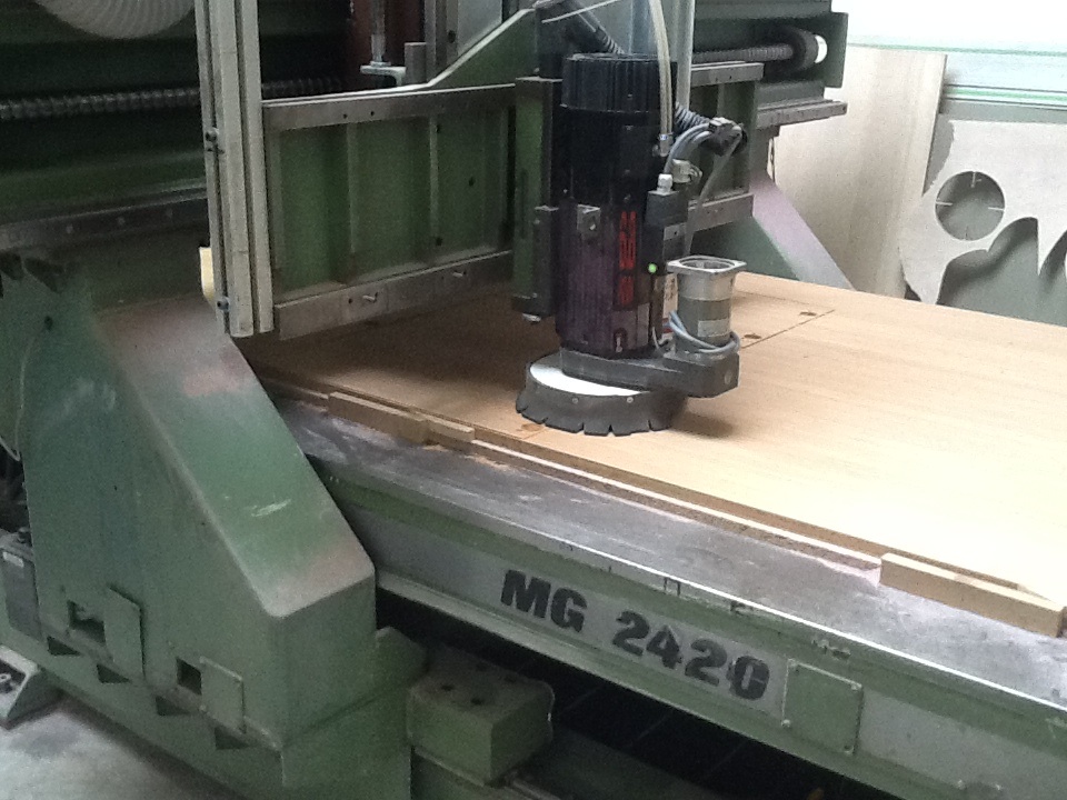

About the 1/4 negative bit, tow weeks ago i rent my shop to a wood worker in trouble of machine.
He came whith 10 board of MDF 18mm paint finish to nest kitchen carcass, he normaly cut whith a multicam 1000.
We route all the parts at 24000 rpm feed at 5 m/mn whith a 5mm negative single flute, and i have push it to 7.5 m/mn at the end.
We lost one piece on the job....'.... The finish on the bottom was acceptable and we trim the seen edge parts.
The dust was hardly compact between the parts, and until you keep some material on the four side of the main sheet, nothing can moove, like a puzzle.
The work shop in question use to make green furniture, and by shuting down his vac pump, he reduce the co2 bill and his electrical bill by the way.
I join a picture of the job we cut without vacuum pump.
