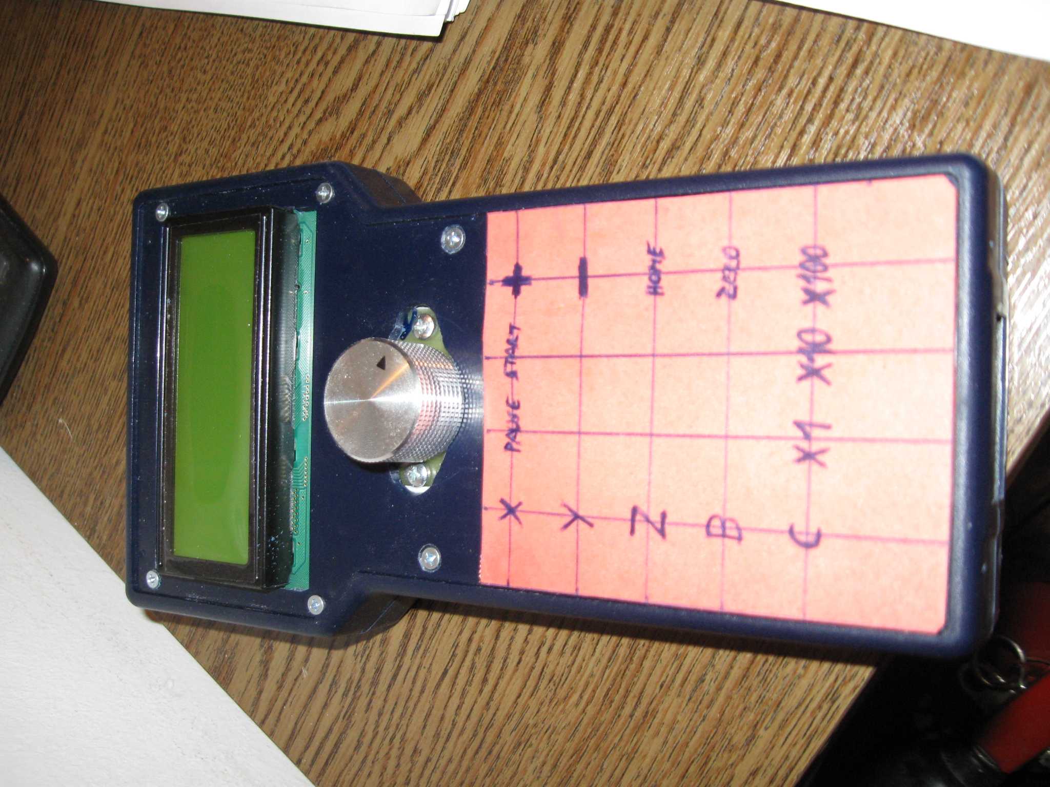

20 Aug 2013 18:35 #37880
by eslavko
For now with keyboard.
But the next thing is homemade pendant.
I just put together some old board's liing around and got something you see in picture.
It has 20 pushbuttons 5 leds in start of each key row one, 96 pulses/revolution encoder and 4x20 char LCD.
Now I need to write python userspace component for that. (this will be my 1'st python program
All thing goes in short packets over RS232 at 115200bps with CRC check. The python routine is responsible to send data to LCD so the data on LCD is simple configurable..
If thing will work as I expect I can post this as opensource/free project.
