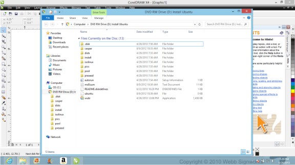

21 Aug 2013 01:24 - 21 Aug 2013 01:25 #37902
by 3Dsigns
Replied by 3Dsigns on topic Will Ubuntu/LinuxCNC work with Windows 8?
This is what shows up in the folder of the CD I burned from the ISO.....

21 Aug 2013 01:59 #37904
by ArcEye
Replied by ArcEye on topic Will Ubuntu/LinuxCNC work with Windows 8?
I can make out a folder called /isolinux so looks as though it has burned OK
Check BIOS has sata mode set to AHCI and then look at the
UEFI boot situation
UEFI boot situation
